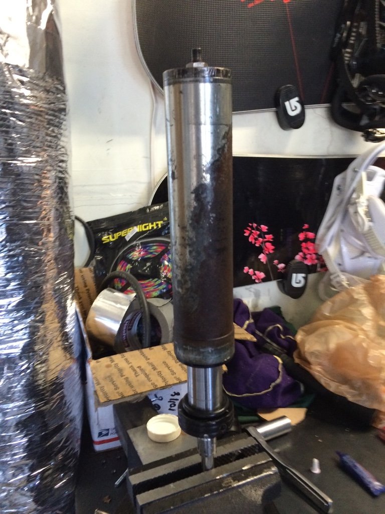

    In other news...did a little prep work on the truck including shortening my bumps. Huge pain in the ass. Took a 12" pipe wrench, 3 foot cheater bar, and a blowtorch to take them apart. Less than 2 year old Fox bumps. Their coating simply sucks by comparison. Wire wheeled the hell out of them and bathed them in anti-seize before putting it all back together.

    wow what is te deal with fox hock bodies rusting so bad???? youd think they would change their ways after so many complaints...
    why u shortening? wanting more up travel?

    Ehhh, still better than SAW. Bumps are harder to take care of (regardless of manufacture) because they are sleeved inside a can. I coated them with fluid film when I installed them, but still metal on metal contact with my winters and not a dry desert.
    Shortening them just shortens the stroke. Same amount of uptravel, but they don't touch the strike pads as soon.
    Since I added the extra leaf in the pack last year I've been fighting the rear shock tuning. It's still bucking more than I want, even after multiple bypass revalves and at only 70 psi in the bumps. So shortening them and increasing the nitrogen pressure and see what happens.
