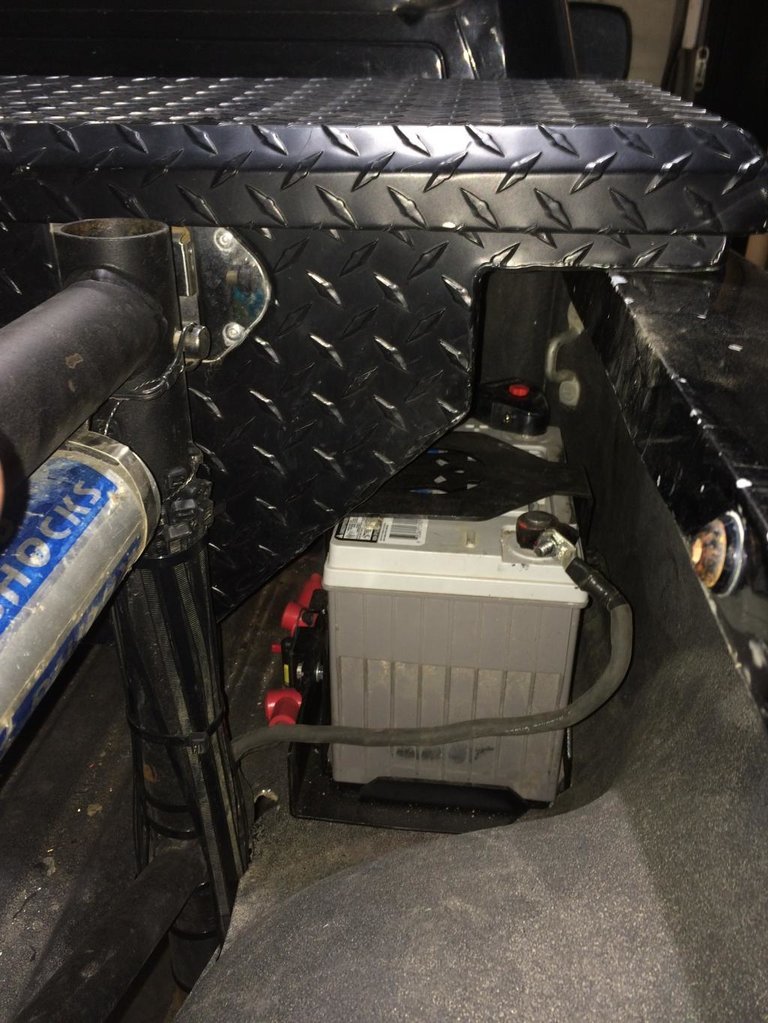

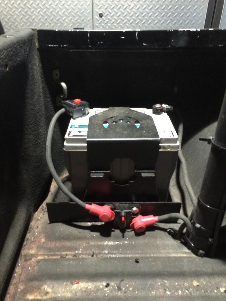

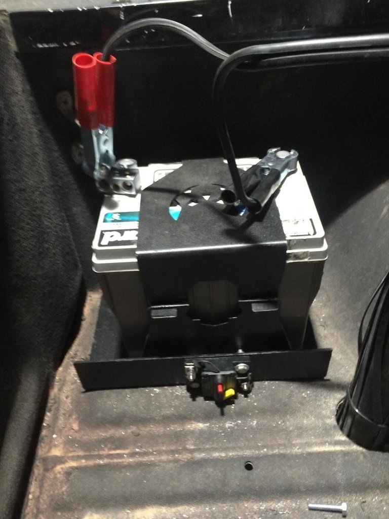

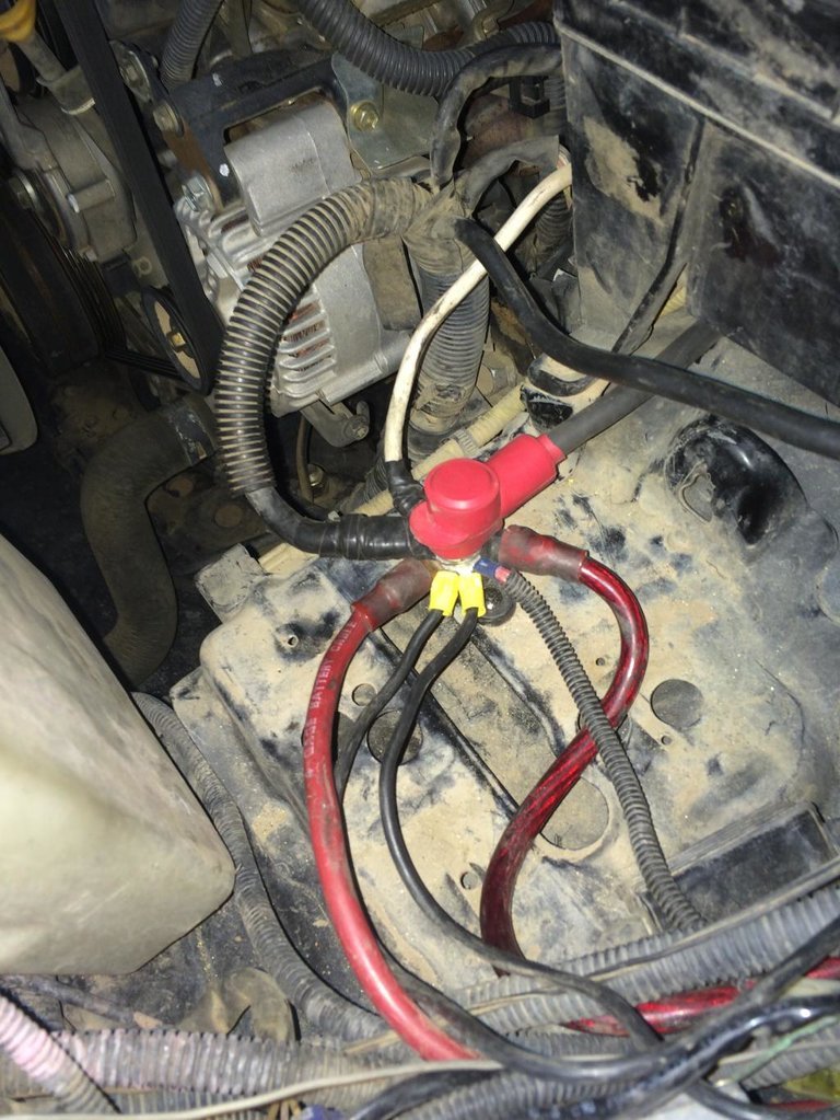

    Finally did a battery relocation. Core support and driver's side apron is bent to shit. Moved it to the bed under my toolbox on the passenger side.
    2 gauge wire for everything.
    Ballistic Fabrication battery box for the group 35 Die Hard Platinum
    Blue Sea circuit breaker
    Stud in factory battery location to retain all the factory wiring.

    ESB long travel kit, Deaver f67s with DTF 12 inch shackles.
    Nice!! i ordered all my stuff. i have 0 gauge wire and a breaker along with a kill switch ill be installing in the cab.
    i bought the ruffstuff battery box from landons recommendation. should have went ballistic since they are local

    Kill switch is pointless IMO if you are installing a breaker. The breaker should be located as close to the battery as possible before going through any sheetmetal. You can just click the breaker to disconnect it and kill power.
    The ruffstuff box is good. Don't regret it. I only got the Ballistic one because it was the only one I could find that fits the group 35.
    Also, I built some sammich plates between the sheet metal out of 12 gague to help distribute the weight in the bed better than just the box itself.

    did you add plate under the bed as well?
