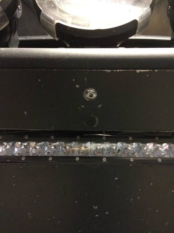

    Mini-mod. Picked up a camera for the front of the truck to help with crawling. Flush mounted it to the top skid plate and ran it to my head unit. It points at the ground perfectly as I approach obstacles.

    I'm not worried about it. It's aimed down and literally the size of a dime. If it cracks or breaks...another $18 isn't going to send me to the poor house.

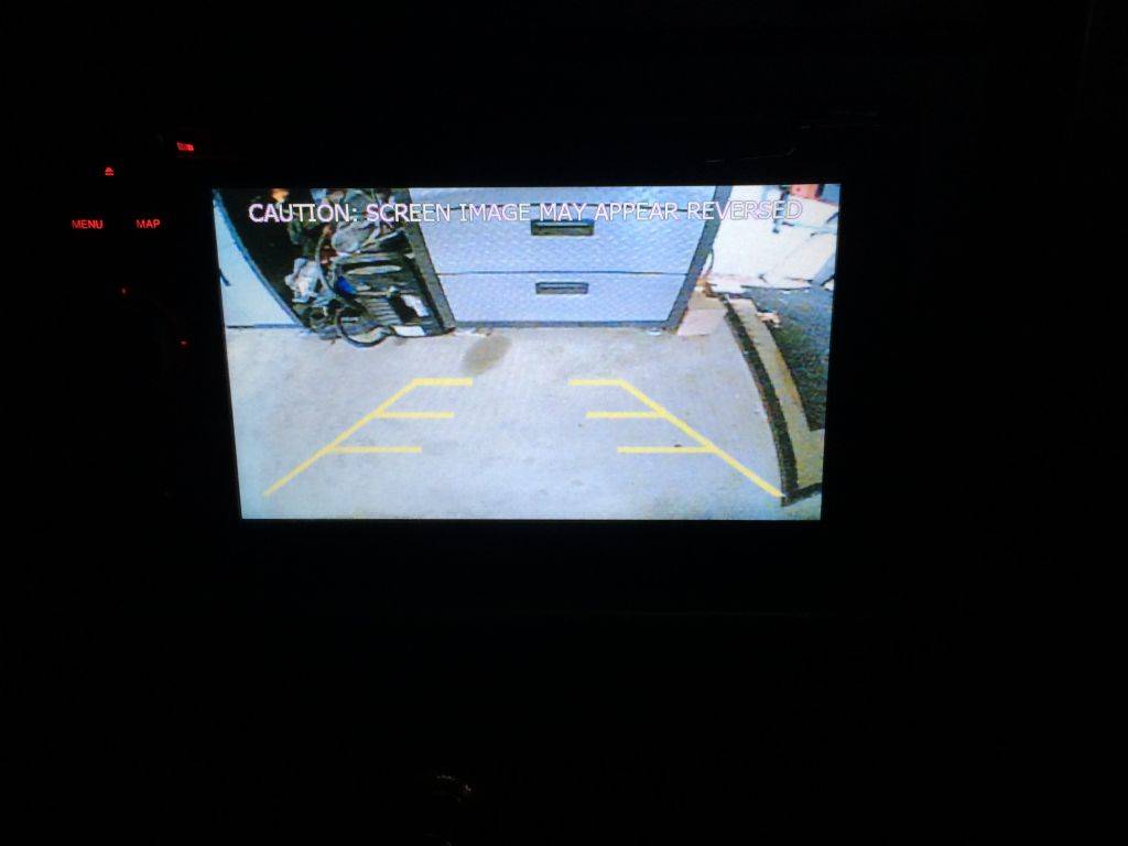

    Amazon special. Camera display can be forward or reversed and distance lines can be enabled or disabled. Comes with flush mount or hanging mount. Damn thing even came with a hole saw if you want to flush mount.

    Is your head unit designed to accept multiple cameras? I.E. front and back cameras.? Oh and thanks for the link I am now at least buying one camera.:D

    I can hook up a total of 3 video feeds to my head unit. One I use for my iphone (audio and video). It has a second audio/video feed that's unused. And it has a backup camera feed that I can flip on anytime by pushing a button on the HU as long as the camera is powered. I powered the camera when the ignition turns on so I can use it as long as the key is in the on position. I chose to use the backup camera feed because it doesn't turn off the audio of whatever I'm listening to. If I use the A/V feeds...I got no tunes...and we can't have that.
