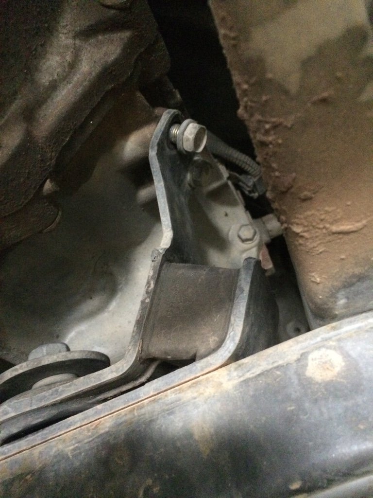

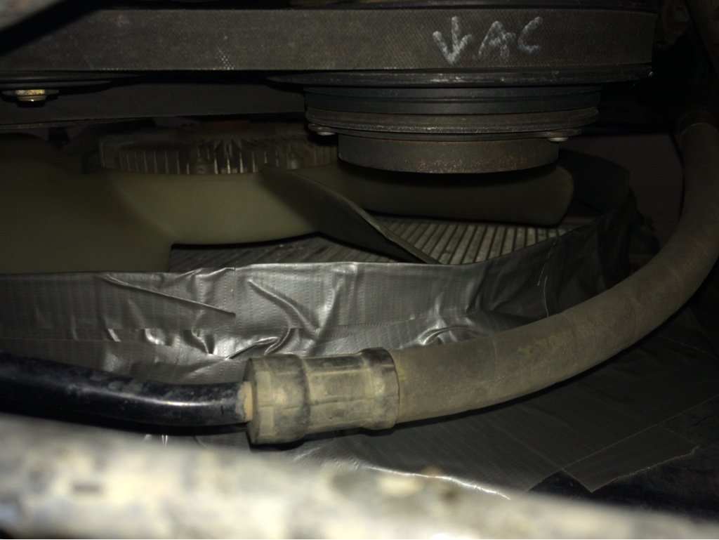

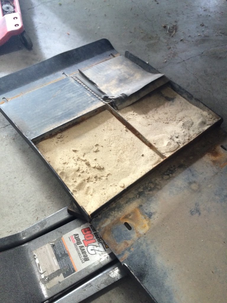

    God damn race truck. Dropped both skids to do more drunken flash lighting. The entire lower fan shroud is gone. Probably somewhere in the Mexicali desert. So I made a new one out of duct tape.
    Two rear bolts on the transmission mount walked loose. Passenger walked out a lot, driver side was just barely loose.
    And I'm working on making a sand box

    Looks like you need a couple drain holes in that skid, let that shit fall out
