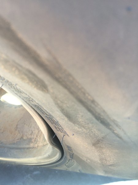

    It actually wasn't the tire. I bent/cracked one of the wheels. Must have done it earlier that day out on FIM. I noticed on the highway vibrations I didn't have before. Beating on it out in the dunes was allowing just enough pressure to escape from the bead as the tire was spinning. I sent a photo to @SCSPerformance of the wheel shenanigans and we've got something new up our sleeves :spy:
    Truck got beat pretty hard this year. Harder than any other year, so I've got a few things to fix. Cracked the skidplate under one of the gussets. Need to hammer that out and run the squirt gun over it. Also the coolant overflow popped out of its stupid bracket and pissed coolant all over the engine bay...and then the overflow bottle rested on one of the pulleys and wore a hole all the way through the size of a quarter. 4 coats of quick set JB weld and it's holding just fine. I'm not even gonna get a new one. Lastly...I've either got a vacuum leak or something fishy with the supercharger. I'm only boosting up to 4 psi.

    Oh yeah...the wheel carnage.
