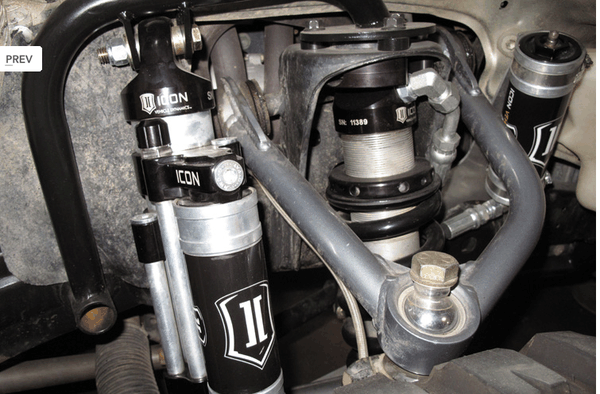

    Ok cool lol because I can't decide what I want to do,
    a mid travel like this, and keep the fenders,
    Or go full LT...

    Just a FYI, if you go the mid travel route and do the TC hoop/second shock, you lose your front sway bar. Not a bad thing for a trail rig but kinda sucks for a DD (which mine is). If money is no object, go LT! If you like to work on your own truck you can install a mid travel kit in a day by yourself and would only set you back $1500-$1900 depending on whether you get remote resi's or not. If your are not sold on TC UCAs, Camburg makes a set of UCA that are functionally equivalent but 200 bux cheaper.

    I already removed it :D and I love it!! Lol yeah I saw that they used the sway bar hole on the lca for the secondary mount.. And yes cost is
    a concern.. And I'd do the installation myself..
    Would just like to know how well a high performance front mid travel does...

    Well a single shock TC LT setup is going to cost ya ~4 grand not including fenders. My front setup cost less than half of that and I don't think switching to a LT will double my performance (but again...I have no comparison). That being said, of course I'd rather have the LT setup, but for me it just boils down to what you use your truck for and bang for buck.

    The second picture with the bypass shock is the Full LT from TC. The top pic with the smoothie is the midtravel.
    I don't know anything about Icon's shocks. I'm very happy with the King's though.
