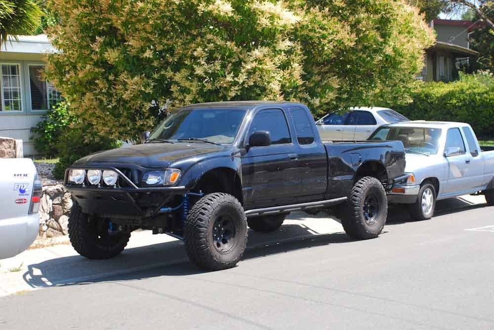

    My truck at mod day. Only mod she got was working on her tan. :cool:

    She's already black enough! All I can see is teef!
