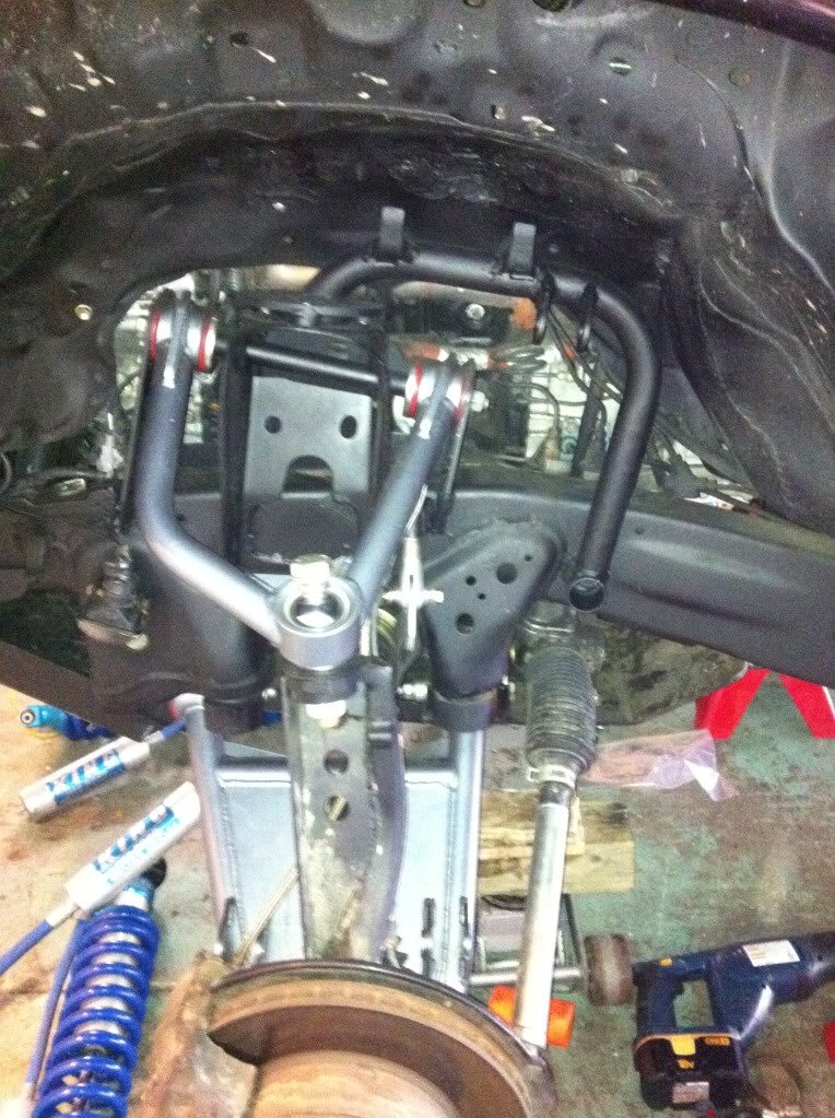

    It's on jackstands again. Went to retorque the suspension components after Hollister and did a good once over on the truck.
    Effing secondaries are still bottoming out on hard hits before the bumps stop the suspension from overtravel. I got pissed off and took a cutoff wheel to the truck last night. Cut off the shock tabs off the shock hoop and shortened them as much as I could. Notched them, changed the angle of dangle and rewelded the tabs back on.
    For anyone contemplating long travel, I hope you have tools (including a welder), patience, beer and an eclectic vocabulary. If not, you will very soon. Despite the kit being a mostly bolt in and DIY, it's the little shit that kills you. Having a shop do it doesn't omit you from the previous statement either. Giant did my entire rear suspension and I've had to fix several of their shortcomings.
    Drive it, break it, fix it, repeat.
    At some point I hope I can get two "drive its" done in a row.

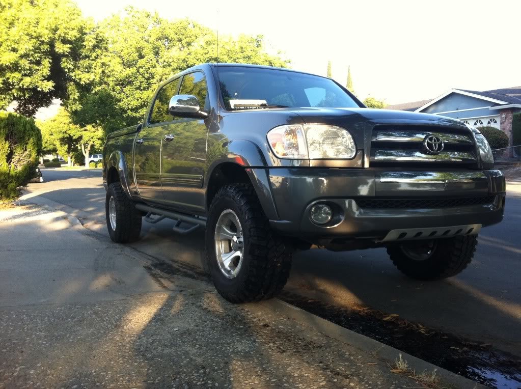

    It certainly is one of those things. Every time I drive the truck I love it. Whenever my truck is on stands I'm driving around in my tundra and I just can't wait to drive the damn taco again...until it breaks. I fixed the problem last night, but too late in the night to put it all back togeather. The tundra has been sitting for 2 weeks and was covered in dirt, bird shit, and spider webs.....

    Well, I got home and this is currently what my truck looks like.
    This is currently what the top shelf of the fridge looks like in the garage.
    I decided I didn't have enough energy to accomplish both.
    Still recovering from weekend frustration, so beer wins today.

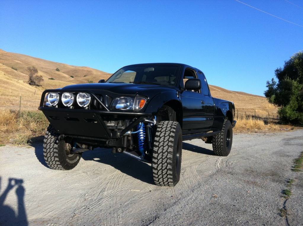

    It's got mad flex yo.....:cool:
