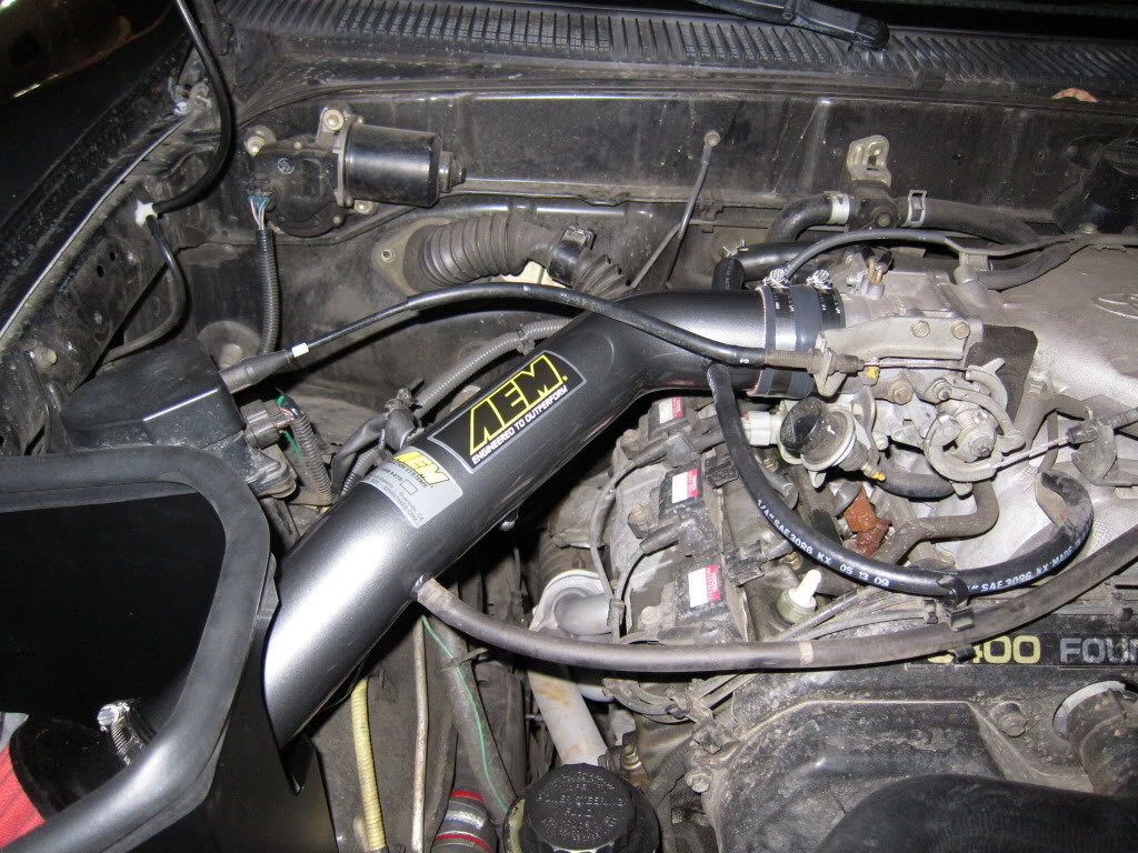

    What kind of aftermarket throttle body is that?

    Throttle body is stock. The TB design varies from year to year depending on options. The later model's came with a DBW TB instead of vacuum.

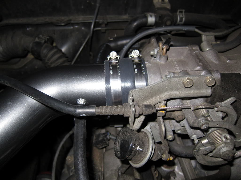

    Mine is an 01 and is totally different.. weird.

    The kit came with the Denso IK24's. Those are actually 3 steps cooler of a plug instead of 2 steps. General rule of thumb when it comes to forced induciton is for every 100 hp you add, step to 1 range cooler plug. To get the plugs to run hotter the gap can be increased. I ran the IK24's for a little while with the gap at the recomended .043". I ditched the IK24's for the IK22's with no modification to the gap.
    Did you at least bring a tissue?
    Yep that's a standard vacuum throttle body. The top two bungs with the caps on it were used for EGR vacuum modulator back when the 5vz had EGR.

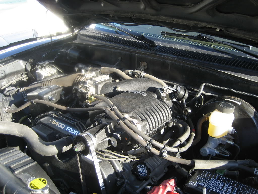

    Very nice build! :) How's that SC holding up?

    Pretty damn good considering the giant gulp of seawater it took. The nose pulley started leaking a tiny bit of oil after the little hydrolock ordeal. The fill hole is on the front of the s/c though so it makes it real easy to squirt new oil in. I check it every now and then. Automatic oil changer :anonymous:
