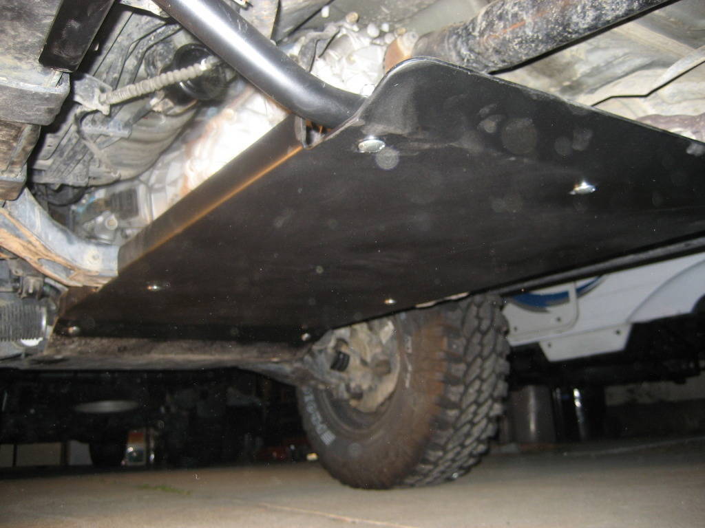

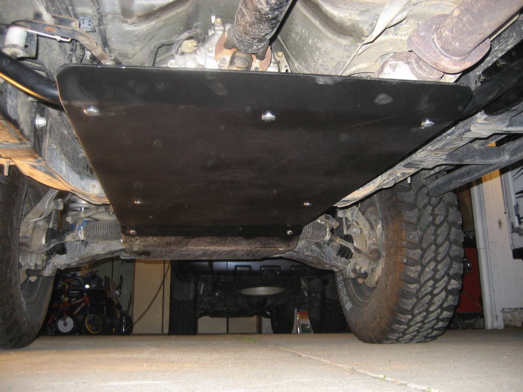

    BudBuilt bellypan and crossmember painted and installed. Just in time for Hollister.

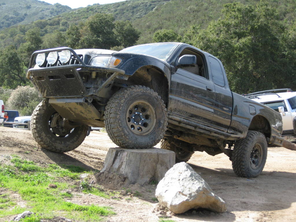

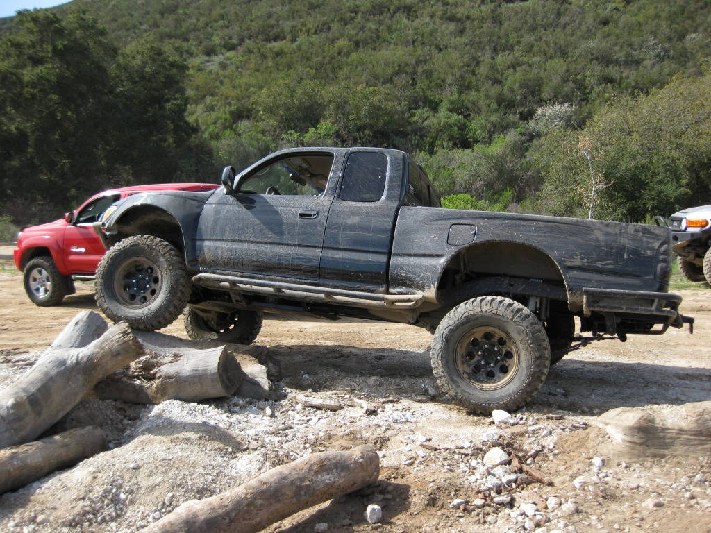

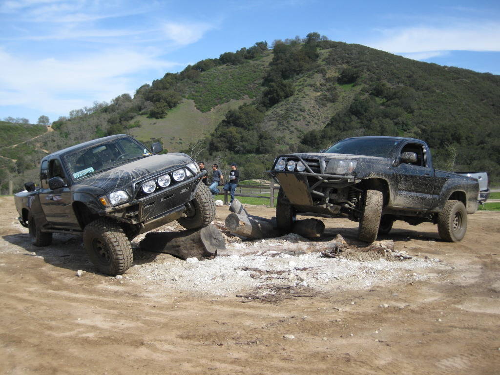

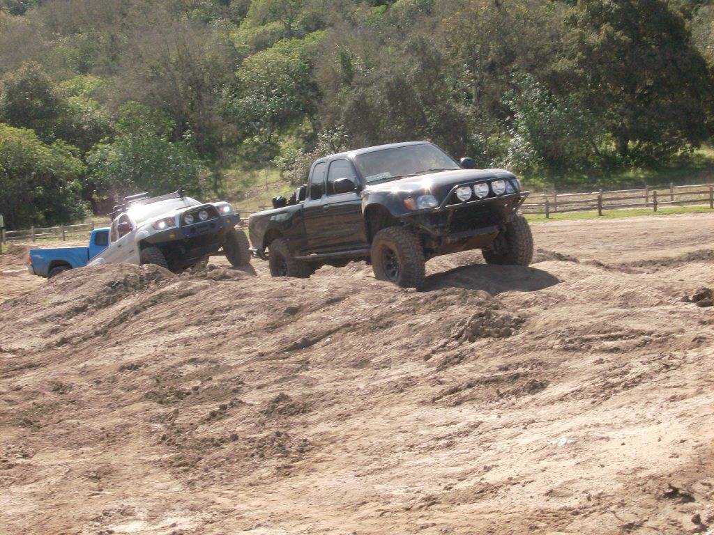

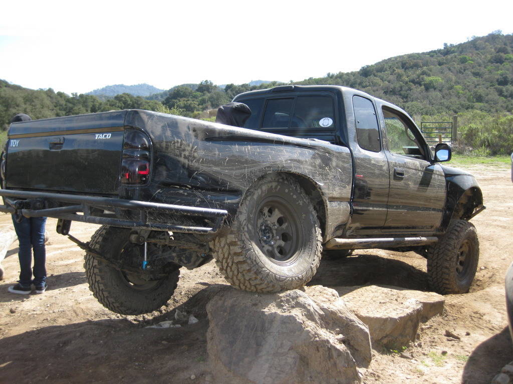

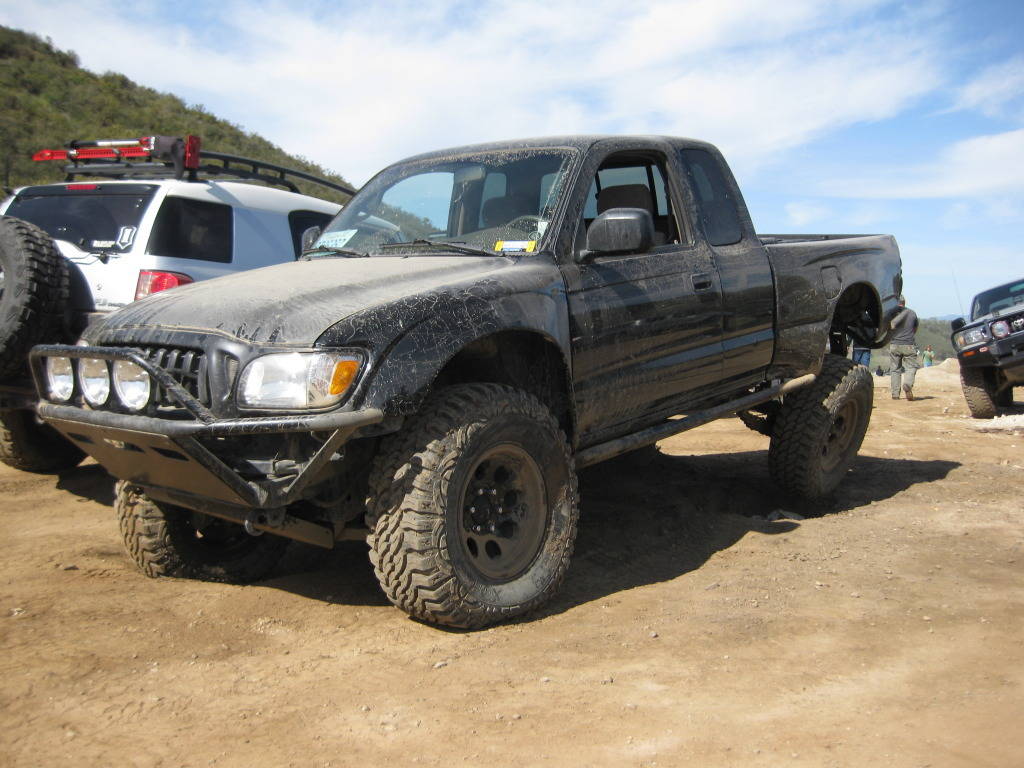

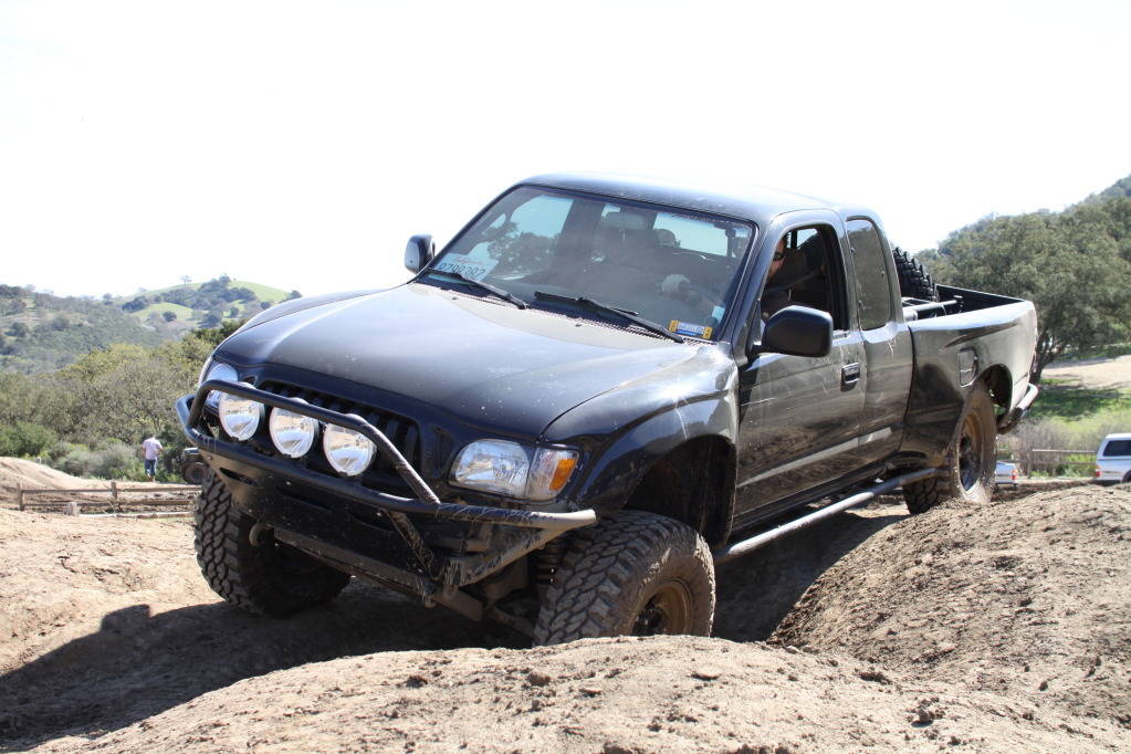

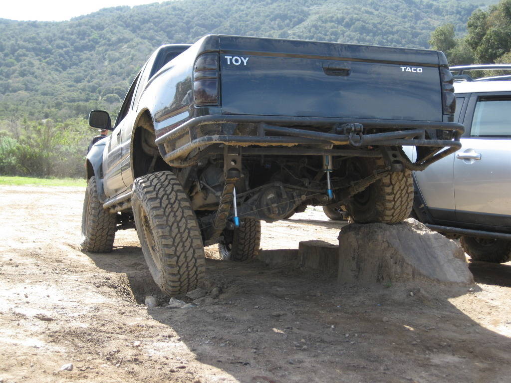

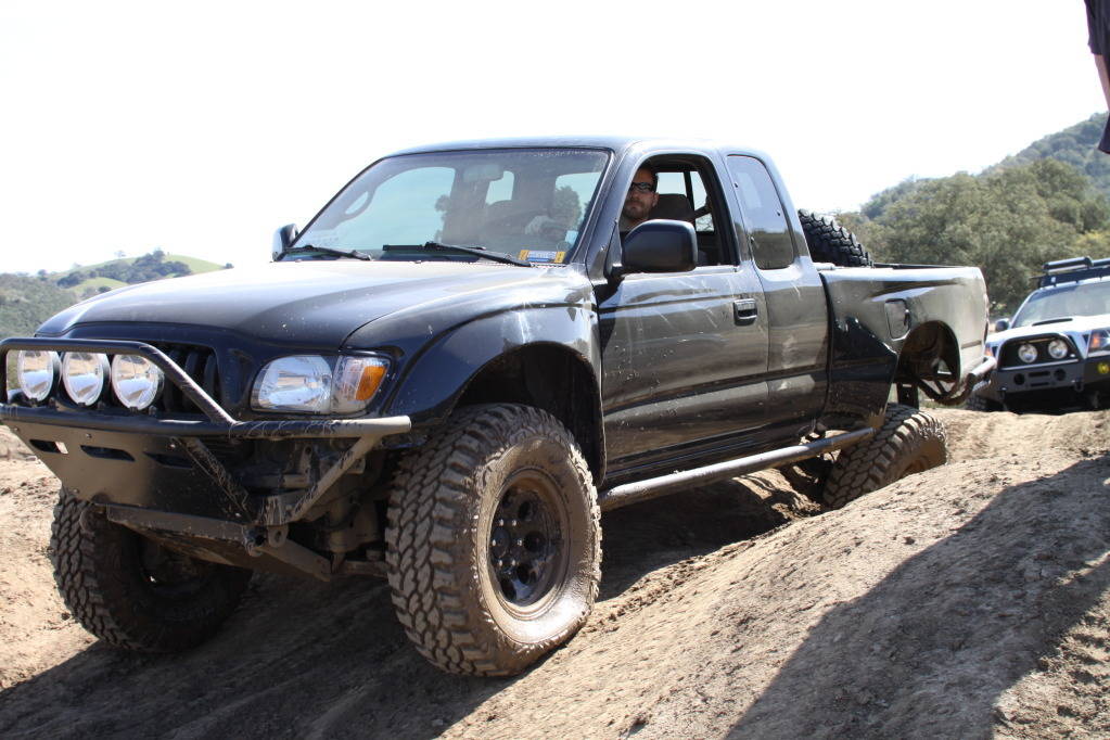

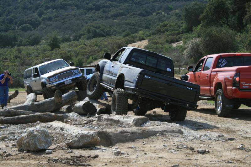

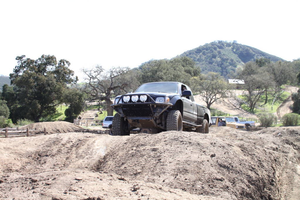

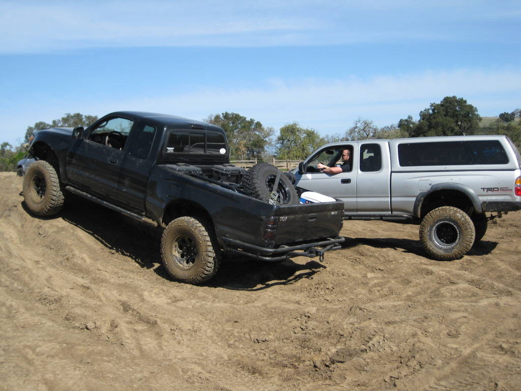

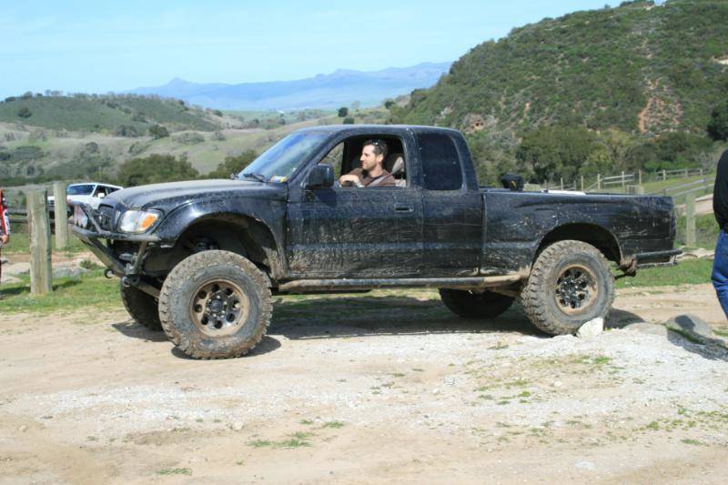

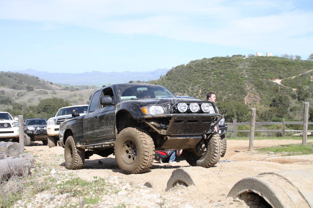

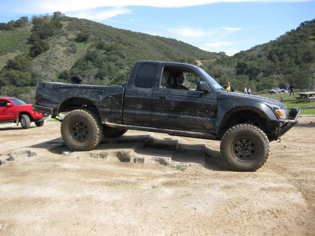

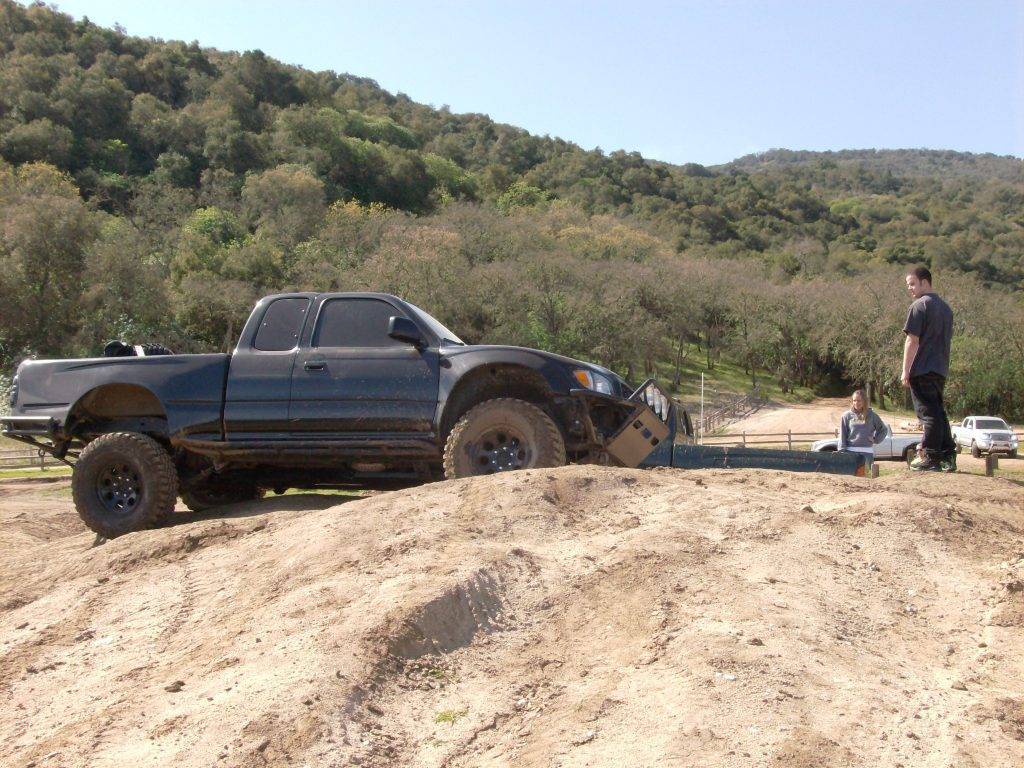

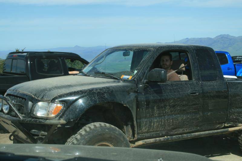

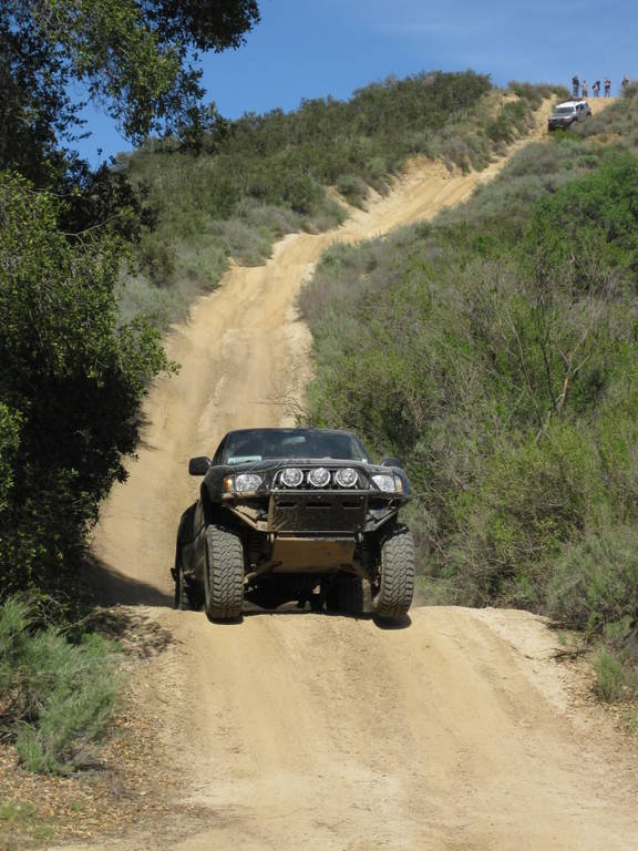

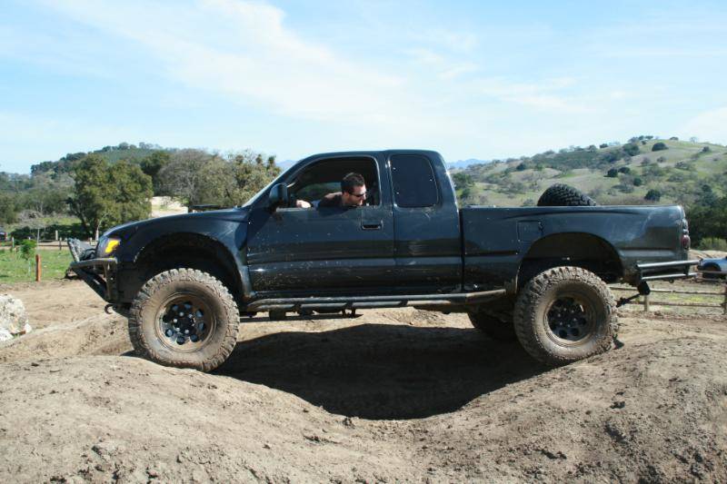

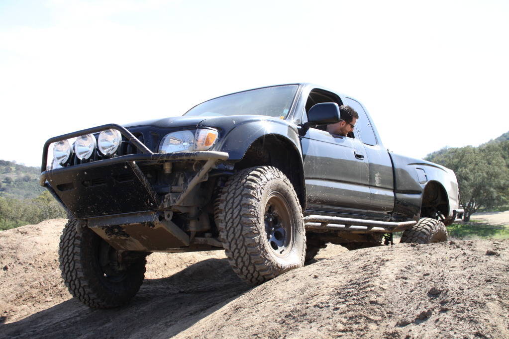

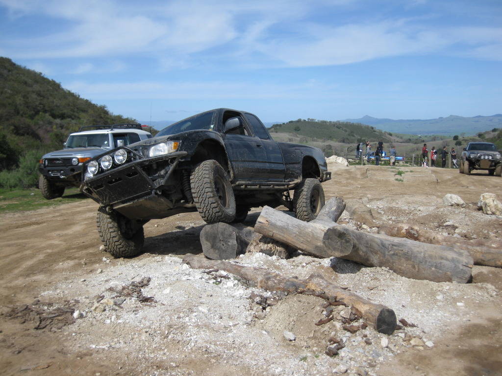

    Pix of my truck from the Norcal Hollister meet.

    nice dude, truck looks great!!!

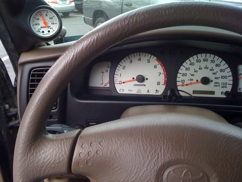

    Been kinda lazy as far as keeping this build thread up to date. I've done a few mini projects and got some stuff on the back burner, just haven't posted it.
    And now, the boost gauge. Not that I really needed one, it's just a nice to have. Autometer gauge pod and an Autometer Phantom Boost/Vacuum gauge. Matches the factory cluster quite nice.
