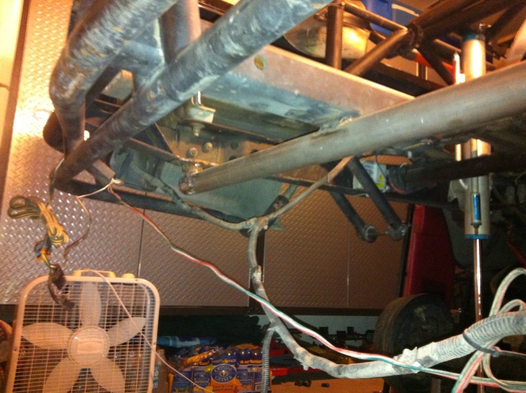

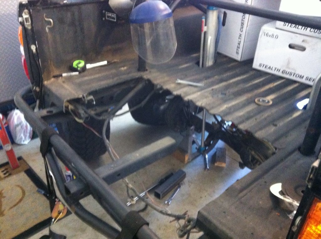

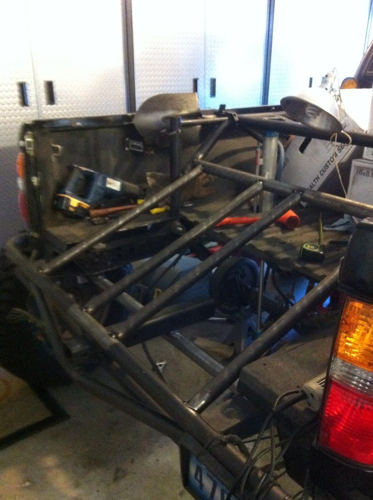

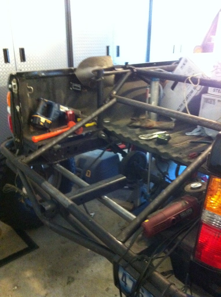

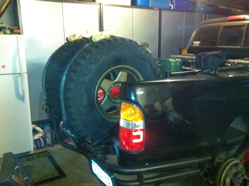

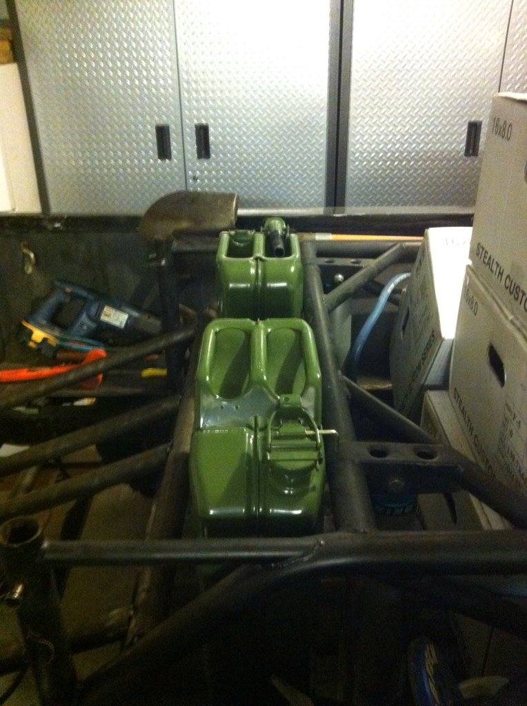

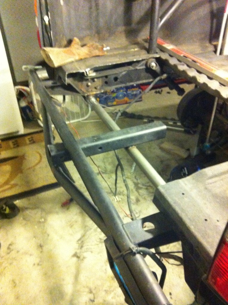

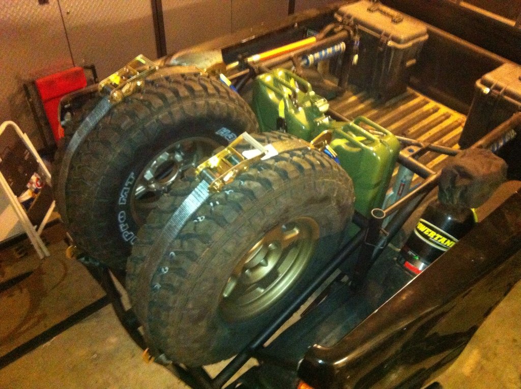

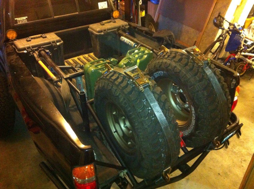

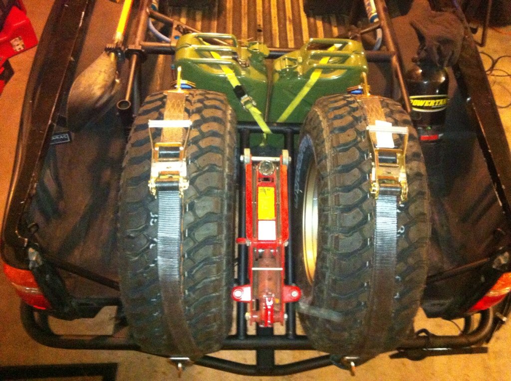

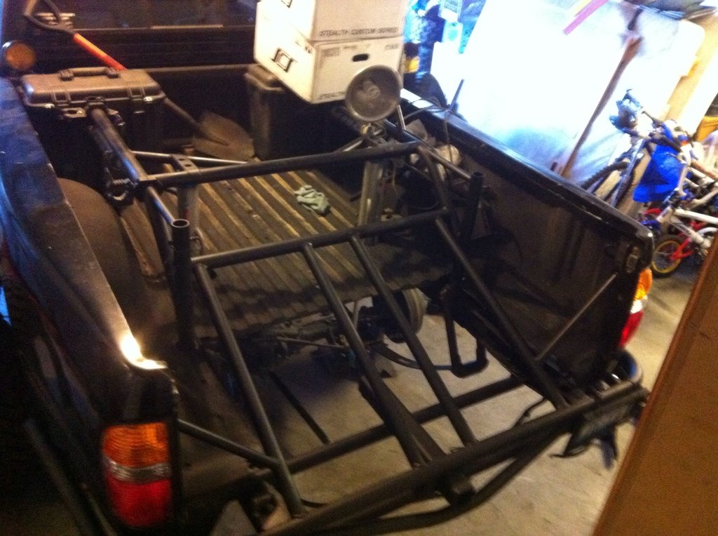

    Enough of the drama and shenanigans. Like I would really part out and sell my truck.
    Everybody knows damn well I'm not getting rid of it!! Although, we were on a "break" for a while, where I contemplated selling it off. Alas the stress dwindled and I came to my senses. Instead i took my frustration out on it with saws, grinders and a BFH.
    I'm still waiting for a LOT of parts to come in to get it back up in running again. In the meantime, I got to work on something I've been meaning to do for a while now. Dual spare setup. Pictures are worth more than words. I'll get some better pictures once I find my camera, for now iCrapCamera will have to do. :eek:
    You can figure out the story on your own. I utilized part of my existing rear bumper and bedcage and tied everything together with a couple new crossmembers. Everything is .120 wall DOM.
    The observant ones out there will notice some shiny...errrrr "matte," new wheels. Vin at SCS Performance really came though. I needed two new wheels for the spares, and the new wheels SCS came out with fit the bill much better than my old wheels. The new wheels are LEGIT. They have 1/2" more backspacing than my old wheels which brought them in a little tighter. I'm no longer scrubbing my the glass on the inside of my front fenders when I back up. They are both Toyota hub and lug centric. Even with my shit tires, they took very little weights to balance out. I got almost 7 full turns on regular acorn lug nuts on the front studs, and 11 full turns on the rear. Fit and finish is phenomenal. And I don't know who Vin paid off at the UPS store, but the brown truck delivered them to my door THE DAY AFTER I ordered them.
    HUGE props to Vin and SCS Performance
    D3BAE7FD-2AC4-4173-B468-F29C3F0AD752-878_e58849651e080dee6704b606b791e2146150b1f7.jpg
    A19CBA5D-4F32-4C8E-A1B2-80BC7A1175B4-482_54495caac03da58ebb17a47f6c44326fea7fc59f.jpg
    B63232E0-36BA-40D2-9B4E-4F69EC7D8A0D-482_8caebacbc12f13f3a1bc76c79ce3985d2e9663da.jpg
    9805F989-9F68-41FD-BBE4-9DD5D5142082-482_c0bf7ebd5fc68dca75fee0cf6ef50d86ebd47296.jpg
    A609B0ED-B743-4A41-B804-2F204FA7B10F-482_fe7adf438df632413c9e5e07c53adafac026b60c.jpg
    32795677-778C-4C33-AE8F-D61B8D1DAAB9-482_896df6e3ba3659d6d331ffe8828fbe03a90559f1.jpg
    5E19A825-CF33-4318-9236-E3C08168AA57-482_ceda3ea5260fd24c438d87f1f34bb82f6397b97d.jpg
    1C1E6C36-8B92-4B2F-A846-287C461C000B-482_47b6efd821f7439afe3fd1edba25fd6347b8868d.jpg
    3DF6CB43-A61C-4397-8736-953EFC73695D-482_ff35e25f1f86a61bc55ea0bdf776b0406fa22c7b.jpg
    30B31DEB-58C8-4E20-BE36-9FB12DA56558-482_3b1b7f34f47c5909e30634627682f74b1840943d.jpg
    87602F82-FDFE-4C39-9AF2-E4B4B16C00FA-482_da3852a41a98dac13e09a4b96a4a933334cdf56e.jpg
    The jack is only a prop. I've got a new HF jack coming in the mail that will sit where the red jack is. I'm also waiting on some anchors to weld to the cross member for the tire straps. But for now, the axle straps work good. I still got a lot more to do on the truck to get it running on it's own four wheels again, but off to a good start.
