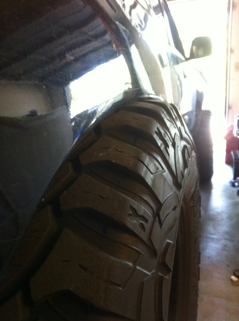

    Oh dude the ARB's are a shitstorm up here in cold weather season. They damn compressor just runs non stop until the diff gets warm. And it's just annoyances. That lil tiny ass air line is all that is stopping you from having a locked rear end or not. Your compressor dies, hole in the air line, someone farts in the wrong direction, and you're locker is done for.
    Selectable lockers have their place, don't get me wrong. ARB is definitely the better of the bunch. But I've seen ARB's blow into pieces doing the shit I do. The problem with diff work is it's a black box to me. I don't work on diffs...or transmissions, nor do I want to. I just want the damn thing to work with no effort.
    As for bedsides, the 50T pack goes negative arch before the deavers do. I'll be bumping about 3/4" lower than I was with the deavers. Between the lower bump and a liiiiiiiiitle bit of trimming on the glass, I should be fine. Tires will extend out past the fenders a little bit though :eek:
    This is a 65" WMS with a 4" BS rim. My new rims are 4.5" BS, so it should be pretty much the same

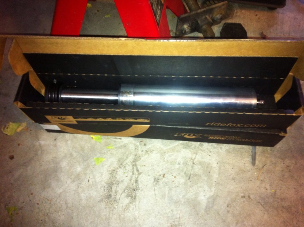

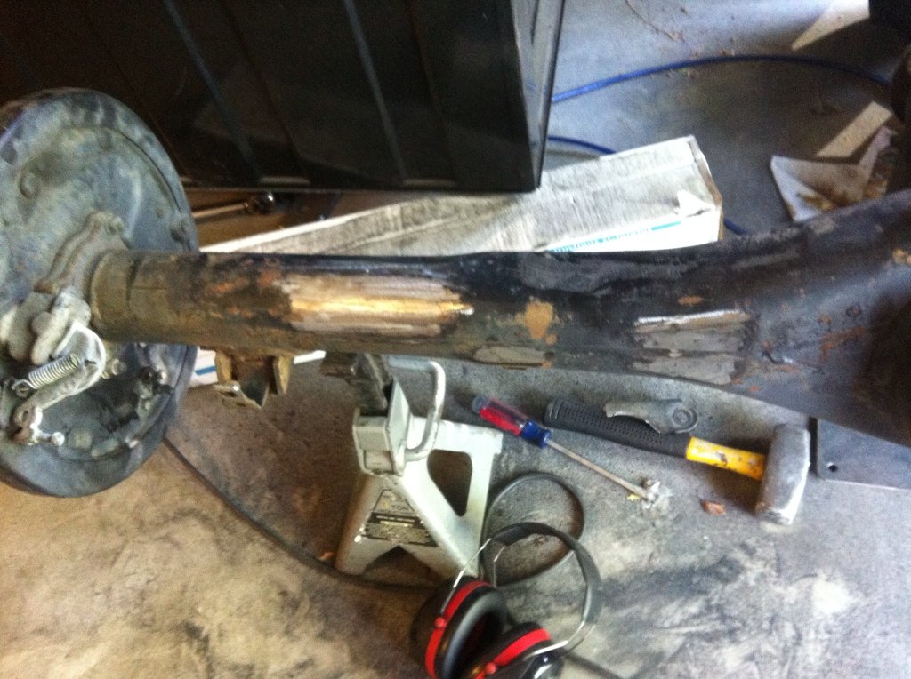

    Started stripping down the new axle housing. Pulled the axles and they are absolutely perfect. Seals are nice and greasy and no tears anywhere.
    Also, the brown truck made a delivery today.

    Finally some bump stops...
    And King fan boy has some fox :rolleyes: :D

    Yes..finally bump stops...that won't be riding on the strike pads at ride height. :rolleyes: :D
    I wouldn't call myself a fan boy...more like anal retentive and wanted everything to match. But yes, fox bumps, almost half the price of Kings and in stock without waiting for them to be built. :rolleyes: :D
