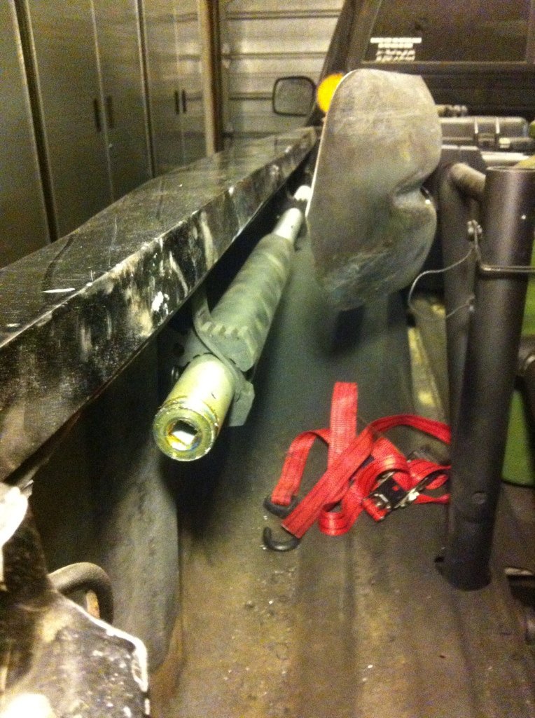

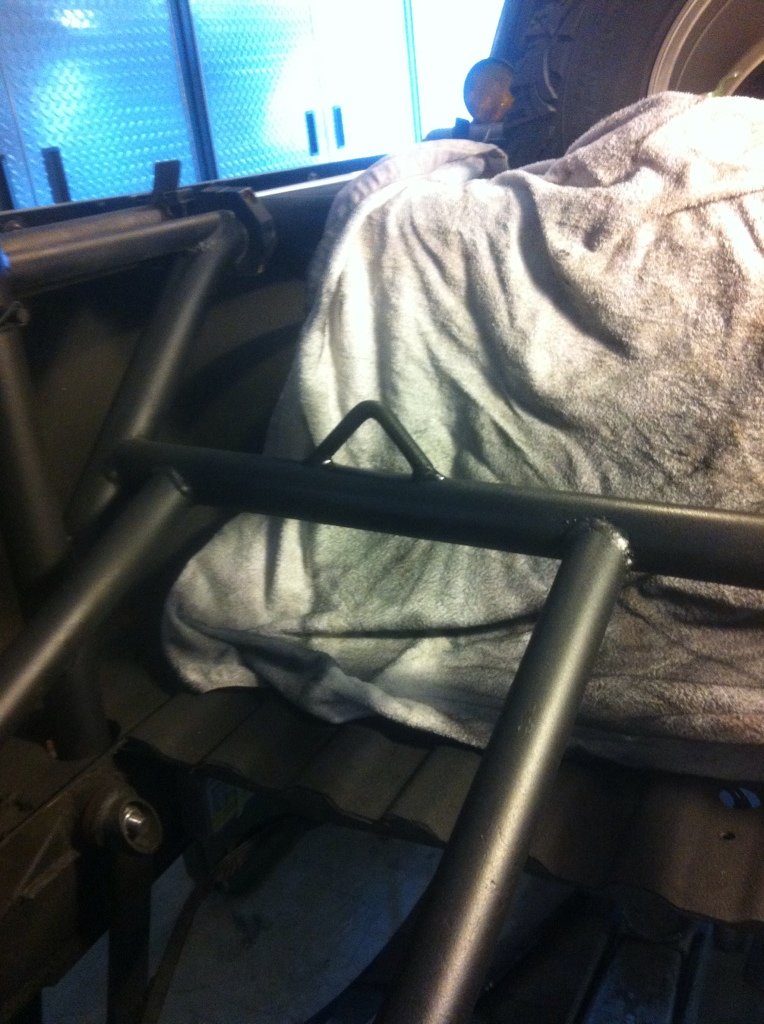

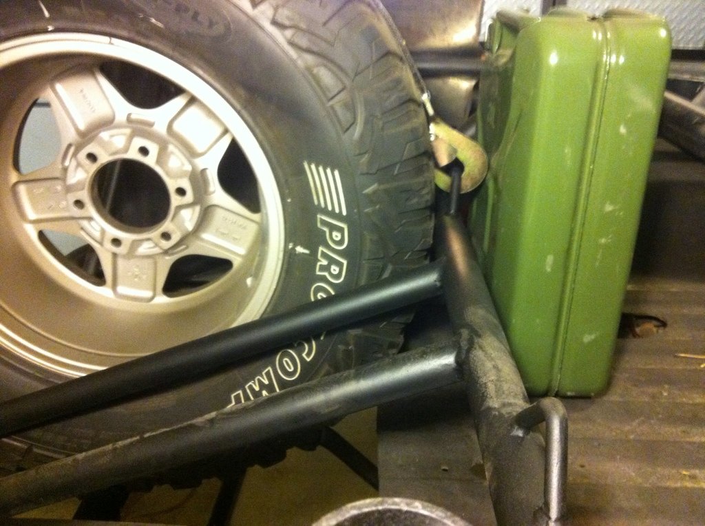

    Actually working on the little shit on the truck. Got the wires all cleaned up and zip tied to the new crossmember. Welded on some solid bar for the tire straps instead of using the axle straps I was using before.
    4A18C2EB-35CD-4910-A081-15135FCE8A51-257_9f93a76a945b7d2ce5509227e17541f84e49ad20.jpg
    AC6AD6D1-67B7-4562-9377-D0EA8C2A1A35-257_4894fba096d92218c38bc28683fdf2fb711cf64d.jpg
    Custom jack handle mount.

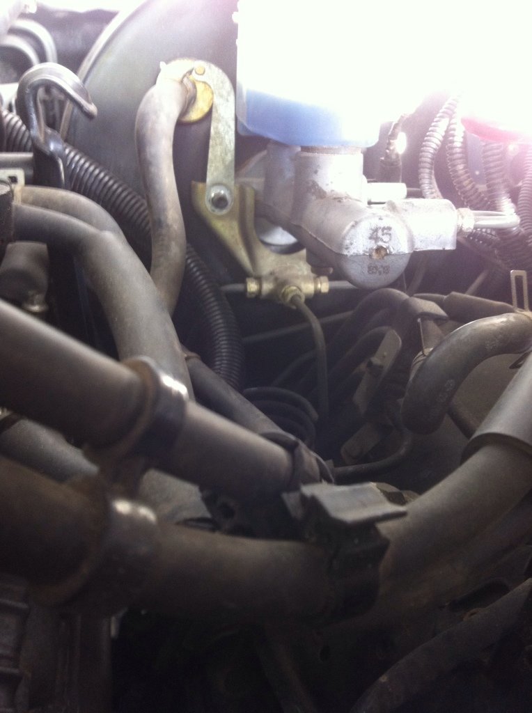

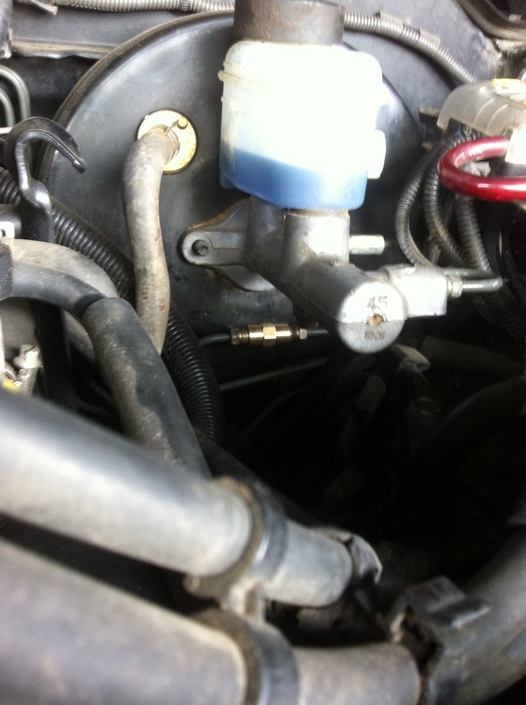

    I swear I'll pay someone to do a proportioning valve before I'll do another one ever again. Part of is I absolutely despise brake fluid. I'll work with any other grease, oil, chemicals, anything but brake fluid. IMO, It's the absolute worst shit.
    That being said...I took a page out of your book...and then re-wrote it. Got the same proportioning valve kit from FM you got. My truck has/had ABS so it wasn't exactly the same process as yours, but similar. I opted to mount it in the rear instead of on the MS like you did too.
    Before:
    FCB3EB37-7D57-4F2E-9EE4-EA86786A9F9B-257_6694ebfdaddc3ae9739ad2cff5480a8b140b011e.jpg
    6C3CDD93-02F0-4F70-ACA8-4950A6321CB6-257_695fd77637052704374e40c231a23601ea6cf97b.jpg
    After:
    137FC908-3608-4B9C-A643-C9E52A159C16-257_3feea5700c8714de41c671bb05e0c8b3656b4828.jpg
    8E9604D0-6195-491F-A264-4CD804469F41-257_b52e4708035002ce708b39170c489bb839ae084f.jpg
    Fabbed up a little mount for the proportioning valve so that it used the mounting location the factory LSPV used.
  18. Oct 15, 2012 at 8:50 PM
    #1658
    Cr250jumper
    Cr250jumper Señor member
    Dec 2, 2010
    #47033
    11,968
    The moon
    50 shades of tan©
    Tacoma with some stuff melted to it
    Ahh I see what you mean, I dont have ABS so I dont have the "T" under the master cylinder like you do. Looks good
