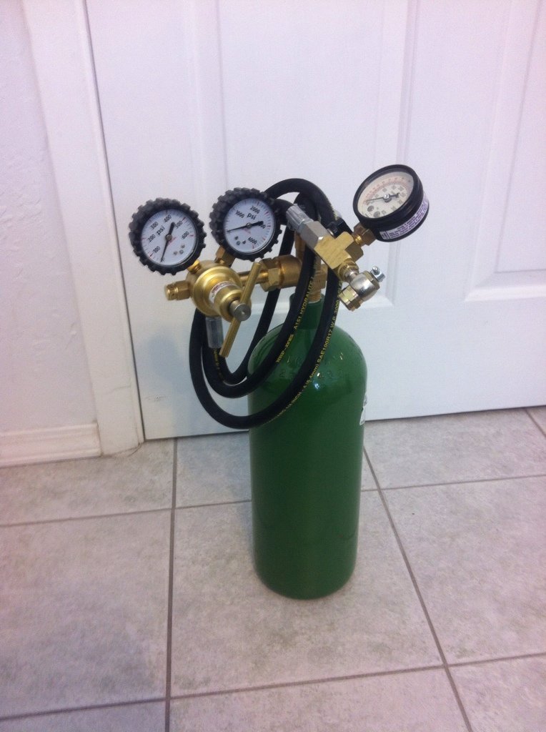

    Who needs nitrogen? :D
    0D152767-B9AB-439A-B5A7-BAD86DE3AB46-863_74f99c9cb79e4a4cca07b0b1856c178c69ba343e.jpg

    Nice, I got the same regulator, cool little setup you can take with you on trips to play with pressures.

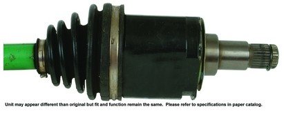

    I just looked at Kartek's mini stubs. Those all look like outboard stubs.
    The inboard stubs on a tacoma don't have a axle nut. They are held in place with a snap ring like this:
