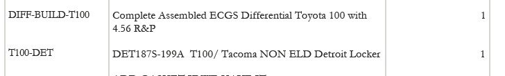

    #45374
    3,925
    Max
    Northwestern Ontario, Canada
    Locked and Geared!
    Thought you have/had a tundy diff :confused:

    How many Tundy diff's you know came from the factory with 4.56 gears, let alone a Detroit?
    Tow package with a tundra gets you 3.93 and a limit slip. They are called "limited" for a reason and I've already got 4.56 up front.

    No I meant it says "Complete Assembed ECGS Toyota 100 with 4:56 R&P" I thought it meant the differential was for a T100:cool:
    Unless they're same carrier as the Tundras, to which I have no idea.

    T100=Tundra=NonLocking Taco

    Was my second conclusion, just unsure. My knowledge of older Yota's is limited.
    So is that the last piece you're waiting on?
