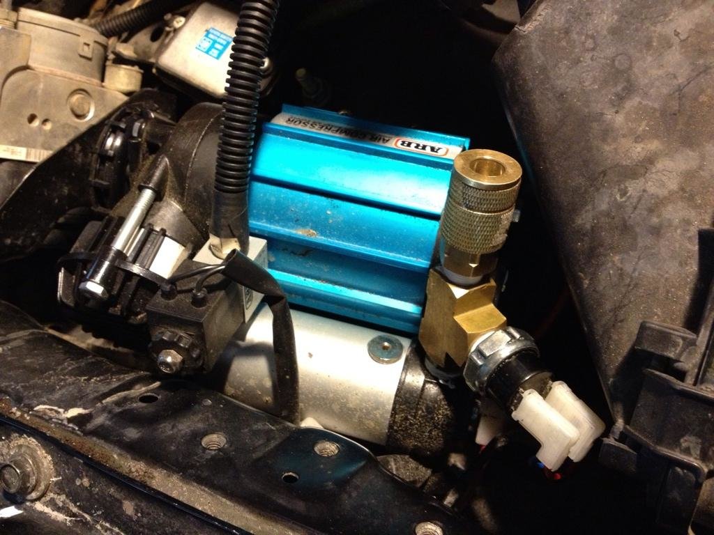

    On a different note, I made my own tire inflation adapter for the ARB with shit I had in my spare pneumatic parts drawer.
    50B70E04-61C5-45A8-BC50-30BFB165CF93-101_e0fff4f7ae9ddbf3eca8f7c4f745c8178c867c37.jpg

    love this!! I have to keep a little hex wrench with my air hose, just so I can air up my tires. And it still leack a bit... Yours is a much better setup!! Good work.

    Feel free to steal my idea! Seriously it wouldn't cost more than maybe 10 bucks in parts if that. The fitting threads for the pressure switch is the same as what you would pick up for any pneumatic tools at Home Depot or whatever.
    Here's your shopping list:
    1 male-male brass fitting
    1 all female brass T
    1 male quick connect
    Thread sealant tape
