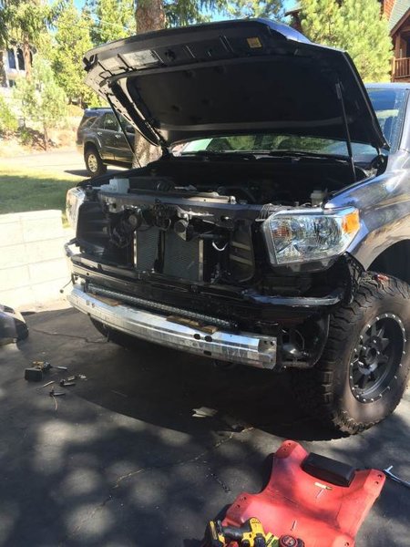

    Finally got around to installing the 40" single row LED bar I used to have in my first gen Tundra. Not a hard install, but pulling the bumper covers off and mocking things up was kind of a pain in the ass.
    Ended up making a little riser block out of 1" square tube to better position the bar. Came out pretty clean.
    It's wired up with a relay tied to the high beams.

    Hmm did you just run a bolt the whole way through the crush bar?

    It's hollow. Just drilled through and a nut inside the hollow part.

    Looks good the 40" fits perfect

    For the most part. The last couple LED's on each side are blocked by the bumper cover. But not enough for me to care and go out and buy a smaller bar when I already had this one.
