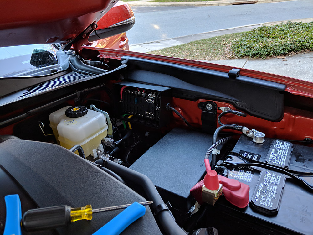

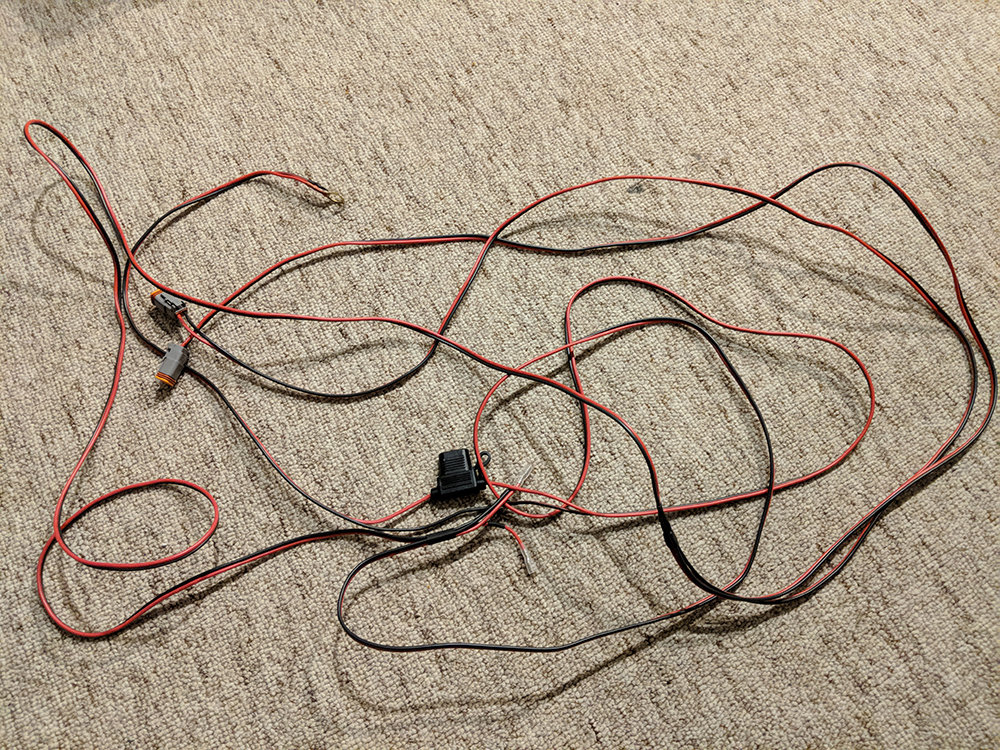

    The first thing I wanted was some ditch lights. I figured it would be a simple and easy first mod. Then I looked at this and said "nope"
    Getting wired.
    I ended up with this. Lines color coded with fray-resistant expandable polyester sleeving.

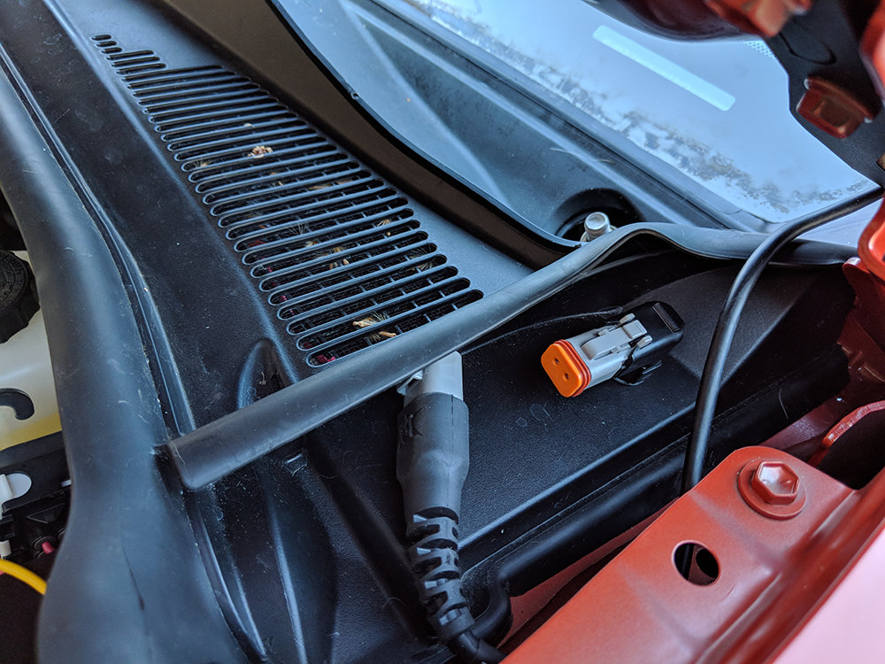

    Fuse block grounds to the sidewall. Power for the ditch lights parallels the cable for the wiper motor under the cowl. Eventually radios and everything else will come off this.
    Thumb screws hold the lid on. Should keep mud, dust, etc., out of the fuse block. Lets me replace a blown fuse without having to find a screwdriver.
    The empty will be a voltmeter that's on order.

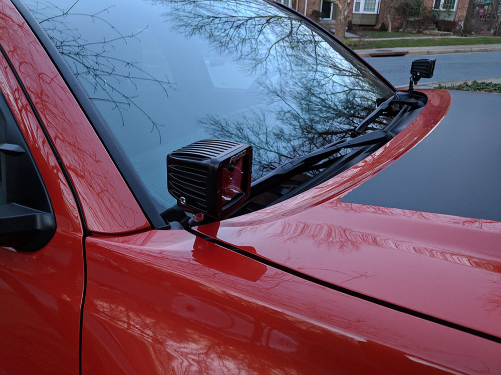

    Deutsch DT Series backshells mounted in the cowl for the ditch lights. There is another Deutsch connector under the cowl that allows it to be removed should the windshield need to be replaced.
    And finally. The ditch lights that started this project.

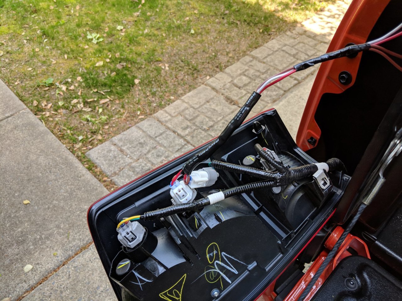

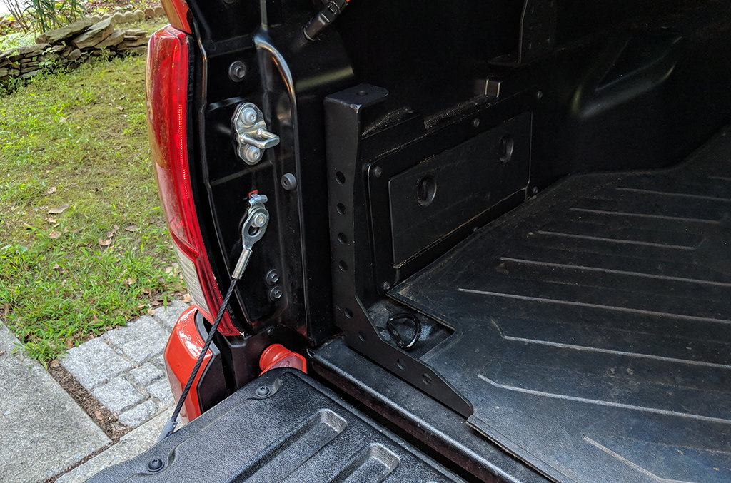

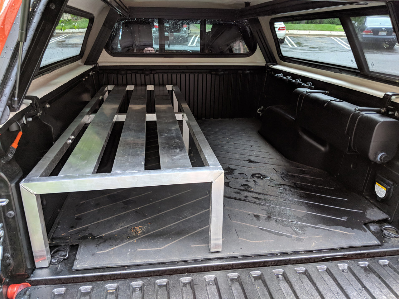

    ARE cap on. Didn't let them wire the cap brake light. Used a T plug for DIY trailer lights rather than T taps on the wire harness.
    Also Added a waterport for showers and a half rack to use as a sleeping platform and for cargo. The rack is an aluminum dunnage rack from a online restaurant supply store. Hell of a lot cheaper than having something fabricated.

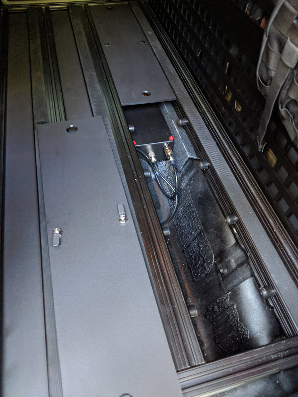

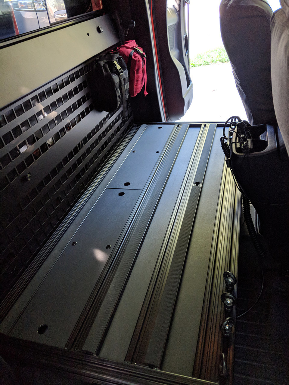

    Catching up on my updates. Ham and CB installed. Cab platform installed.
    I need to trim a quarter inch off my platform panels
    IMG_20180614_182857.jpg IMG_20180625_230045.jpg IMG_20180625_230135.jpg IMG_20180625_230549.jpg IMG_20180628_195801.jpg IMG_20180602_200537.jpg

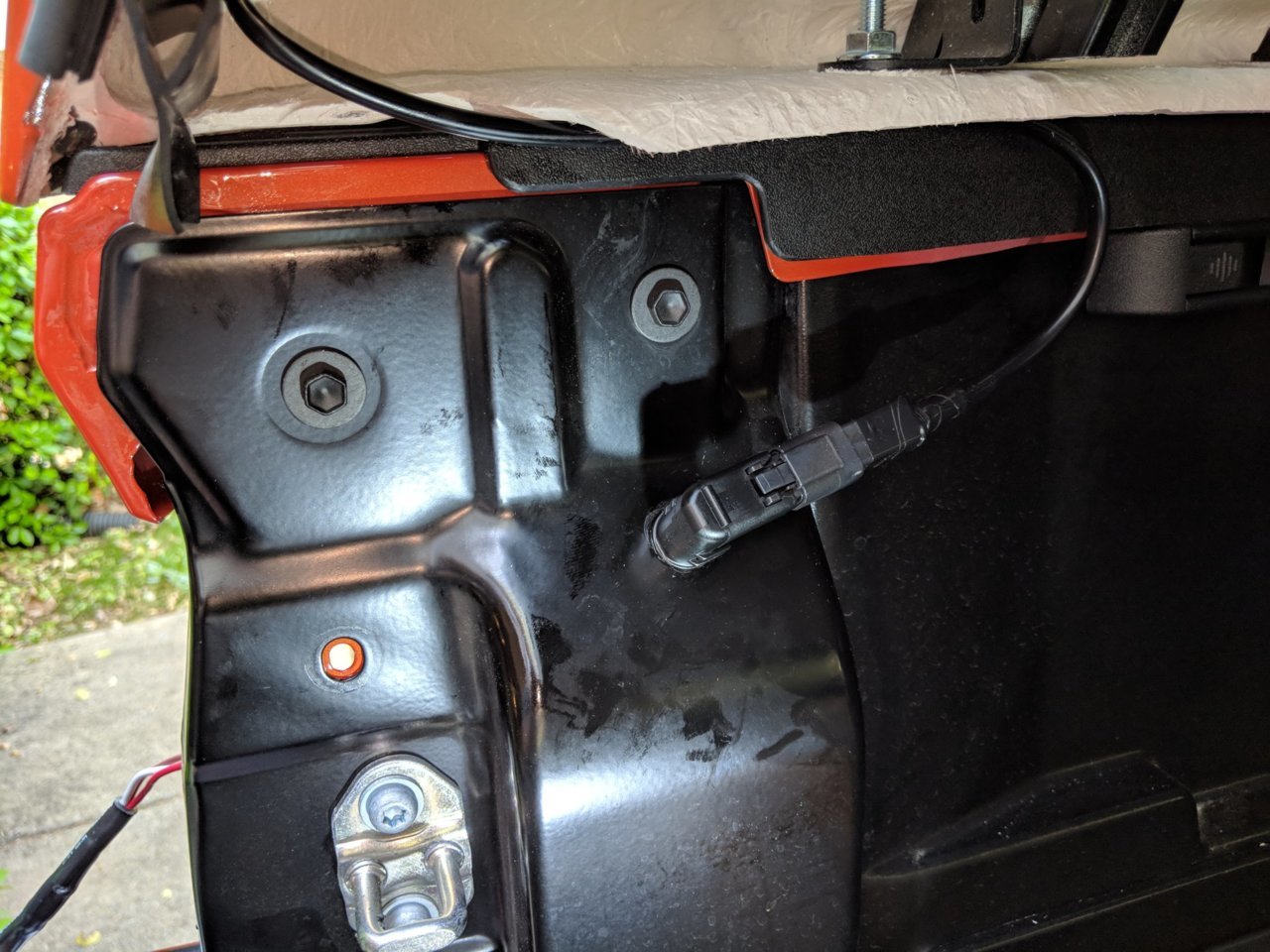

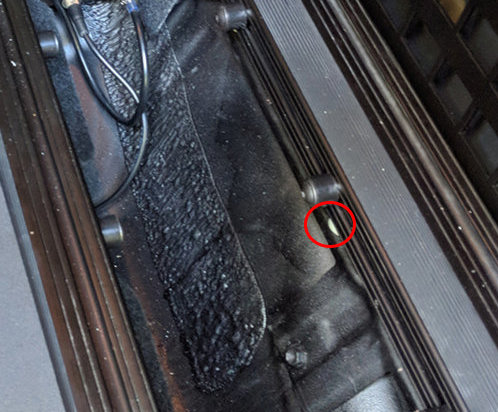

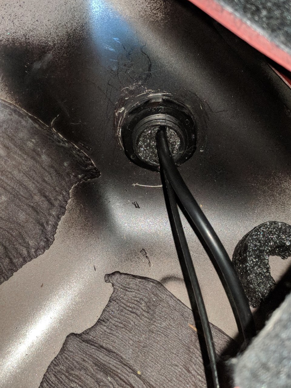

    The Diamond antenna mounts are really nice. An allen wrench can be used to fold them back to avoid overhangs and obstacles. However they are for ham radio antennas so to get them to work with a CB antenna I had to reduce a 5/8" hole to 3/8". They are the last 3 items on the parts list.
    A nylon sleeve bearing and steel shim sandwich the 5/8" hole for a ham antenna. The steel shim provides the ground for the FireStik cable. The nylon sleeve bearing plus the 3/8" ID nylon insulating washer provides the necessary insulation for the CB antenna.
    From the cabin inside.
    And then back up to the inside the bed.
    Materials
    Most any epoxy adhesive for the nylon conduit and adapters.
    Silicon sealant for the cable pass throughs.
    For the FireStik Stud Mount (and any other exposed connections)

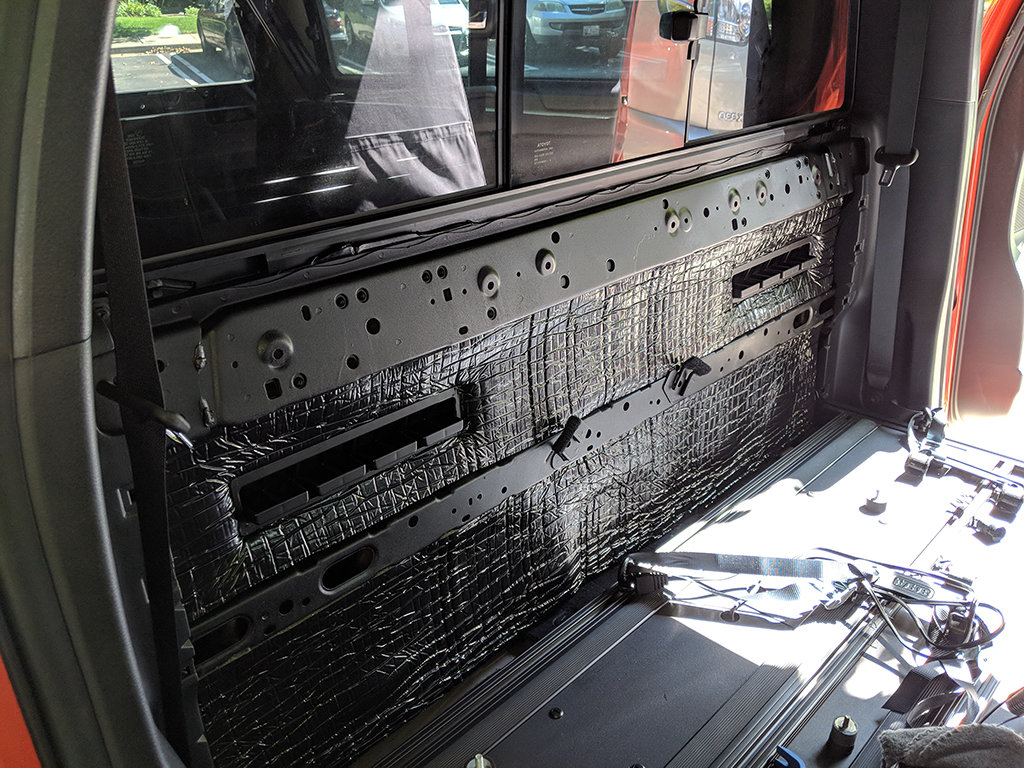

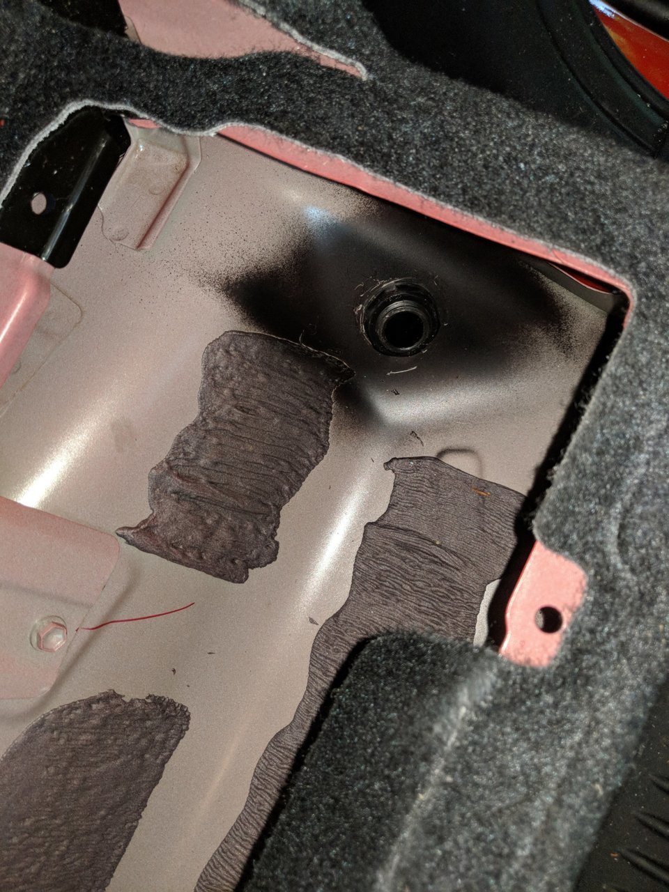

    Cali Raised Stiffeners replacing their hardware with stainless and added some sound insulation behind the molle rack. Masked and hit the back wall with a rattle can of rhino liner as well.
    I have filter foam for the vents in the back wall. Just deciding how to keep it in place.

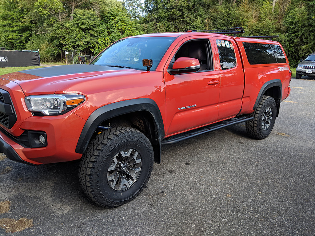

    Someday I'll have a garage big enough to tear down a beater truck and tinker and not worry about my daily driver being OOC. Not today though. Lift was done by Iron Pig Offroad in Fredericksburg VA and sent out for the alignment at noon.
    • OME 886 coils
    • OME 90000 firm ride struts
    • OME 60091 Nitrocharger rear shocks
    • OME Dakar heavy full leaf pack
    • OME trim packer for drivers side lean
    • OME carrier bearing drop bracket
    • Total Chaos UCAs
    • Cooper Discoverer ST MAXX 255/85R16
    Went with the tall and skinny tires. I'm still just above 20 mpg after the lift.

    My man! I'm totally going to update my current plywood platform to this! Question, how did you secure the t slot frame to the rear? I'm guessing by the seat mount? But how did you bolt to the mounts? Did you secure the t slot frame to the bottom seat fold bracket as well? Interested in mounting details! I assume it is cantilevered and doesn't have support under the overhang on the front correct??
  16. Sep 13, 2018 at 8:58 PM
    #16
    jbezorg
    jbezorg [OP] Well-Known Member
    Feb 17, 2018
    #244737
    71
    Greg
    Gaithersburg MD
    2018 Tacoma AC TRD Off Road
    The 1.5" cap rails extend past Doc Loco's molle panel and the panel had to be notched to do so. There's L brackets made out of Home Depot 1" stock that I had in the garage. They reuse the outside seat mounts and bolt to the inside the cap rails using 5/16" end-feed fasteners.
    After removing the plastic lids and bin from the underseat storage. The cross rails on either side are spaced at a distance to align the slots with the holes for the push-in retainer pins that held the storage plastic in place. The two outside, rear holes did not align so new holes were drilled. The 2 center holes in the back did not have enough space to slip a nut over the threaded rod. The 6 holes for the pins on the front line up fine.
    Nylon spacer
    6 of the 2" threaded rods for the front
    4 of the 1 3/4" threaded rods for the rear leaving the 2 in the center empty.
    10 of the 7/8" long white nylon spacers between the t-slot railing and the frame that boxed in the storage area to hold everything at the right height.
    It is cantilevered but I am thinking of adding support to the front or perhaps supports on the inside corners of the storage area.

    Thank you for the follow up! I am thinking the DC storage is different from the AC, as my rear mounts for the bins are 1 3/4" below the front of the bin mounts. I am going to go with longer spacers.
    So you just used 5/16-18 nuts for the underside of the threaded rod to mount to the bin holes? That is the last piece I am trying to figure out, as I would like to keep the plastic bins, of course accessing the nut would be trickery!

    The 3rd break light wiring isn't hard. Just look for a hopkins trailer wiring harness for your vehicle and just cut off the jumper for the break light instead of using wire taps on the vehicle harness. I didn't bother with additional lighting in the camper shell so I can't advise on how to hook that up. On the 2016+ there's a bed light option. Even though I don't have them I suspect the vehicle harness has the plugs and I could use those if I went with additional lighting options for the cap.

    Yep. 5/16-18 lock nuts and washers slightly larger than the diameter of the nut.
    If the front of the bin is flat you could go lower in the front and not quite as high in the back.
