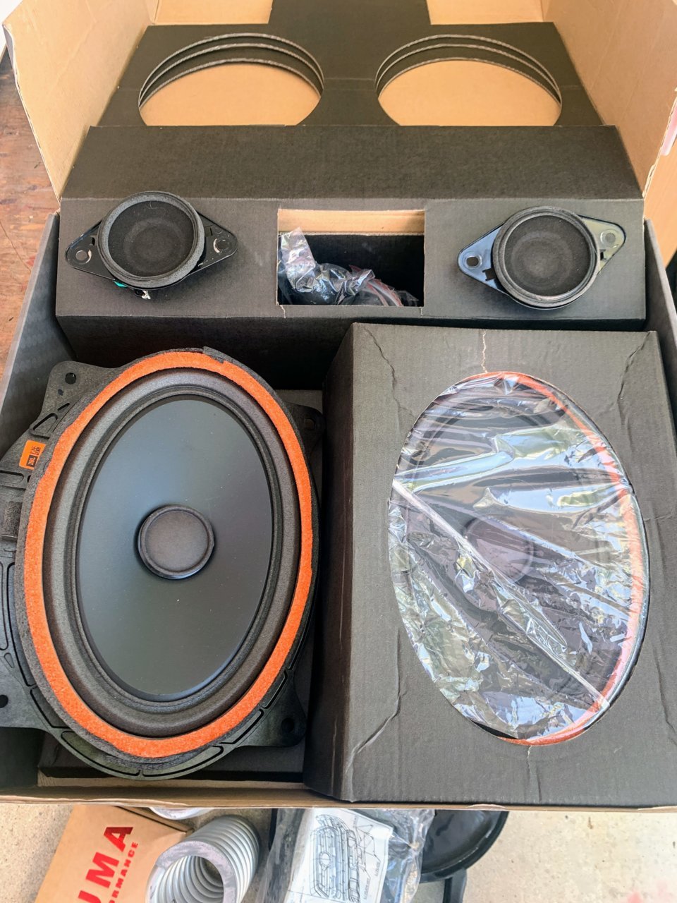

    5nahalf likes this.

    alright! so the rear speakers are two way? and they work fine? the fronts are which woofer in your spoiler list? did you ditch the tweeters it came with? i have so many questions because it just pictures. thank you!

    The rears are full-spectrum and sound awesome! The fronts are the Infinity 6x9 woofer but we confirmed the JBL speakers are the exact same thing. Alternatively, a 6" adaptor and the less expensive 6" component woofer might be used in place of the 6x9. I still have the Infinity tweeters and crossovers, but I'm not sure if I'm going to install them in the "sail panel" or not. If I did, I'd daisy-chain off the tweeters in the dash, and probably use the crossover to eliminate any mid-frequency. We still need to dynomat the inside of the woofer cover, door panels, and doors, because this system hits hard. The stock eq can be dialed in a bit, and Spotify adds a custom eq too. GL!
