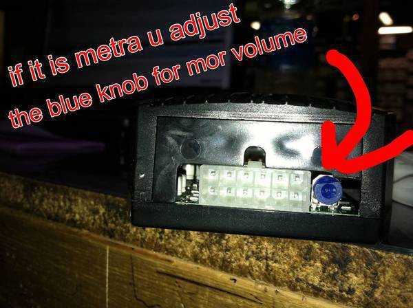

    chrome on front painted to match, satoshi grill done by myself, BHLM, billys all the way around with ome springs upfront and LR ucas with wheelers 3 leaf progressive pack in the rear, mb gunner wheels powdercoated black on 285/75r16 nitto trail grapplers, tinted all the way around and on windshield, pioneer dbl din touch screen with two 10's behing the seat and new speakers all the way around and certain interior parts painted to match, also have a road wire leather kit black with red stitching sitting here waiting for me to find time to install it!
