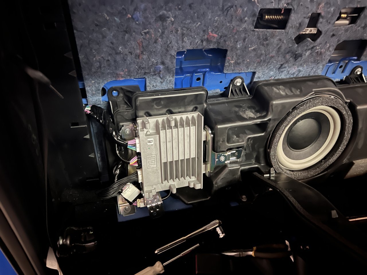

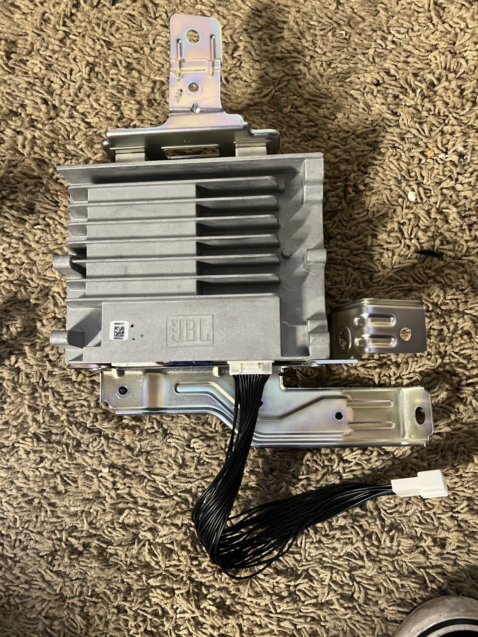

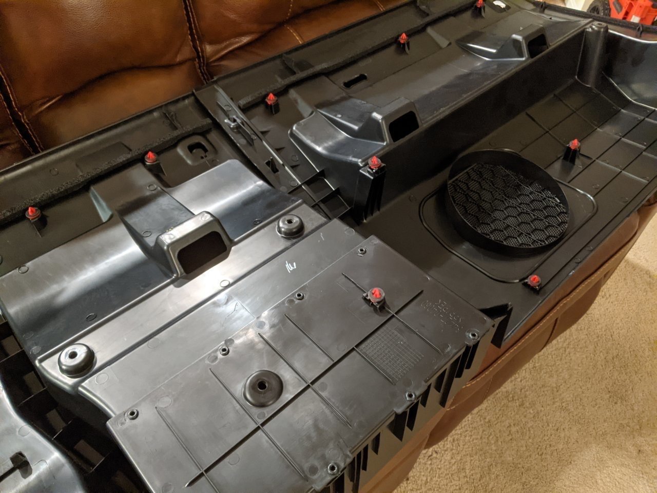

    Here is what I had to buy:
    - 2020 Head Unit (part# 86140-04210)
    - 2020 AMP (part# 86280-04080 <= not 100% sure of this part number)
    - two adapter harness from autoharnesshouse.com. One for the HU and the other for the AMP
    - replacement clips for back panel (https://www.amazon.com/gp/product/B07R1QTSQ1?ie=UTF8)
    - tesa tape (to prevent rattles) (https://www.amazon.com/gp/product/B09KHKX9Y5?ie=UTF8)
    The install was straight forward...
    1. removed back seats and back panel to gain access to the AMP
    NOTE: you will probably break some of the red clips, buy new ones in advance.
    2. replaced old AMP with new one
    3. plugged in new AMP using adapter harness
    4. removed radio bezel and HU
    5. connect new radio to vehicle with adapter harness. I took my time on this step, just to make sure I got all the clips connected to the correct spot and made sure they fully clicked into place.
    6. did a quick test to make sure all speakers (front/back/right/left), audio paths (am/fm/xm), USB and GPS where working
    7. put it all back together.
    After that, I did perform a factory reset on the HU and then upgraded the HU and navigation firmware (https://www.toyota.com/firmware-updates).

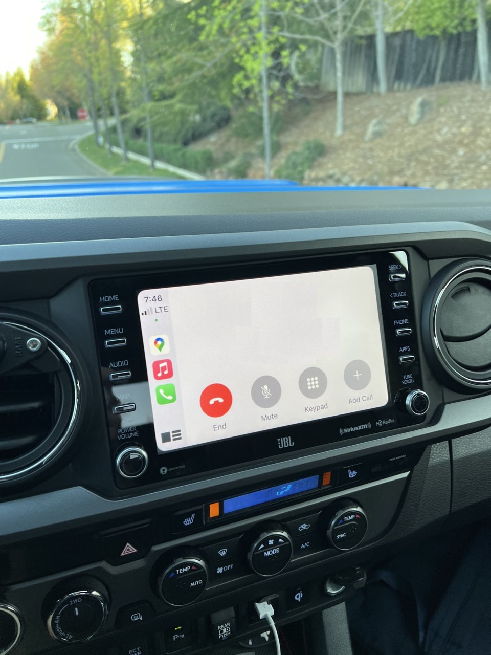

    I was happy to see that the instrument cluster navigation/music tabs (I mentioned in my prior post) where working as before, basically I did not lose any factory functionality.
    Cost:
    HU + AMP - this is hard to say because the guy I bought it from sold me the HU, AMP and subwoofer assembly for ~ $750
    Harness - $270
    I also added a wireless carplay adapter ($90), now I just get in my truck, start it and carplay works, I don't even have to take my phone out of my pocket.
    Good luck with your upgrade and let me know if you have any more questions!
