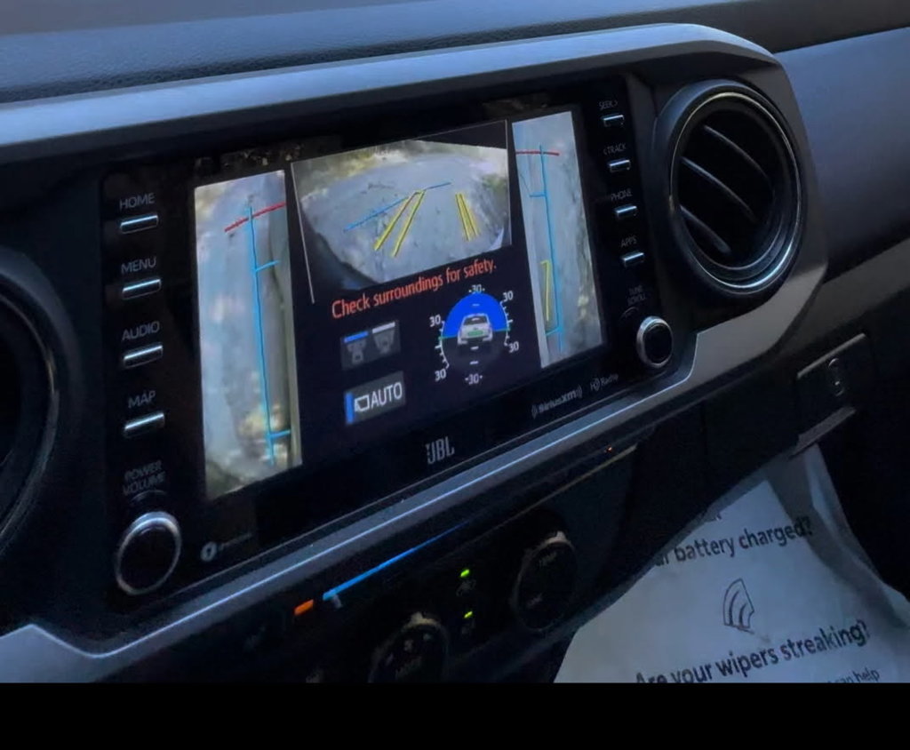

    So I just got my 2020 Tacoma OR a couple weeks ago and wanted to switch the head unit with a better one. I also have the panoramic view cameras but when I search this site and others I cannot find anything in regards to keeping the Panoramic views while upgrading the head unit.
    Has anyone here replaced the factory JBL head unit on a Tacoma and kept all functionality of the panoramic camera view? Is it even possible?
    Any info would help and if someone's got any pictures that would help also.

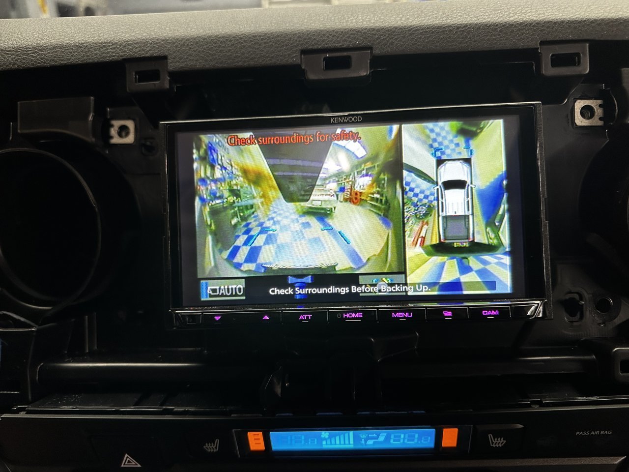

    Mine still works just fine.
    2022 Tacoma w JBL
    Kenwood Excelon DNR-1007XR
    W maestro RR
    Also used a Kenwood DMX-958XR

    Hey mjc251.
    Could you provide a link or part number for the Maestro harness you used to get the panoramic camera? I’m in the process of upgrading my head unit and would like to use the Pioneer DMH-WT3800NEX 9 inch but Crutchfield is saying it isn’t possible to keep the cameras. I showed them this thread and now they are curious about the harness you used and if it can be used on a Pioneer. Thanks man.

    Did you keep all the functionality with the Kenwood? Along with the SOS feature? looking to upgrade my 2023 OR with JBL. and it seems Kenwood keeps the most features.

    I used the TO3 harness with an RR2
    I haven’t found anything missing at this point. Never used the SOS and it’s not freaking out on me so I’m gonna call it good.

    For those who want to do the DIY route, I like what I’ve seen from them. That being said, I haven’t actually heard the system so I can’t speak for the value of it.
    As for radio replacement, I can tell you that the Kenwood is AWESOME with the maestro setup! The wireless CarPlay for me is what’s worth it.

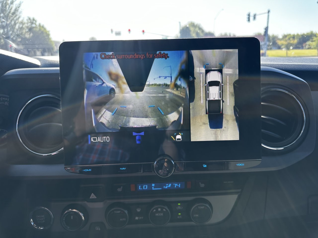

    When you go into 4Lo do you still get the vehicle angles front facing camera view?

    whoa!! I’ve never seen that… probably because I’ve never been in 4 lo.
    But my guess would be yes since the maestro is just basically a pass through of video signal.

    I can’t tell on your picture but is the back up camera and the quality better overall?
