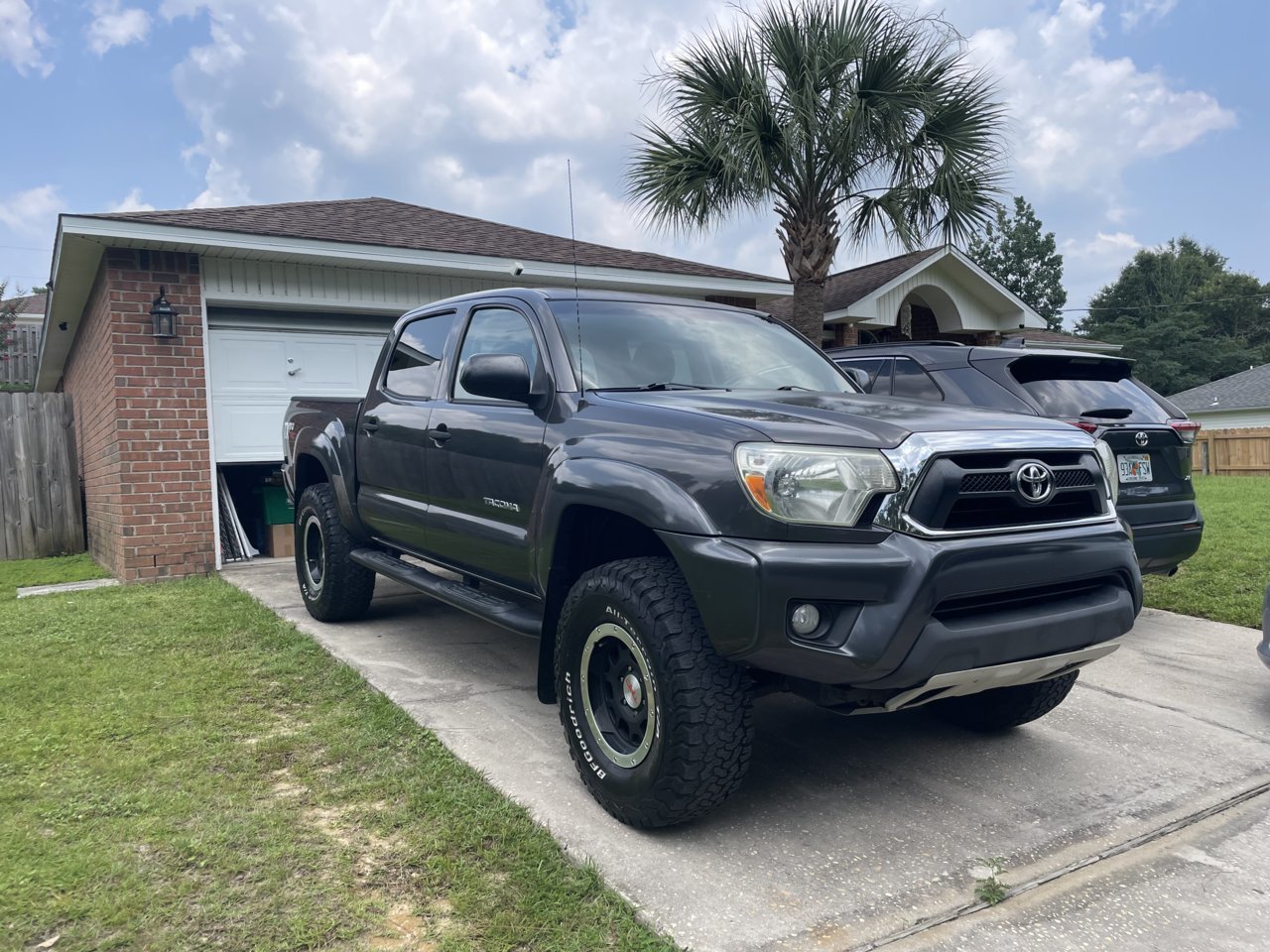

    225E95D8-9419-4173-AE81-29BFDD032E4E.jpg Just got a 2012 TX Pro and it came with the JBL system. Unfortunately the OEM touchscreen barley works unless I tap dang thing 100 times. What is a good plug & play aftermarket touchscreen radio that will work with the OEM JBL system? Don’t really need the integrated NAV etc just a good touchscreen Bluetooth. Thanks!
