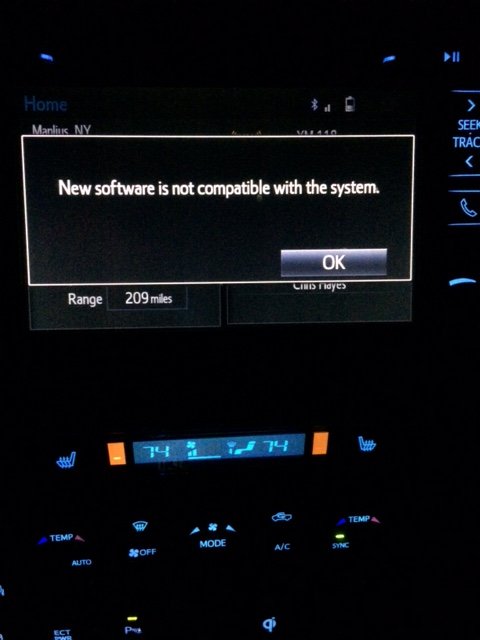

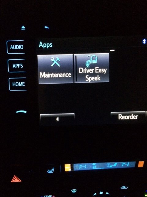

    Started Taco about three weeks ago and following message came up on JBL Premium Media Player "New Software Not Compatible with the System". Touch screen sensitivity works inconsistently - sometimes you have to push icon repeatedly with varying amounts of pressure and also lost some menu functionality. No longer have clock option/feature and setting to adjust touch screen sensitivity- both disappeared. Interestingly though I gained a new app "Driver Easy Speak". Service desk at dealership gave "deer in the headlight" look but was more than happy to write-up $$$ service order. I refused and was then referred to salesman who told me "Driver Easy Speak" is only available on Highlanders and Vans. Hands free iPhone 5S, iPod port, XM radio still work like normal. Salesman recommended I visit Toyota Secure Download website but got nowhere - last update in 2017 - followed instructions - Taco would not even recognize USB thumb drive. Salesmen told me sometimes downloads come through satellite and/or phone. Wonder if anyone has seen this issue before? Any thoughts or help is a appreciated.

    Weird. Either Toyota pushed the wrong update to your system, or the most recent update glitched badly during install.
    If you had the USB drive formatted properly, but the system wouldn't recognize it, then it's up to the dealer to flash the correct version.

    First attempt I used an old 2G thumb drive. Second attempt I reformatted a newer 2G thumb drive before doing download update. Did not make a difference. Still not recognized. I'm going to call dealer on other side of town to see if they'll be more helpful. If I don't get anywhere, then I'll try corporate. I too suspect a rogue update or glitch. Frustrating to have a semi functioning touch screen.

    Called Toyota Corporate who was helpful but unable to solve problem by advising me to reset player holding power button in the off position for more than 5 seconds. Corporate referred me back to dealership. Spoke with salesman who sold me Taco(good guy - he was not working when I first stopped at Dealership) and he arranged for service to "flash" truck at no cost even though I'm outside of warranty due to miles - just have to wait a couple a few days before appointment. All agree it appears likely I got a rogue download possibly by satellite or through phone. The "Driver Easy Speak" is a function available only on the Sienna and Highlander models.
