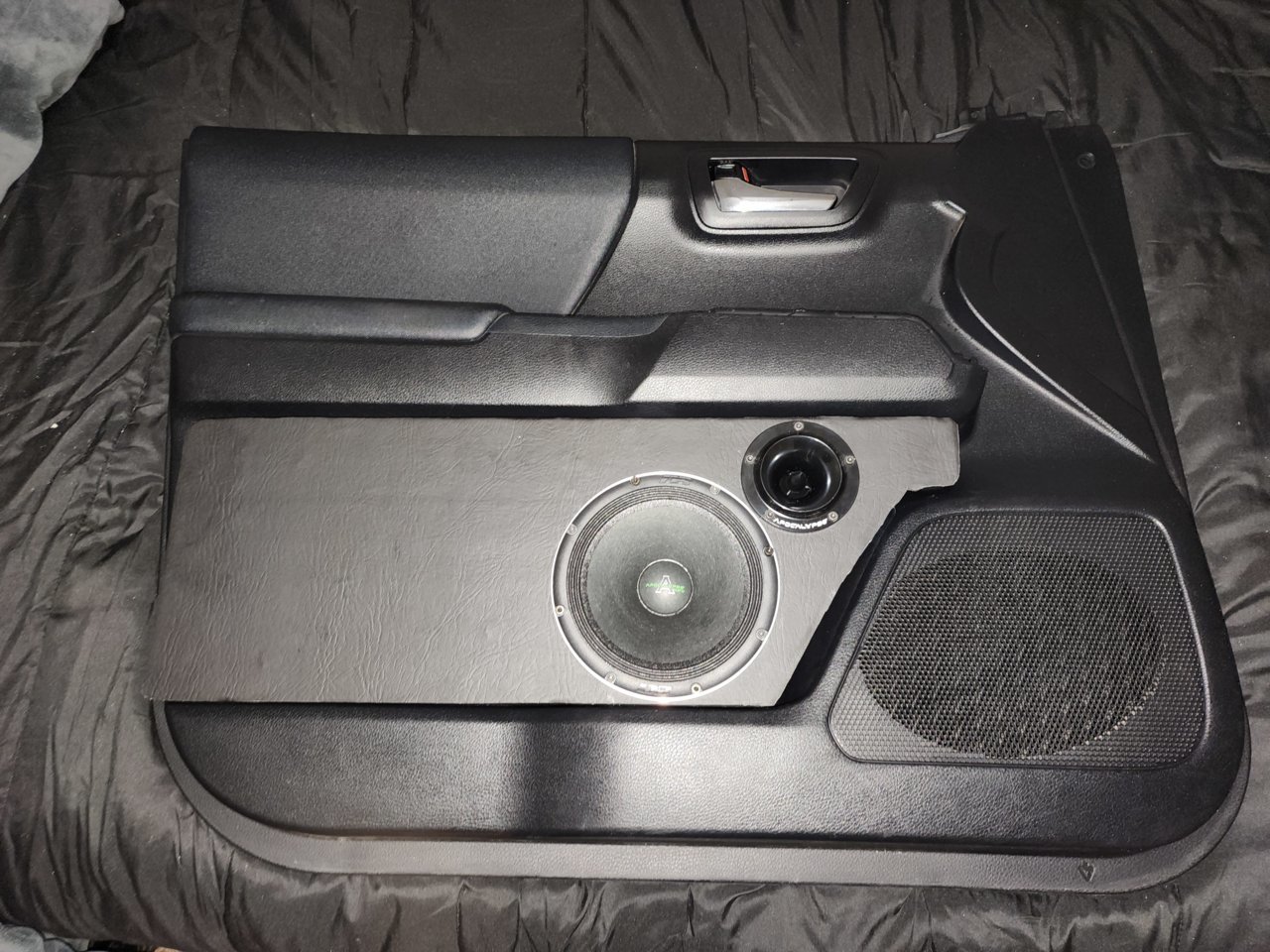

    Just did the 4 6.5 deaf bonce Arnold's and deaf bonce tweets , getting rid of that non sense cup holder

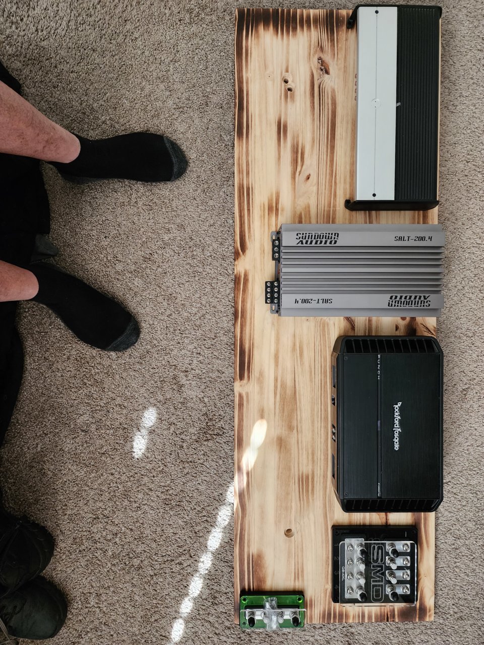

    Doing rockford p1000xbd for 10w7
    Doing the salt 200.4 for the 4 6.5 Arnold's beaf bonce front doors , Doing the jl audio xd800 v2 for the 2 6.5 Arnold's in the back door the deaf bonce tweets on door panel and the 2 deaf bonce tweets in the a pillar

    I still need to add the dynomat and possibly the tweeters, but otherwise, rock solid!

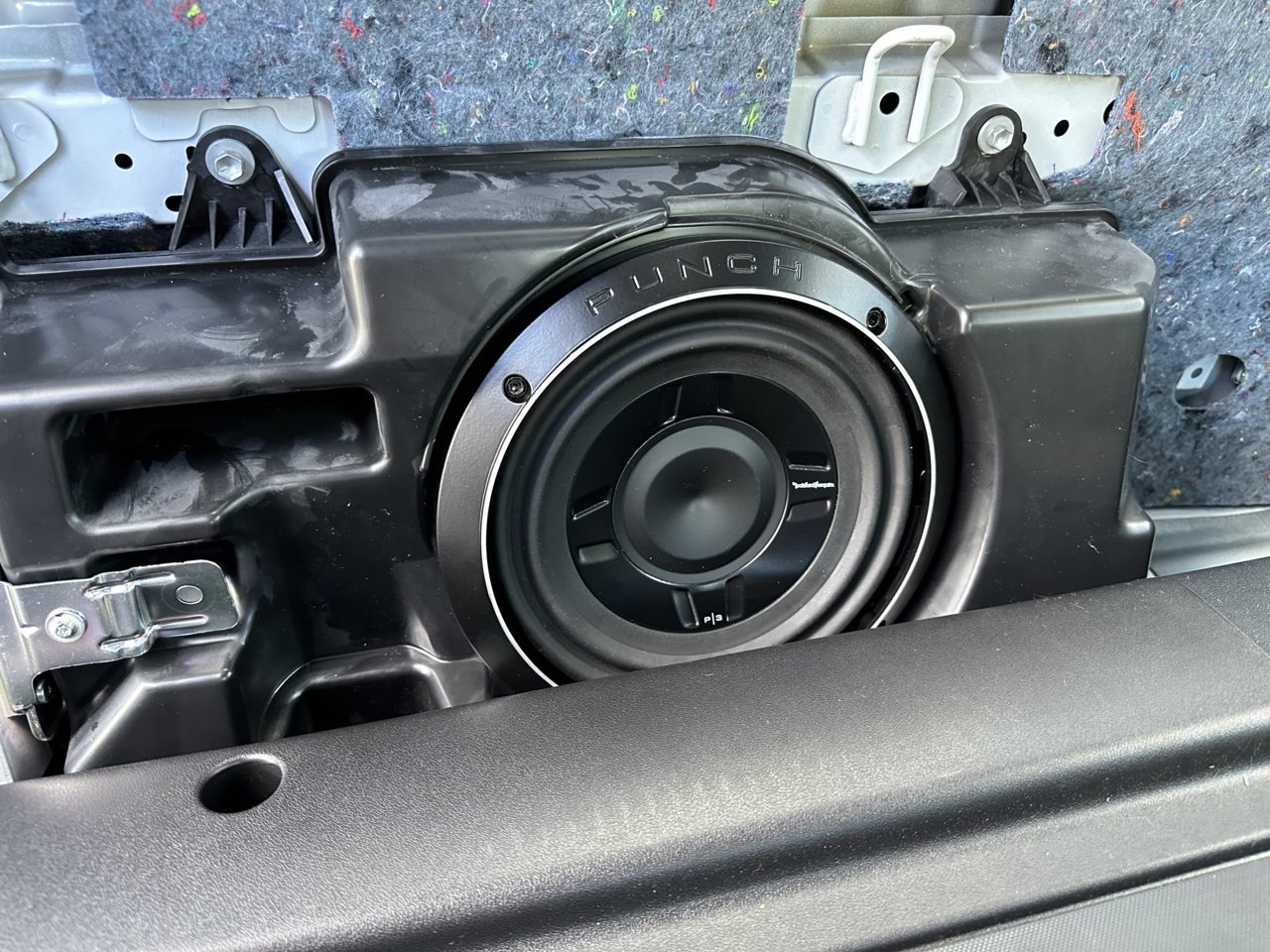

    Rear cab 8" DVC Sub
    --2 channels (Dual Voice Coils). Each one operates at 2 ohms (2.3 ohms measured)
    --28hz-500hz (Sub/Lows only)
    --Power: 50W RMS each coil (100W total) (110 watts combined max at 55W Max per channel from AMP)
    --Recommend: Lower wattage 4 ohm Dual Voice Coil Sub, wired in parallel down to 2 Ohm, with a low RMS and a drop off at 30-40hz. Bridged from AMP (red and green wires to the sub). Alternatively, an 8” - 2 ohm DVC sub is a direct replacement.

    Im using a 4 ohm dual voice coil that is wired to 2 ohms. This only gives one input to the sub. So you use the pos from one channel and the Meg from the other (red and green wires. It sounds great. I had to trim the molding fins in the back of the subwoofer box as well.
    KICKER CWCD84 CompC 8" Subwoofer Dual Voice Coil 4-Ohm https://www.amazon.com/dp/B01N7QMXWW
    you could also get any 2 ohm dual voice coil 8” sub and just plug it in. Rockford Fosgate makes a good 2 ohm direct replacement.

    Thank you guys! Just replaced mine with the same sub. I used the connectors. Not sure on the polarity but just used the black wires for negative and the other for positive

    It sounds a bit better i can now at least hear some bump lol
