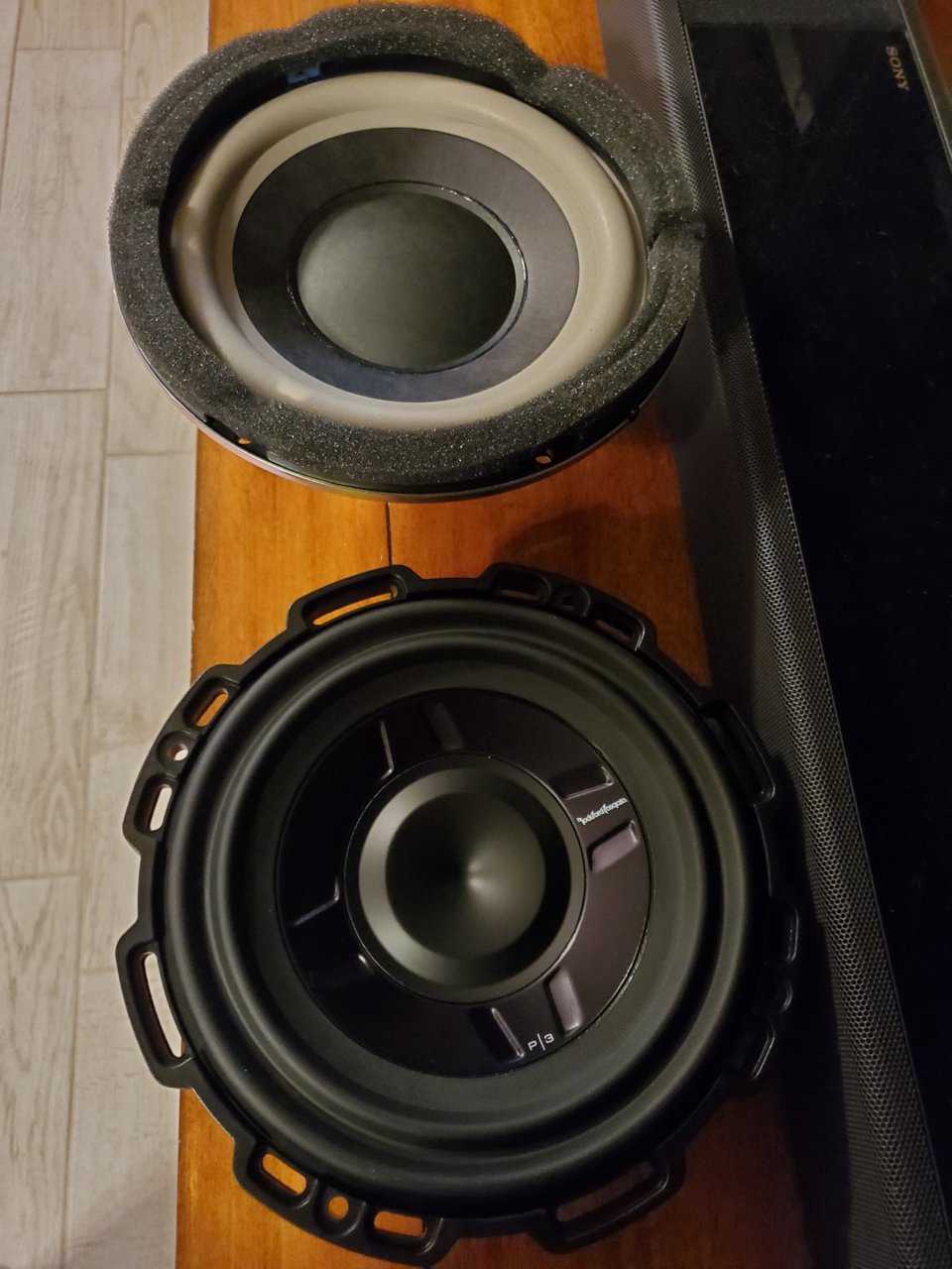

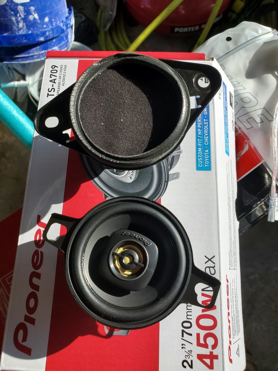

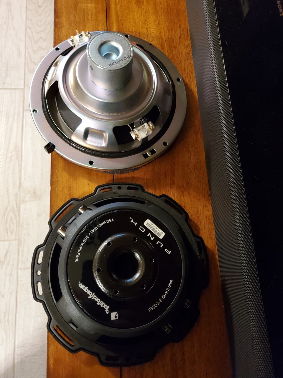

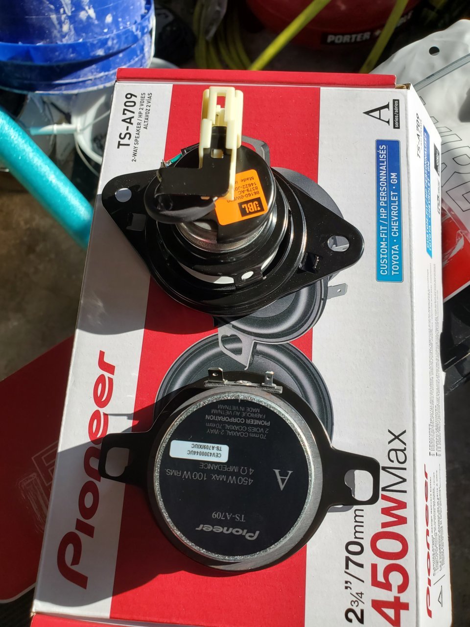

    Finished replacing all of the speakers. The magnets on the "premium" speakers are not that impressive.

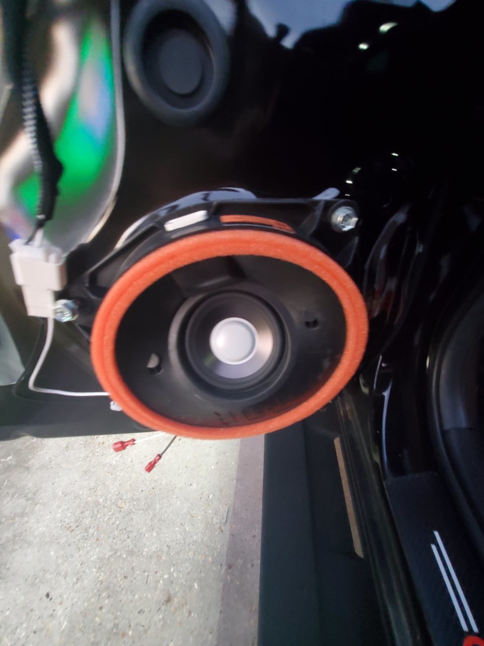

    OK, so thoughts: The sound is much cleaner and I do notice the bass more. With the bigger speakers in the rear doors, the sound is fuller, like more surround. It is definitely an improvement.
    I am gonna give it a while and see if I want to replace the amp. When I do that, I will go with a bigger sub. I know I can go with a 10" sub, but I am thinking that if I remove the panel behind the rear passenger seat, I can probably build a box with enough air space to do a sealed 12". I want more bass, but last time I threw a system in a truck, my '91 Toyota truck, I had 2 15' subs in the back. So I may not be happy until I get that much bass.
    Gratuitous pics attached. I didn't take pictures when I was installing last night...well, except for the 1 pic of the rear door speakers.

    sealed 12 is going to be a tough airspace requirement. if you want low and loud, i would recommend looking into ported or passive-radiator-supported 10" subs. even the 10 passive radiator setup is pushing the absolute limits of the the available spacing

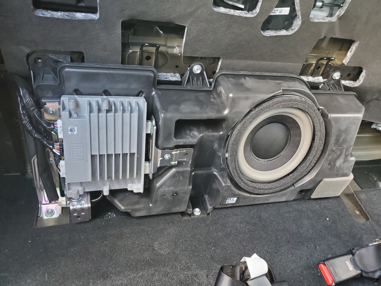

    easiest way is to use the factory amps sub output to go to your new amp as a high level input.

    Any advice would be appreciated. I reluctantly ended up using an LC7i I had laying around to send signal from my factory amp to my JL Audio 10” sub amp. It sounds way better than the factory sub, but I’m really confused about the input signals to the LC7i. I removed the factory sub and fed voice coil #1 ( purple/green, purple/yellow) into the LC7i channel 3 left side and voice coil #2 (purple/black, purple/red) into channel 3 right side. With this configuration I had to turn my gain on the sub amp to about 3/4 and it sounded kinda blah. I read on here somewhere that I should tap into only one voice coil, but I also read to use both. I ended up using just voice coil #1 into the left side of channel 3 and for some reason I was able to turn my sub amp gain back down to less than half and it actually sounds better and louder now. What the flip? This sounds counter intuitive to me and now I’m left wondering if I should use a Y-adapter coming out of the LC7i to feed my sub amp a left and right signal. The LC7i is only being used for the sub at the moment and none of the channels are summed. Also, automode is turned off.
    **I know that the LC7i is not the best thing for our JBL systems, but I actually tried the pac ampro TY13 module and the speaker wire harness and it worked but the sound quality was garbage. I had to turn the gain up pretty high and even then it didn’t sound any better than the factory sub. With my phone connected to the aux port it sounded so so but fm and xm you couldn’t even tell that I had a sub. That was with the bass set to max on the HU and the bass knob. Crutchfield and PAC tech support said they were stumped and couldn’t resolve the issue so I returned it. Hence the LC7i instead.
