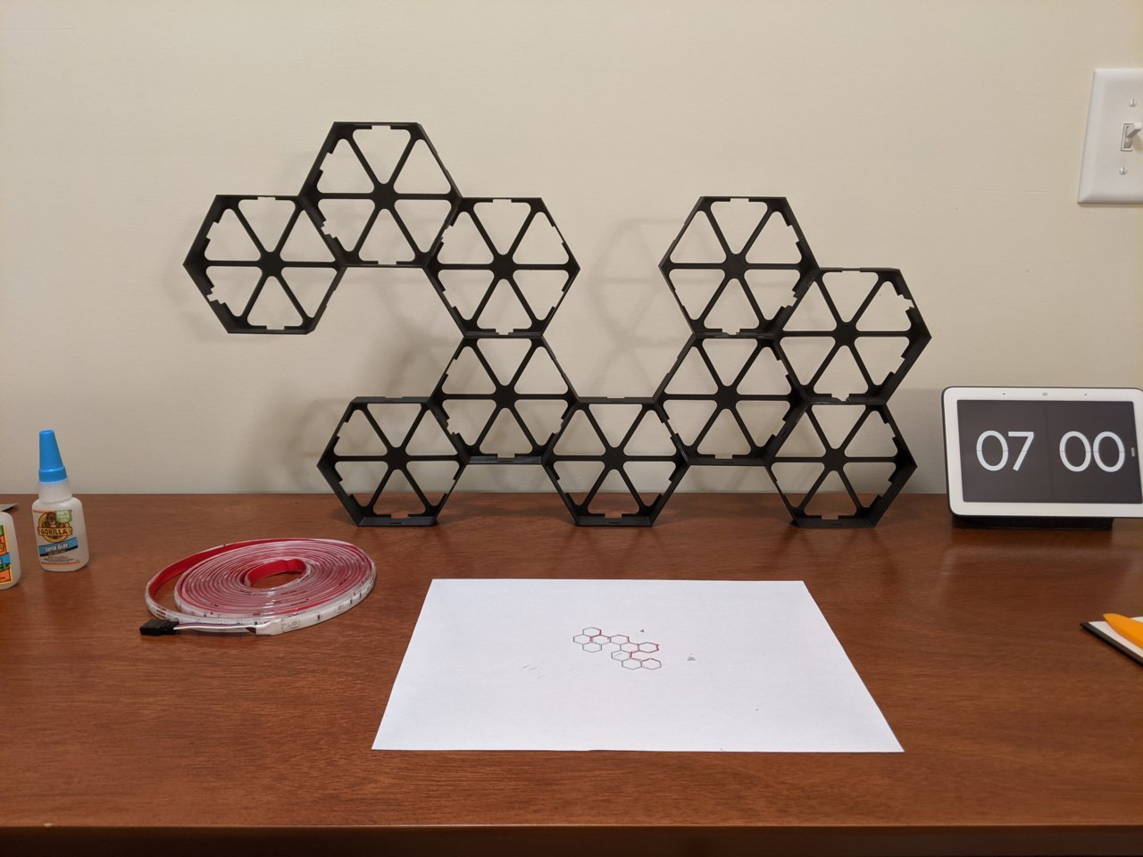

    Wanted to make a Hexaleaf.

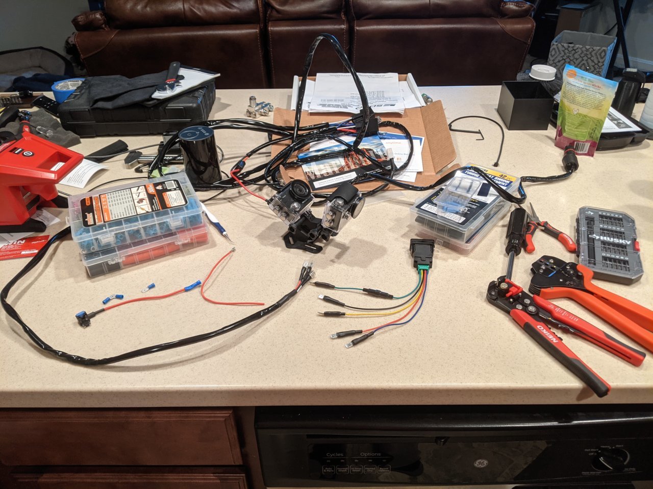

    Working on the wiring for the light bar.

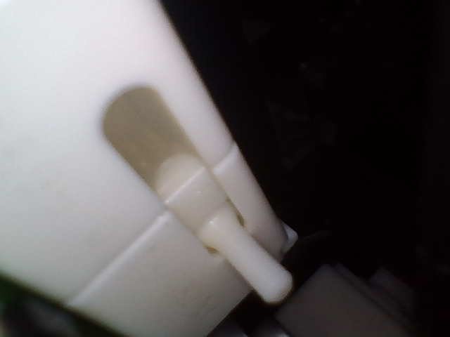

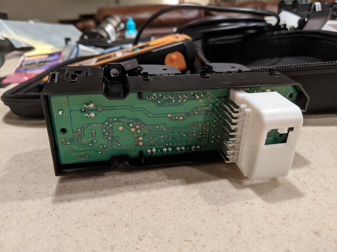

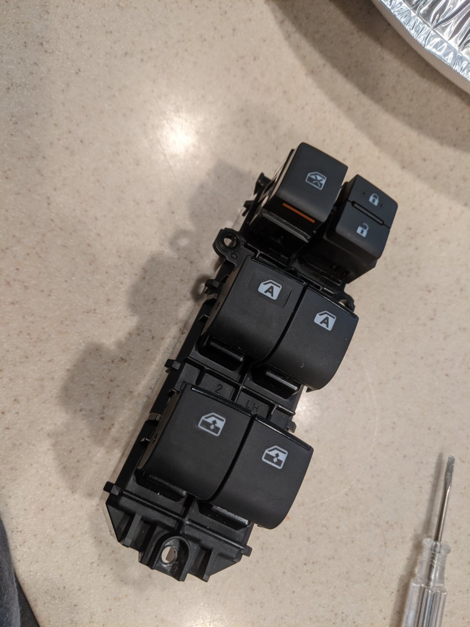

    At first I thought maybe the rattle was coming from the window lock button. I tried to open it, but even after releasing the tabs, the button itself was stuck to the PCB. I gave up. When I put it back the Driver Side Window stopped working. I noticed that it would only click up once, but wouldn't physically do the second click for the auto close. Passenger side still worked fine. Got out the endoscope and found if the switch isn't centered it locks the finger switch. So I slid it back to the center and it worked again.

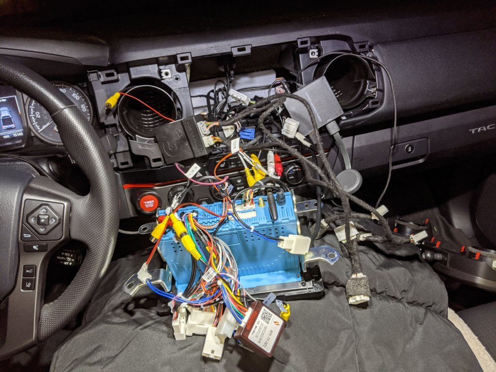

    Well this happened.
    It's the one from CTH.
    https://cartrimhome.com/head-unit-for-Tacoma-2016
    I'll report back with how it works. So far everything seems great. Scored it for $330. Ended up having to take out the Germes RFCC. Doesn't work with it. So I lose the Mode buttom for front/rear camera, but the head unit has it built it, I just tap the icons.
    Sound wise, I think I heard things I haven't heard before. Only got to test it quick with Youtube.
    Re-formatting my USB Drive and we'll see.
    I want to grab the oem microphone and oem gps adapters. Then everything will be hooked up.
