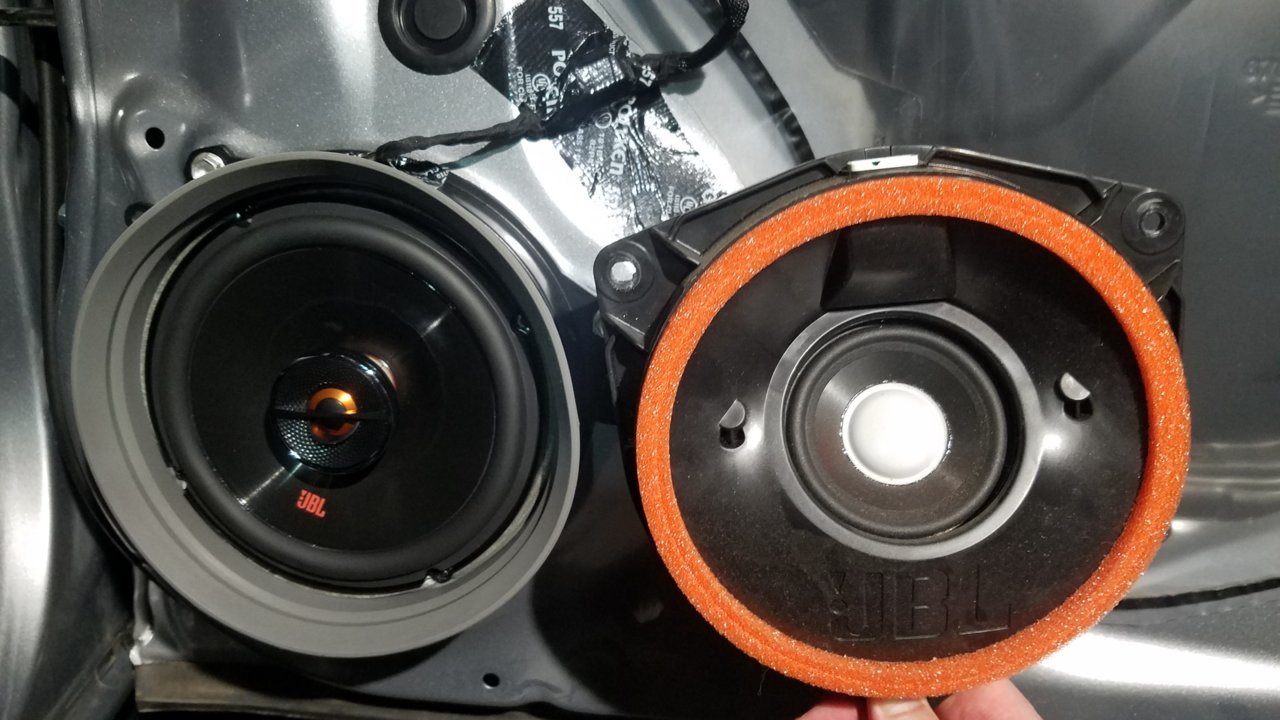

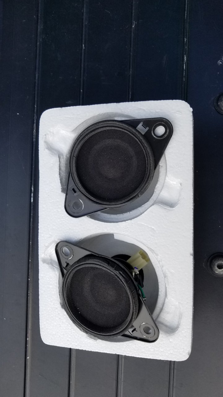

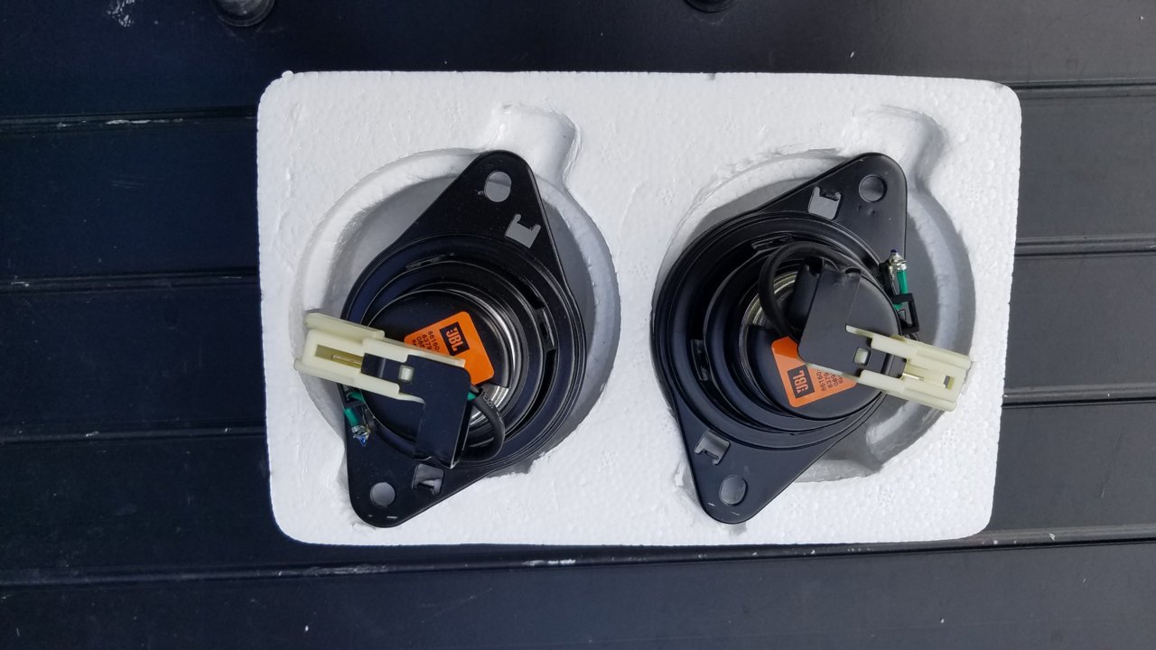

    Pretty much. Here's what the stock JBL tweeters look like:
    AwesomeLaw68[QUOTED] likes this.

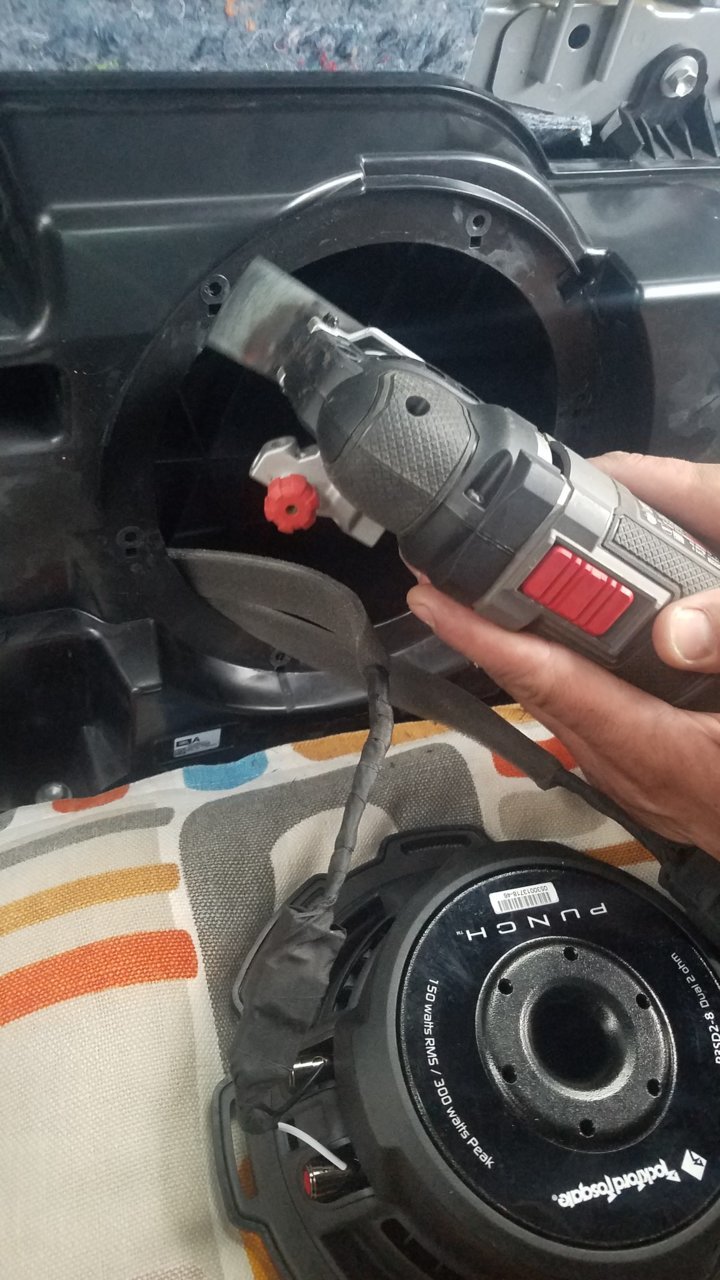

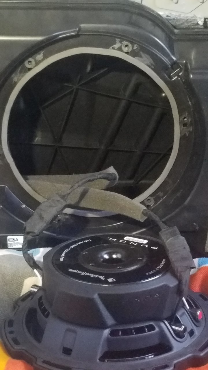

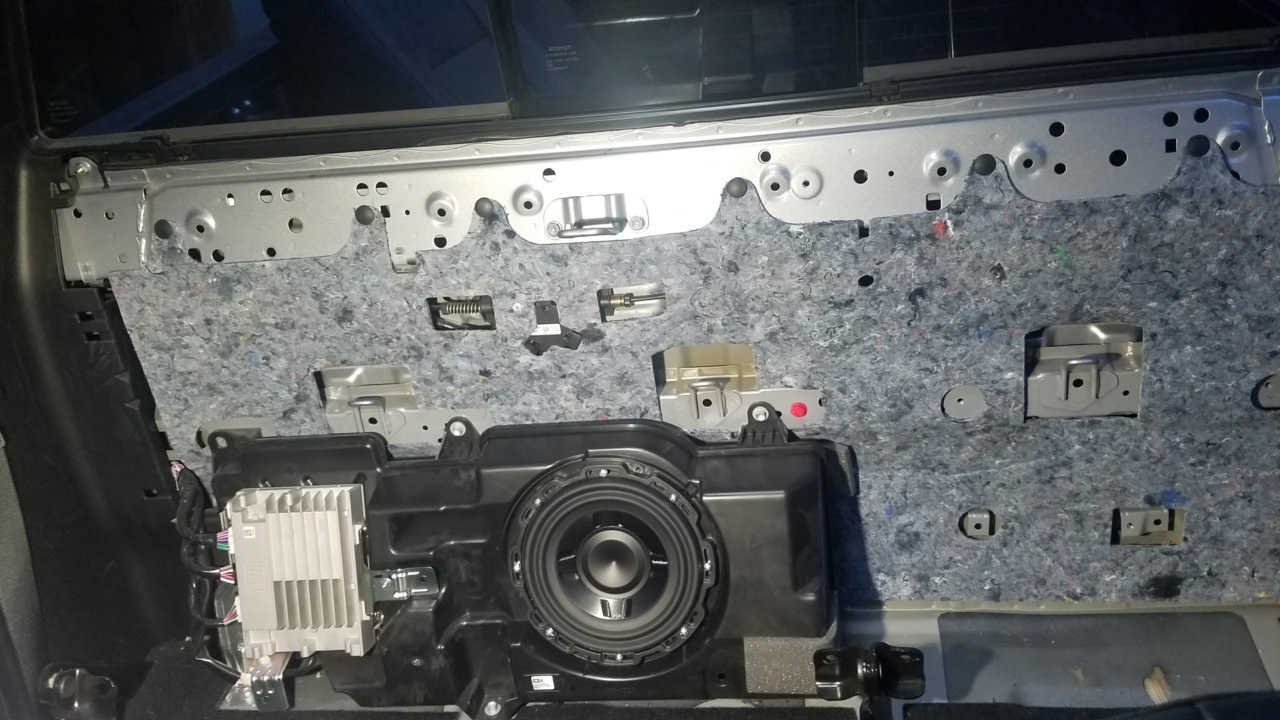

    With the DSP amp and a Polk Audio 8" sub, it almost seems like its a 10" sub. I put the Polk Audio sub in the stock housing and covered the stock plastic box with antivibration.

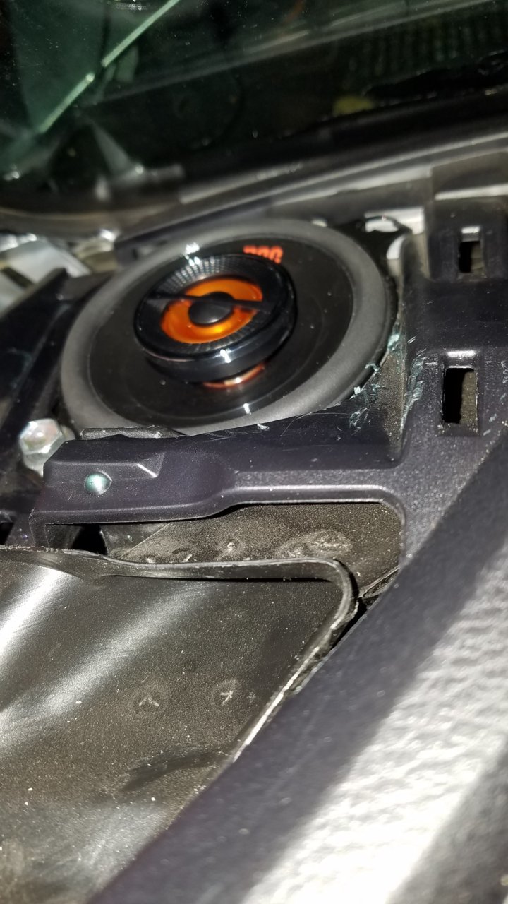

    what did you trim the dash tweeter holes with? I just finally got around to it and realized some trimming is required.

    Just a clean razor blade knife. :thumbsup: GL!

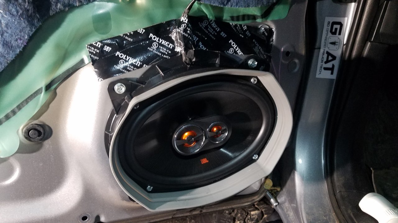

    I've done everything on your list except the front doors. I'm looking for a 6x9 and everything seems to be disconntinued or out of stock.
    I'd prefer to not have to buy an expensive kit and then only use the 6x9's, which has been my delay so far. Would the
    JBL Club 9632 be a reasonable alternative or does anyone have a decent source for the JBL or Infinity previously referenced?

    The problem with the JBL Club 9632 is that they are not a sealed 6x9 subwoofer, and that they have mid and high speakers. JBL dedicates the door to a woofer without any frequency for mids or tweets. I tried the JBL club 9632 speaker, but it lacked so much that I thought there was something wrong with my stereo. :notsure: That's a big NO for me.
    Amazon is listing the JBL components at $200. (I'd get the JBL over the Infinity because they don't have the copper trim. In the future, I'd like to piggyback off my dash speakers to install tweeters in the sail fin panel on the door, with the inline crossover before the tweeter.)
    You might try something like this or this (< you'll need to buy two) as an alternative (verify 2 ohms). :notsure: Although, just by looking at the magnets on the back, the JBLs seem far superior. GL!
