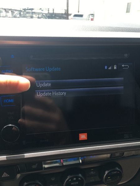

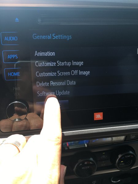

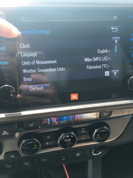

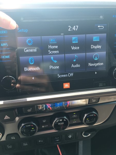

    It's not difficult to update Entune. Connect your device via a USB cable, open the Entune app the go to the settings on your radio.
    Once you press Update if there's an update avalaible it will say so at the bottom right of the screen.
    Apps-> setup -> general -> (scroll down to) software update-> update-> Update Software (if avalaible)
