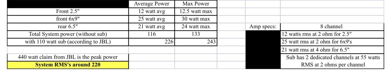

    Does anyone happen to know what the ohm rating of the JBL system's amp is?
