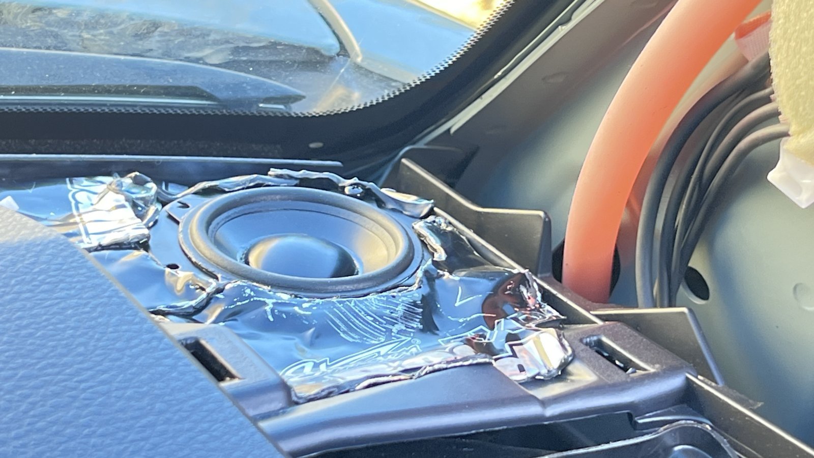

    Highs and clarity most of all, it does sound better. It took me a couple hours to do it, but I like them. I also did the rockford 8" sub upgrade and have some Infinity 6x9 mids coming for the doors. If you don't mind cutting stuff up and have patience, I'd recommend the upgrade.

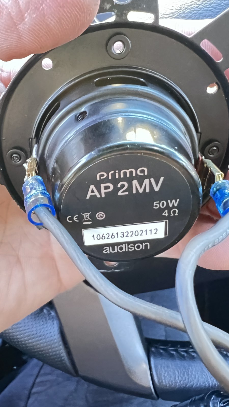

    Audison Prima 2.5 speaker I run this with the factory JBL as a drop in and play and can also add an amp to bring them alive if your willing to to go that route no need to cut or trim the dashboard. Under $200 price not a bad option at all
    For the audiophiles the next and best option is the Focal M 3 inch with very little trimming for $600 per speaker
    I’m guessing that’s going to be my next move but you must have an amp with DSP for this option

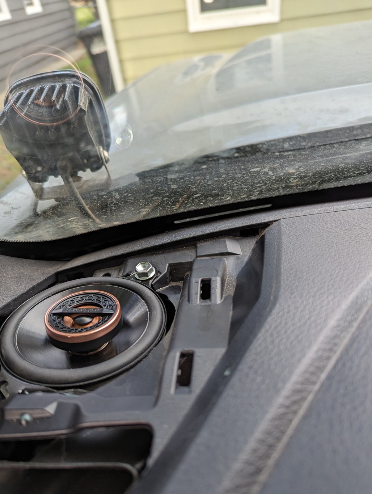

    This is awesome. I installed 3ohm Infinity 307F speakers and they sound amazing. Thanks for the write up.PXL_20240531_234924425.jpg
