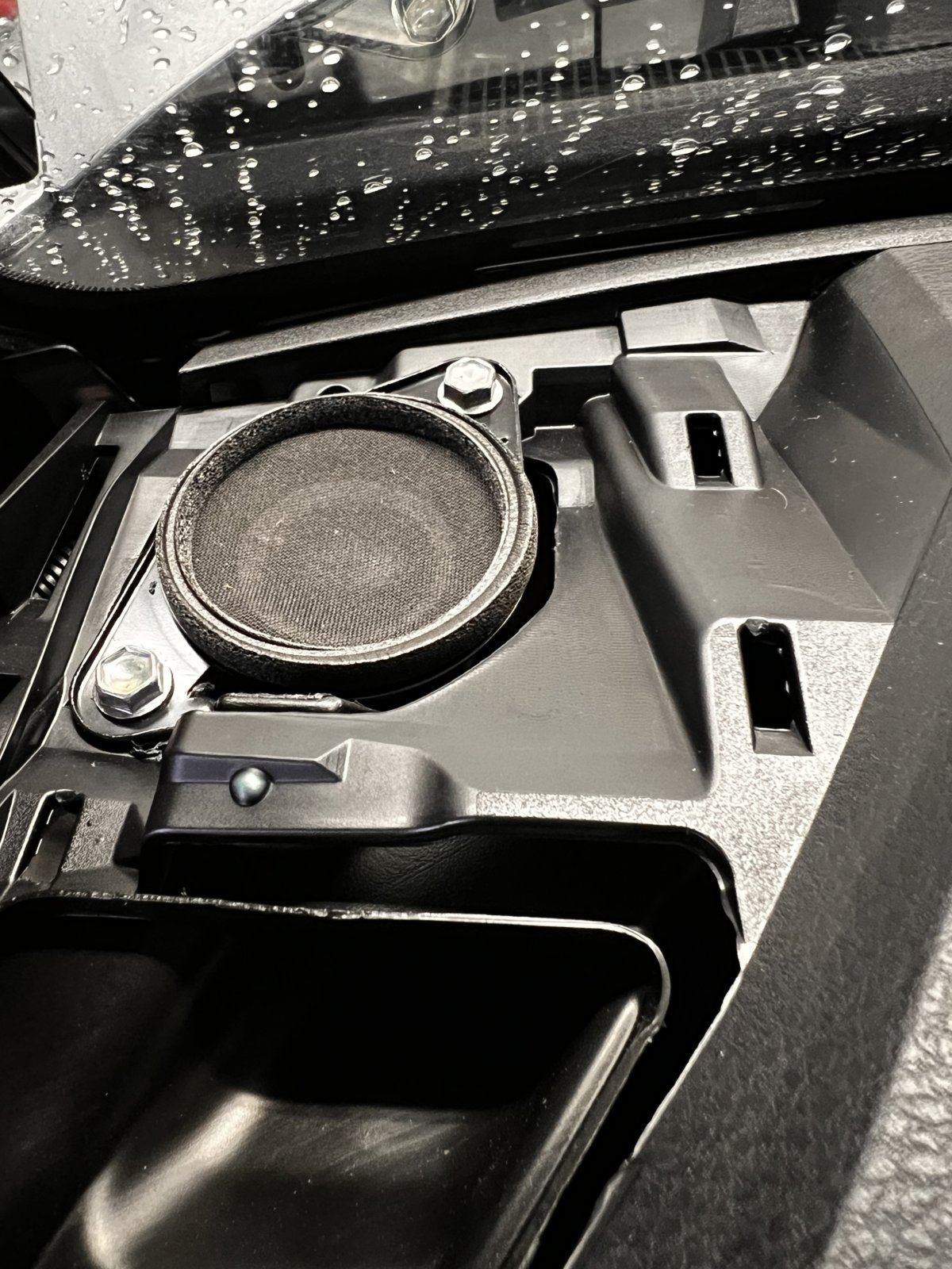

    @RxYoda I just realized the GX328s are coaxial speakers, not dedicated tweeters. How did that sound after just replacing those? Never saw anyone else do this before.
    Also, reading reviews on Amazon people are mentioning trimming of the tweeter area and some suggested using "Red Wolf Wiring Harness" to plug into the factory wiring.

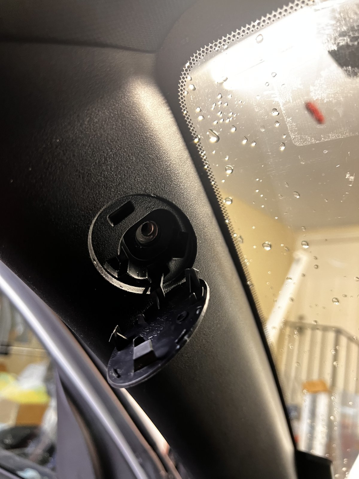

    Can you expand on the trimming (any pics)? And did you use the red wolf harness or did you make your own connections?

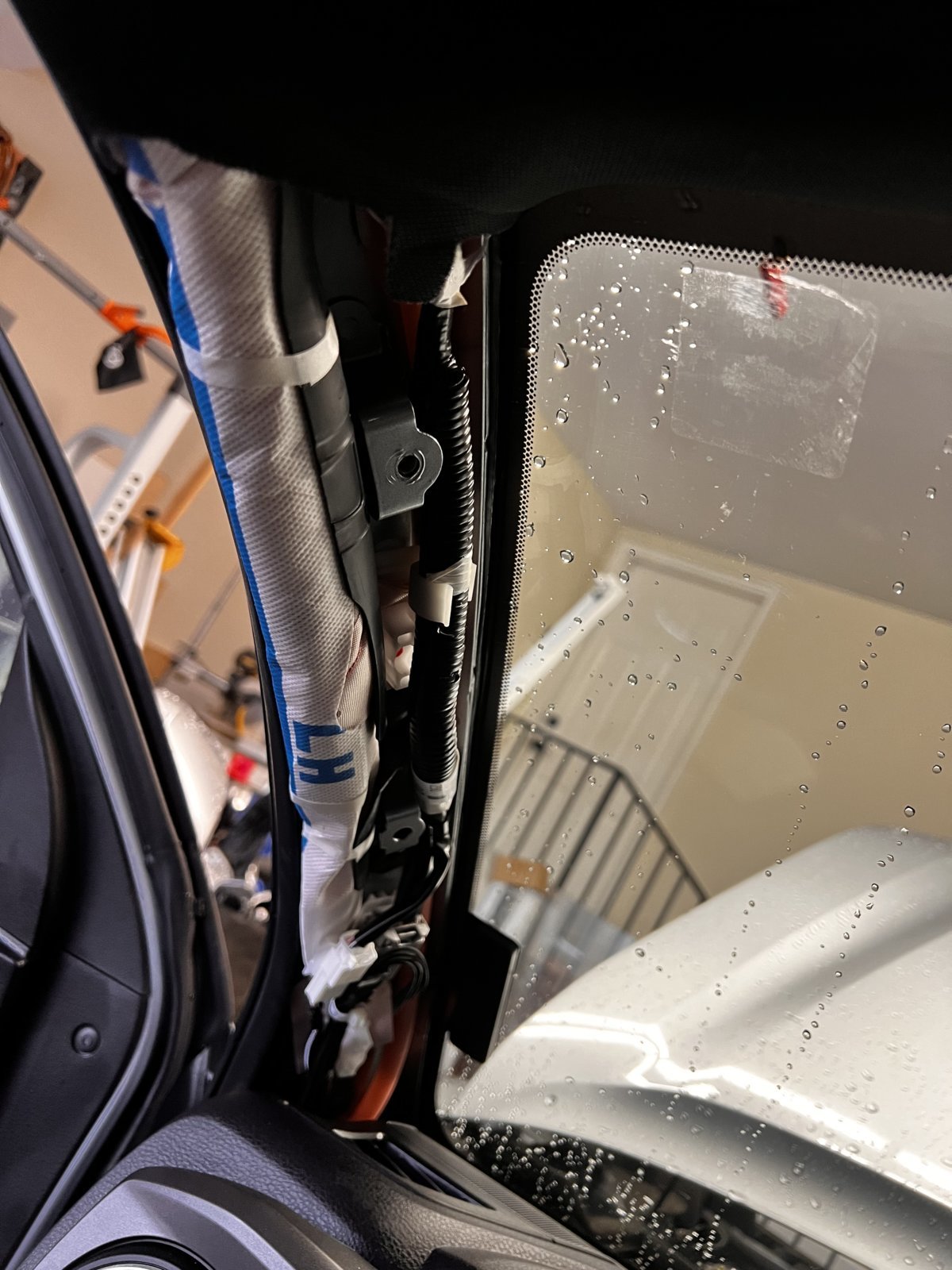

    And yet another edit: Did you have to remove the pillars to remove the grill covers for the tweeters? I had read that they have to be removed, but now I am reading some others posts that also used the GX328s and they say they did not have to remove the pillars.

    Yes, the pillar has tabs that fit into the speaker grill, if I remember correctly.

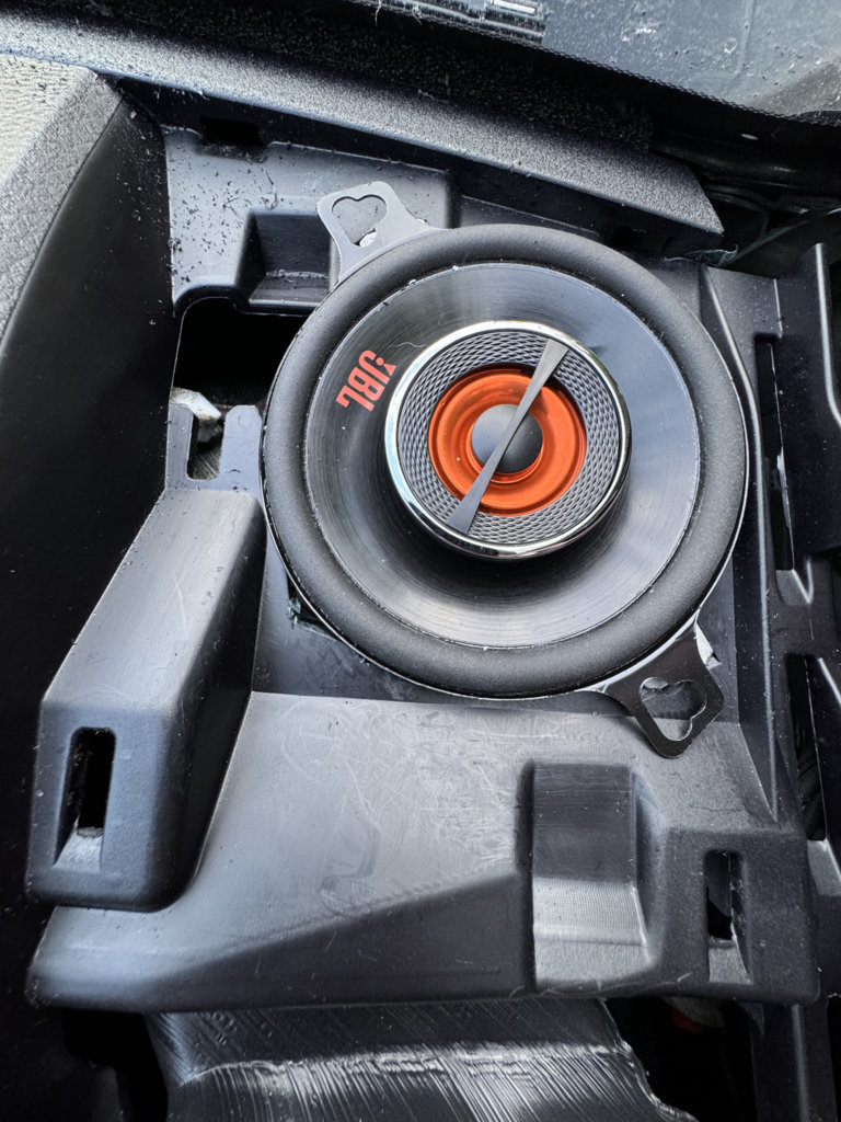

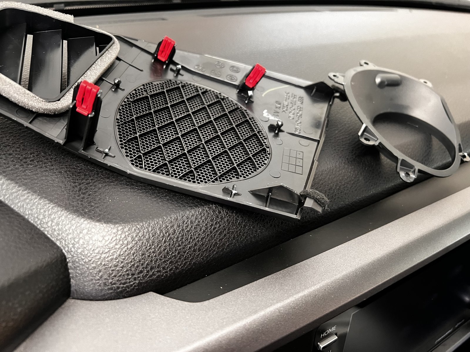

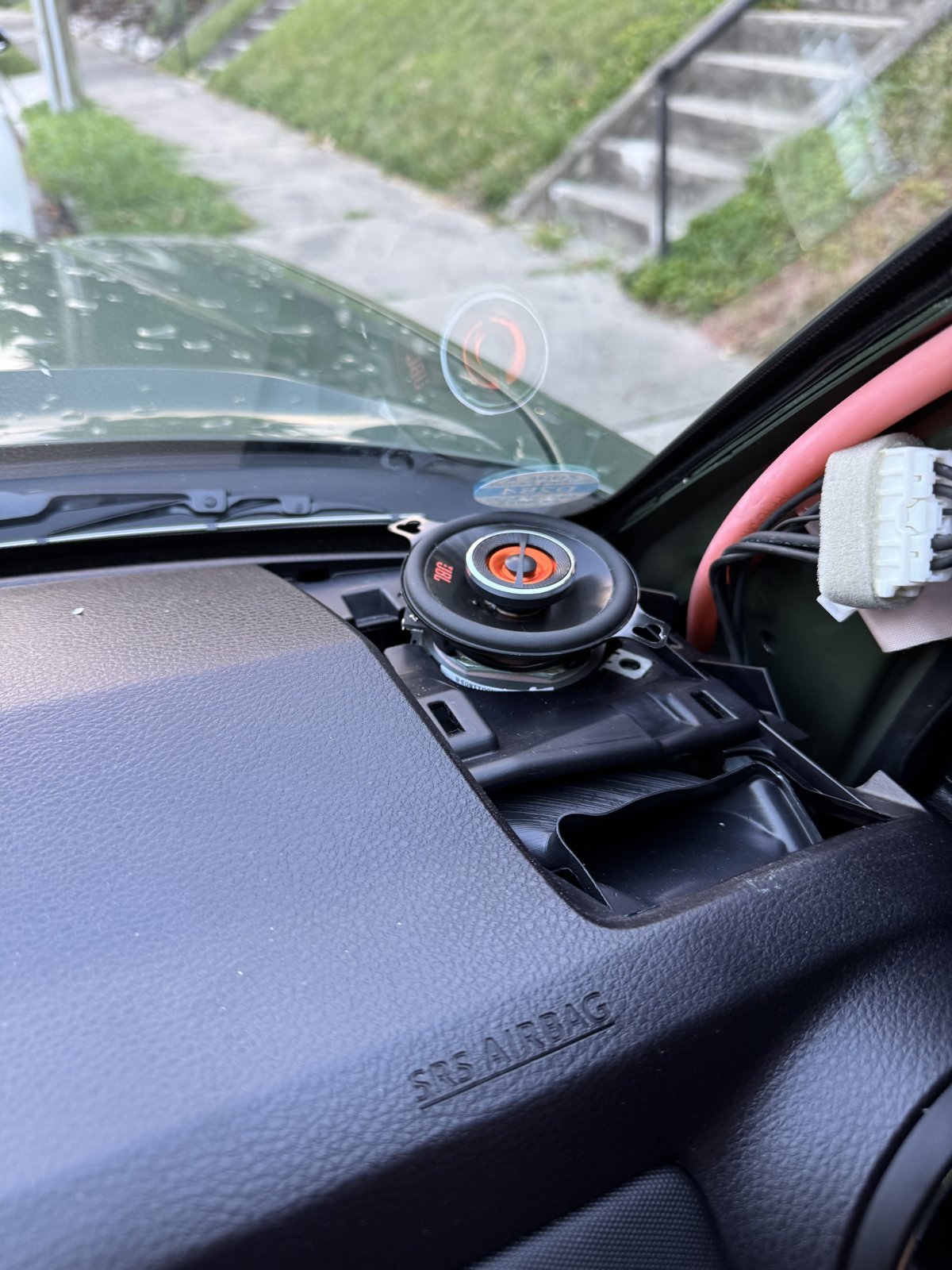

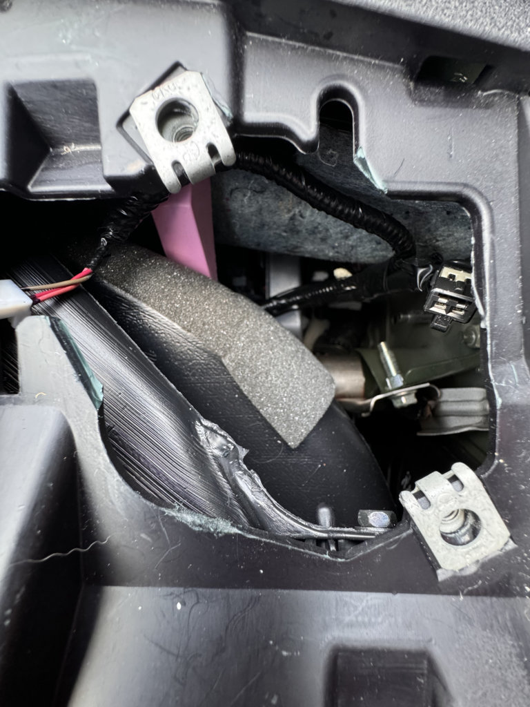

    Don’t have pics of the trimming. I took the coax, put it face down on a piece of cardboard and made a template, then used a dremel tool and box cutter to trim out about 1/2in on one side.
    Crutchfield will give you the harness and instructions for wiring. Same price as Amazon with better customer service. Not sure if a referral will get you a discount but I’ll look.
    I also packed sound deadening foam down in the pocket under the dash speakers.

    1. Did you disconnect battery since you were touching the pillars with the airbags? I've red some people do that to be safe. No idea if it is needed or not.

    I did not disconnect the battery I was no where near the connectors. Not a terrible idea though especially if you dare a little nervous/cautious.

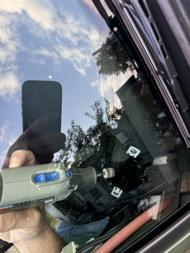

    Am I crazy? I don't see how these would fit. What's the trick?
    Even if I Dremel out the corner nearest the stadio.. the mounting holes don't line up.

    In the details of the thread (and a few others I found) they all say they had to enlarge the opening with a dremel or sharp box cutter. And then you can use one of the previous mounts to secure one side of the speaker but them use a self tapping screw on the other since the second one doesn't line up.
    Once you do the cutting and get it installed, the stock grill cover will reinstall over it without any problem.
    Search for this speaker and review this thread. There are a handful of pictures and explanations. One person even said they just secured it with one screw and left the second one usecured. Does offroading and hasn't had any issues even with the jarring. I think I am going to buy a pair of these in the fall with cooler weather and give this a try, but plan to secure both sides!

    Anyone have reservations about cutting into the dash? I know it can't be seen but I'm always weird about irreversible changes to the car. I'm sure someone here has a different view about it I can gain from.

    I've done it on another vehicle. As long as you are careful and don't cut into anything needed to attach the new speakers, reinstall the grill cover, or the pillar trim you should be fine. Like you said, it will be covered.
    For me, I get more worried about removing the trim pieces and breaking a clip or it not going back together right. On my last vehicle the A pillar trim pieces comes loose occasionally because I messed it up upon removal.

    I did it. It was a beast. The vent chute on the right side was in the way for me big time.. created a problem. It's a really difficult area to work in too, you can't get an angle at things, and it's impossible to fit a standard Dremel 4000 down there in any sort of way that would help. Maybe if you had a 90 degree die grinder, that would work better.
