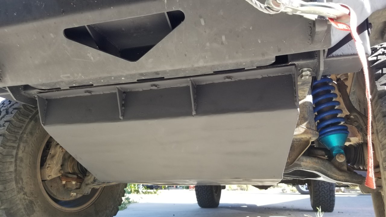

    thought you have been saying that CA was a rust free location
    stay safe, stay home yada yada
    what a clusterfck you must live in, its all over the news here!
    nice custom skid :hattip:

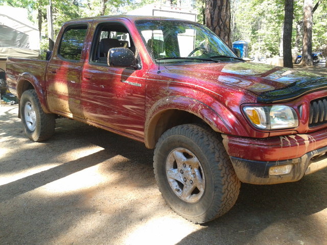

    What are you on about? That brown stuff is dirt.

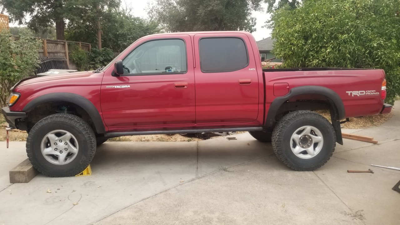

    More toys are on the way. Just ordered my J59s (a long time coming), so I'll finally be able to put these sad leafs to pasture.
    (and mind you: this pic is from 2011...) :anonymous:

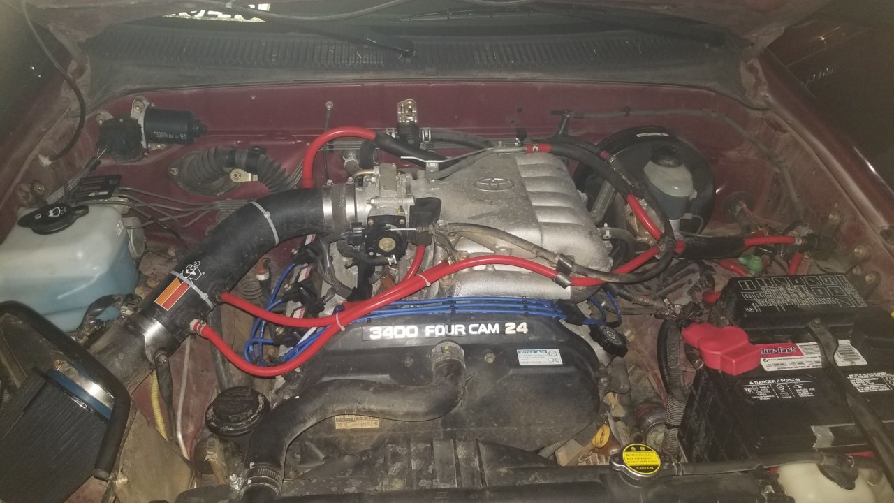

    Also did some engine maintenance.
    Silicon vacuum lines and plugs/wires
    Note I did not choose the red color. They were back ordered on the black... and I'm impatient.

    Old ones look so sad. They should be.

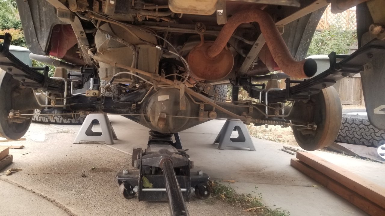

    Things went together pretty smoothly. Only problem was I didn't lift the rear of the frame off the ground high enough, and my jack wouldn't go low enough to fit the axle housing under the new springs.
    Now they're *almost* weight supporting. Ran out of daylight before I could get everything torqued down.
    Next step will be cranking the Kings back up to level it out. Or I can just stinkbug it for a while...
    I was going to take some time to clean the axle housing and make it all look purdy, but then I said F it and just wanted to get it together. A little dirt don't hurt.
    I haven't broken it to the wife yet that one of my 5100s was leaking oil, so I'll be in the market for new shocks, too... Probably just stick with 5100s for now. Blew my budget on the Deavers...

    It's actually not as bad as I thought it'd be.
    It's a hair over 3" higher than before, measuring from the ground to fender flairs. Definitely hope it comes back to the 1.5" as advertised. Need to raise the Kings in front, too.
    If not, I guess Ill have to take a year or so to build a rear swingout and throw an rtt on it. :anonymous:
    Kwikvette[QUOTED] likes this.

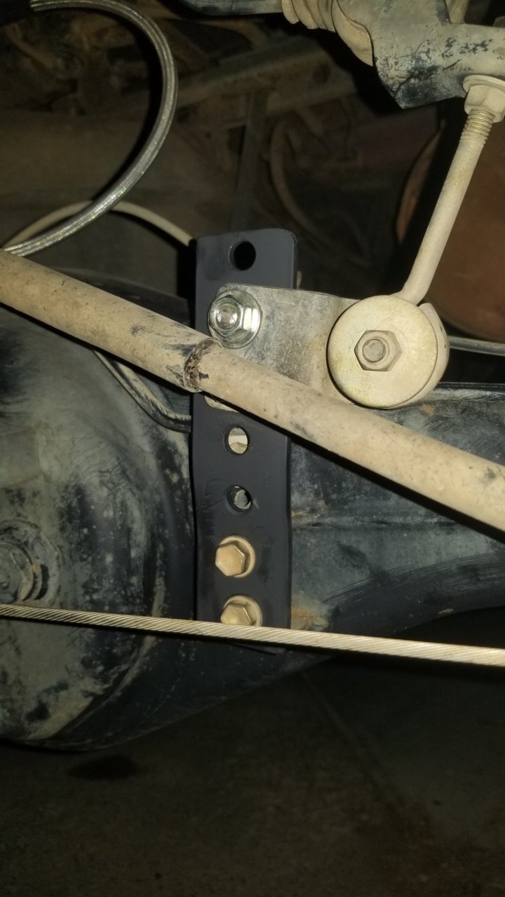

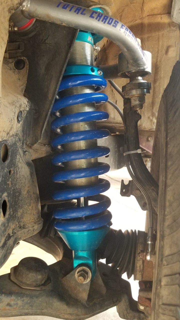

    Got the fronts adjusted today, and installed the braided lines;
    I went up (or is it down?) 3/4" on the shocks, which was right 1.5" at the wheel.
    Made a custom BPV bracket. Cost me I $0 (piece of scrap I had laying around). You can't really see it, but it's offset slightly to clear the hard line that runs behind it.
    I just need to play around with it a little, but I'm not worrying too much until the springs settle in.
    Final verdict: Well sort of, I'm assuming the rear will settle about an inch.

    How many threads do you have exposed on your King fronts?

    I had to zoom in my my pic to count: Looks like 17.
    I had always heard that the shock travel to wheel travel was about 2:1, but I took a few measurements to confirm. I measured the hub/fender distance, then measured the shock length. Then I lowered the wheel 1.5" with the jack, and measured the shock again and took the difference. It was right at 3/4". So yeah, 2:1... who knew!
    I had to take the shocks off to adjust them. I made a little tool out of some angle iron to hold the shock in place in a vice making that a lot easier. I put a piece of tape at the top of the collar then just twisted until I had 3/4". I didn't count turns or anything.
    My truck has always sat pretty level (rrt taco lean), so I just adjusted both shocks identically.
    I guess I'll break my springs in at Moab, lol.
