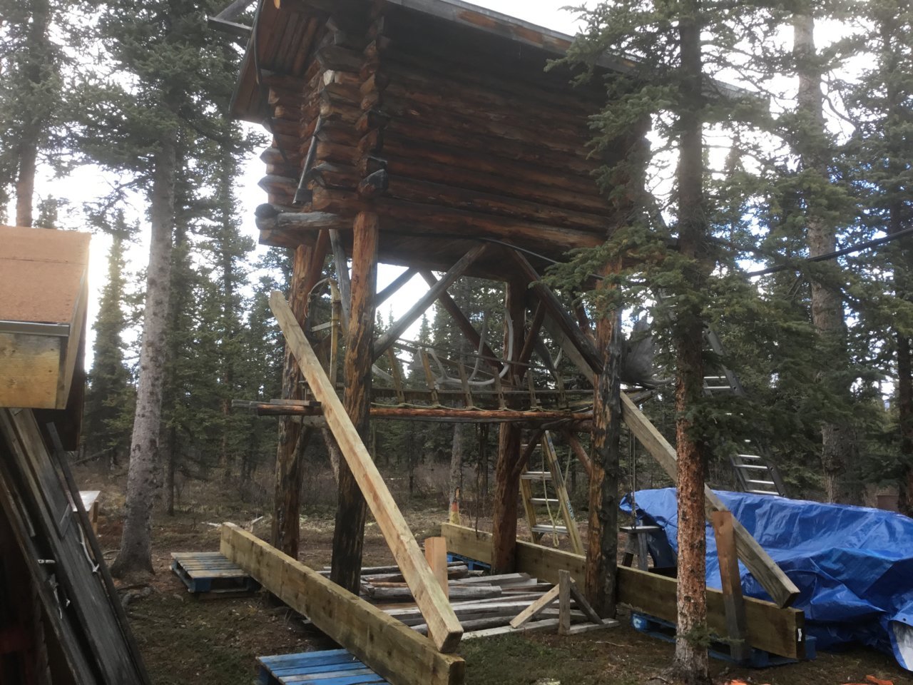

    I have a metric butt ton of stuff I need to do up at my cabin up north, that just got rescheduled till next summer now: new legs for the cache:B259A07A-CE26-4B80-8D3A-B2FB2A62ACB4.jpg

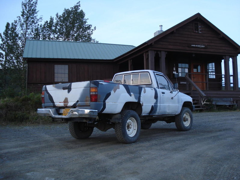

    and a new engine in the 85’ so it’s always something:
