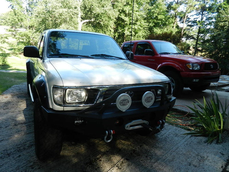

    What's this called? I'm picking my winch up from 4wheel today, would be nice to have this setup too!

    It is the female plug on your wench and the cable for the remote. They can look it up for you, they did for me. I think it cost less then $20 for both

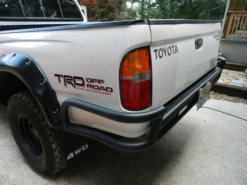

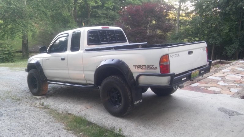

    This showed up today!!!
    Trail Gear Rock Defense Rear Bumper

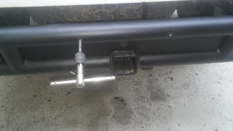

  7. May 17, 2016 at 8:54 PM
    #87
    JBTacoma
    JBTacoma [OP] Well-Known Member
    Feb 16, 2015
    #148844
    11,118
    Jeff
    Cullman Alabama
    2000 SR5, 2003 Double Cab and a Suzuki Samurai

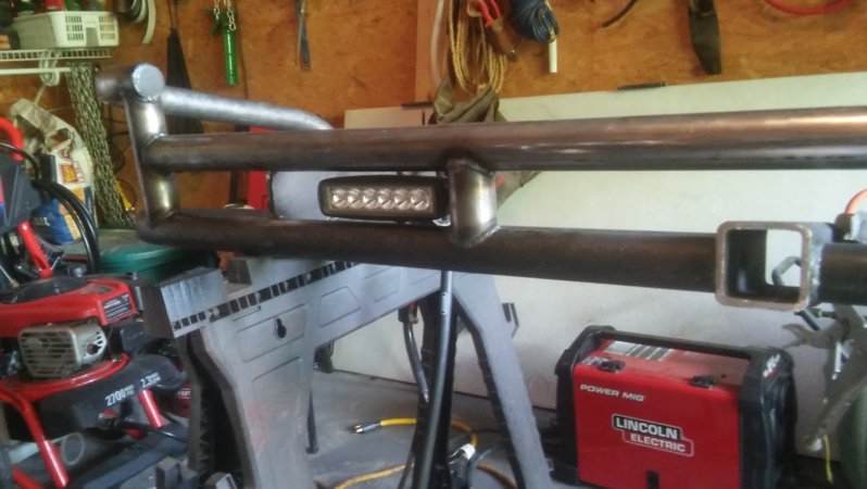

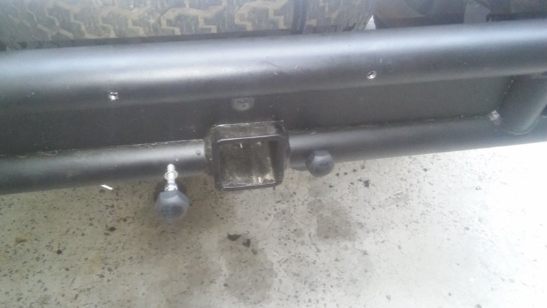

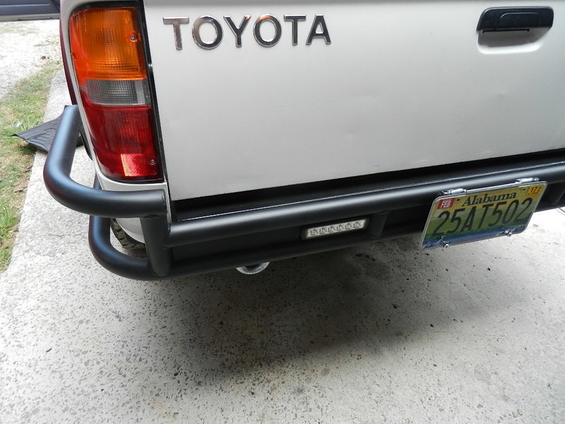

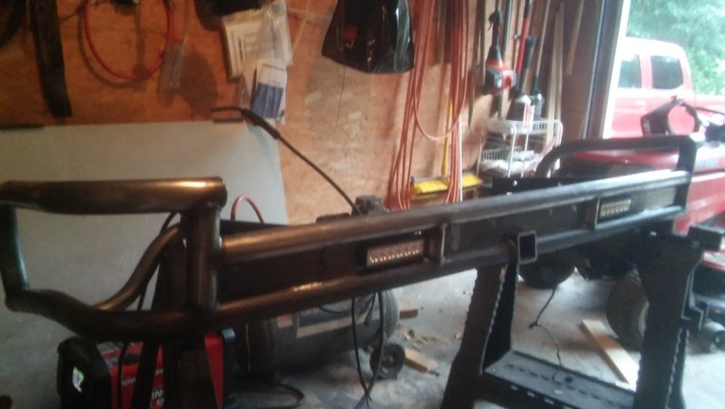

    Got my backup lights mounted
    and install some fill panels between the pipes.
    Installed a flip up tag and used some hood bump stops for it to rest against.

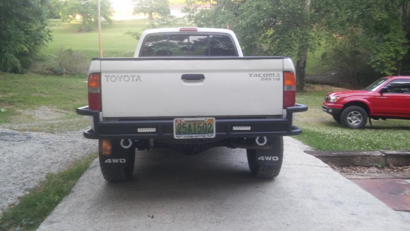

  8. May 22, 2016 at 8:55 PM
    #88
    JBTacoma
    Feb 16, 2015
    #148844
    11,118
    Jeff
    Cullman Alabama

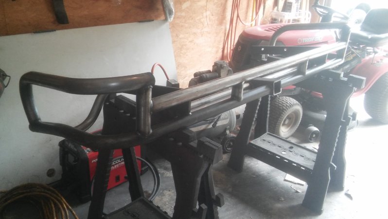

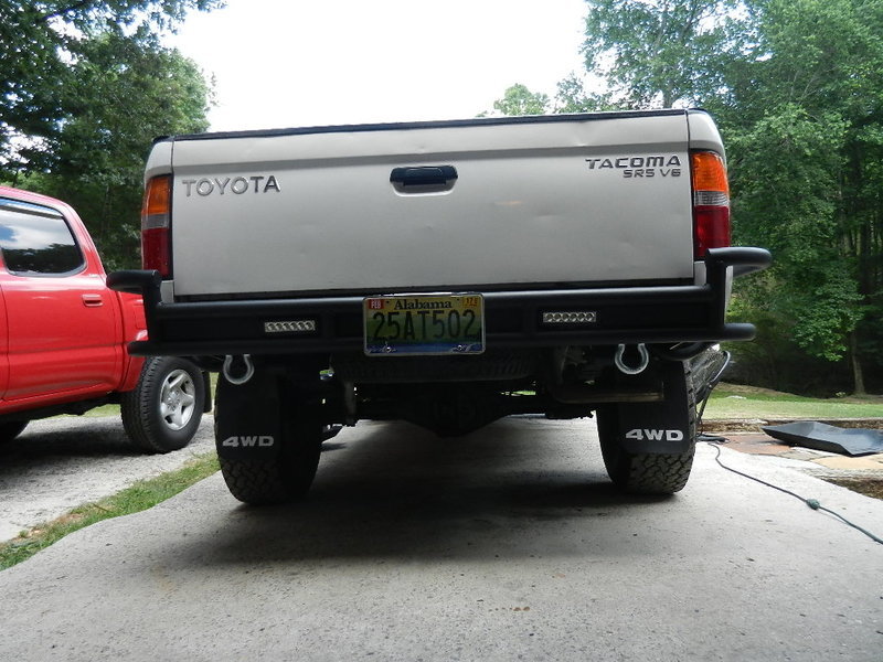

    Got the rear bumper installed today.
    Got the fill plates welded in under the tailgate.
    Silver02Taco and Trowbocop like this.

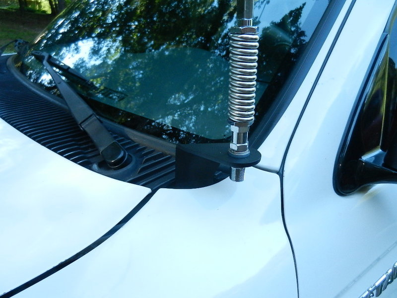

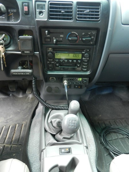

    Jeff
    Cullman Alabama

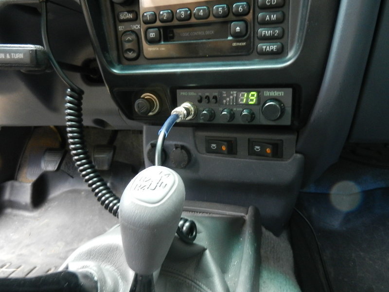

    Got my CB installed today. :bananadance:
    Fits really well.
    Got the CBI Offroad antenna bracket installed, now just need to run the cable to it.

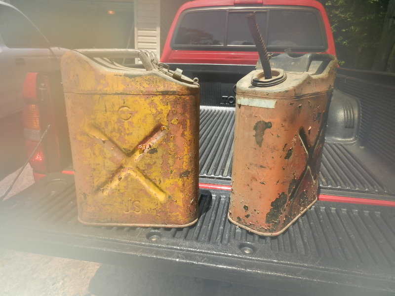

    Found these for $5 at a yard sale!
    Look new on the inside, a little sanding and paint and they will be nice cans.

    Got them finished, turned out good, total invested $30.00, not bad for 2 cans.

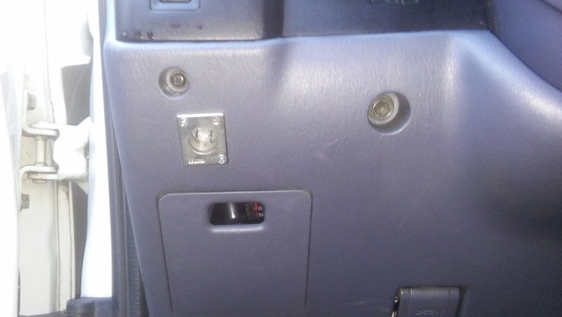

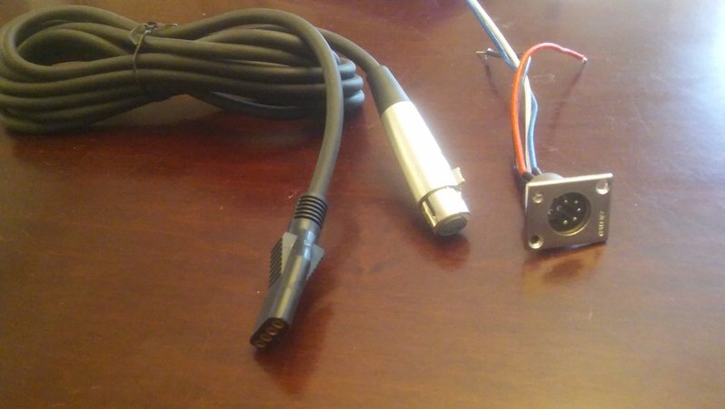

  18. Jul 13, 2016 at 4:19 AM
    #98
    JBTacoma
    Feb 16, 2015
    #148844
    11,118
    Jeff
    Cullman Alabama
    I don't have a link to the parts, I got them from 4Wheel Parts, they looked them up and ordered them for me, I believe both parts were less than $20.00. I did not have to go into the solenoid to wire this. You will need the female plug that the remote cable plugs into on the wench control box and the remote cable, both parts are pictured below.
    Disconnect your power to the winch first thing. Then I plugged the remote cable into the winch and ran the other end of the cable into the truck cab. I drilled a hole the size of the round part on the back of the female plug where I wanted to mount the female plug (pictured below). Then cut the end off the cable that I ran inside the cab from the wench and connect it to the female plug pictured above, the wires inside the remote cable were the same color as the wires on the female plug, you should use a multimeter to make sure the wires are connected correctly.
    Then just plug your other remote cable in as pictured below and enjoy.
