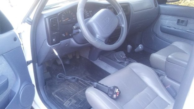

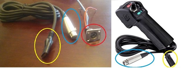

    The solenoid is located on your winch circled in red in the picture below.
    Your remote cable plugs into the solenoid female plug (circled in red below).
    You will need to buy the female plug to install in your cab. (Just the plug not the entire solenoid) and a new remote cable. Call 4wheelparts they got me the remote cable and the female plug shipped to me for less than $20
    In the picture below the male plug on the remote cable (circled in blue) will plug into you winch and run the other end of the remote cable (circled in yellow below) into the cab of your truck.
    You will cut off the remote cable plug (circled in yellow above) and connect the remote cable to the solenoid female plug (circled in red above) on mine the wires were the same color so connecting the remote cable to the female solenoid plug was simple.
    The picture below shows what the female plug installed in the cab will look like.

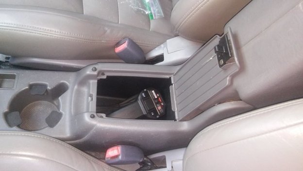

    Plug in your remote cable that came with your winch and you should be able to control the winch from inside your cab or run the cable through your window and control it from outside your truck.
    The remote and cable stores nicely in the console between the seats as seen below.

    Lol...thanks bro. I got that part. I just wanted to see how yours looks? Do you leave the solenoid pluged in all the time? I actually already have an extra female plug. All i need is another remote wire. When you get a chance can you post a pic of yours please?

    Yes it stays plugged into the solenoid, I don't have any pictures, it is inside my bumper.
    I just realized you have a tube bumper. You may not want the plug sticking out of your winch all the time. You can wire it inside the solenoid and come out the back of it using a water tight wire pass through connector, similar to the one in the link below. That way you want see the plug or wire.

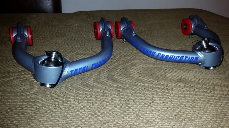

    2000 SR5, 2003 Double Cab and a Suzuki Samurai

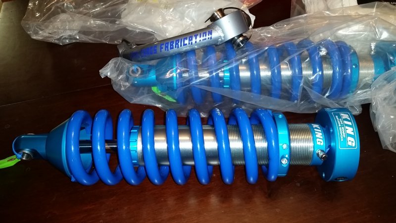

    This showed up today!!! :thumbsup::bananadance::headbang::yay:

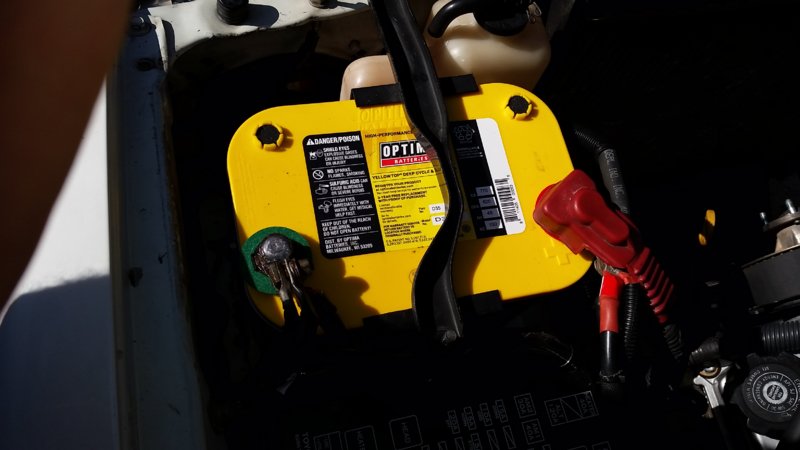

    Upgraded the battery
