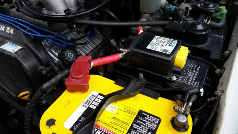

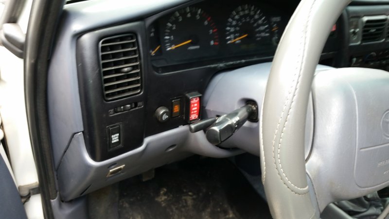

    Got the dual battery relay installed and most of the wiring ran.

    Got it all installed and it works great.

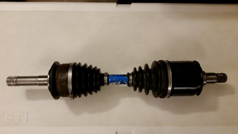

    Rebuilt both my spare CVs and did the Boot Slide Mod

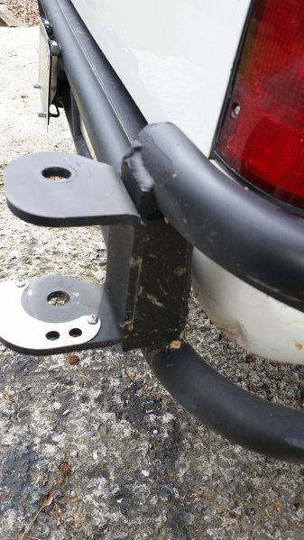

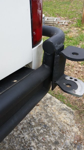

    If its not to much trouble could you post a few pics close up of the welded/attached spindle for your swingout? trying to get ideas....also did you plate the frame in the rear? Thanks!

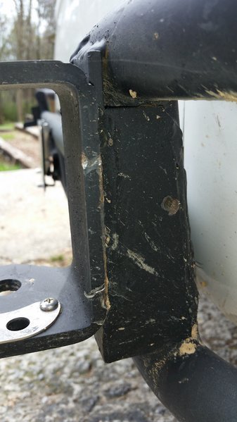

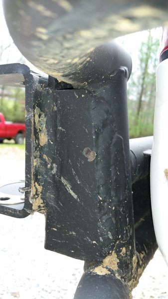

    Here are a few pictures, I welded a piece of 3 inch x 1/4 inch angle to the bumper and then welded the hinge to the angle.
    Got the hinge here: http://www.4xinnovations.com/Swing-Out-Tire-Carrier-Hinge-Assembly_p_109.html

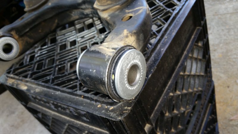

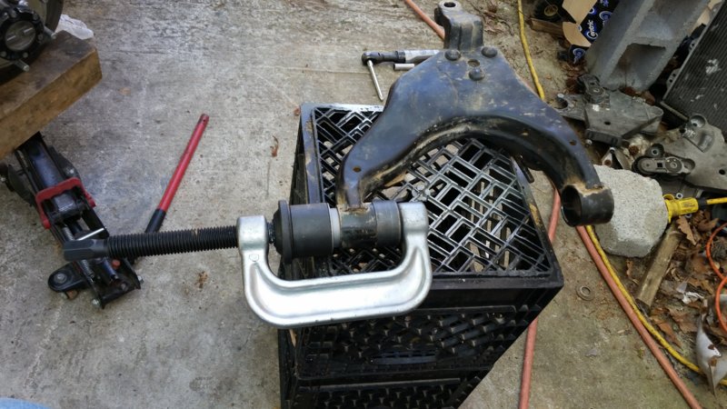

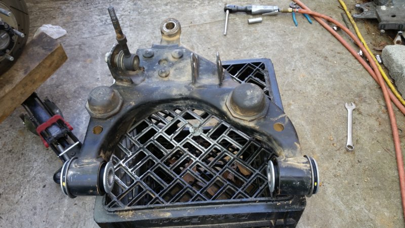

    Replaced the Lower Control Arm bushings today and all the noise is gone.

    Did you have to heat them up to press them out? I bought all new OEM bushings as well and was kinda stressing it would be a PITA to get the whole bushing and sleeve out

    2000 SR5, 2003 Double Cab and a Suzuki Samurai
    Use a bottle jack to put pressure on them and it takes very little heat for them to pop out, very easy.
    The link below is the guide I used but I did not remove the lower ball joint from the knuckle nor did I separate the outer tie rod.
    https://www.youtube.com/watch?v=kmaZNBp1gZM
