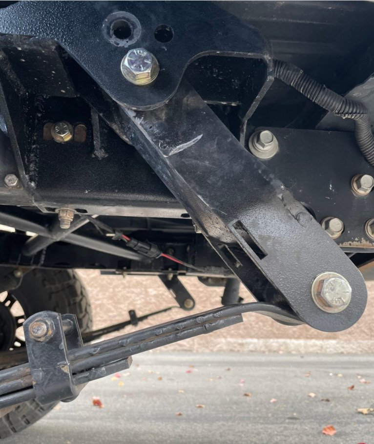

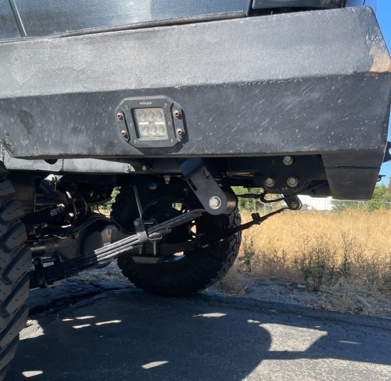

    Wish I saw this thread earlier.
    I Made a thread a few weeks back comparing exactly this. I had Dirt King hanger and shackle for SUA using Deaver H70HDs but eventually ended up fabricating my own shackle flip similar to what JD offers.
    Build thread here if interested:
    https://www.tacomaworld.com/threads/shackle-flip-design-for-sua-lt.781431/#post-28127183
    Pictures below are comparing the inverted DK hanger and shackle vs my shackle flip design with a 9" flip shackle. I just used bushings on my design but I hear JD fabs uniball within the shackle offers some good articulation.
    Shackle flip is better in my opinion, it follows the natural arch path of the leaf spring compression, higher ground clearance, and offers some adjustability with ride height and spring rates.
    JD all the way. They are the only company I know that makes a shackle flip style for LT.
    Highly considering their LT kit for the front with the pivot skid that moves your LCAs an 1" forward.
