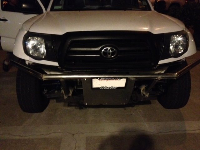

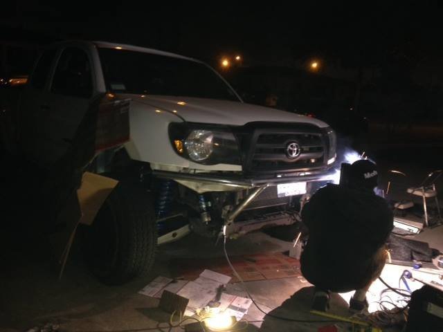

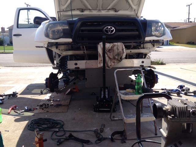

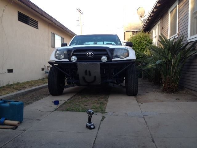

    Total Chaos 3.5" Long Travel Kit Installed and Bumper Fabricated.
    Was a little tough to install. My friend air compressor broke so we had to use hand tools and some power tools. All three of us brought tools we had and made it work.
    My drills I use for construction. (2 years old)
    Long Travel kit installed!
    10247207_1422089348076199_71929539364187_f699f3666d966b5eebf9dc8bd70e267d7d18b057.jpg
    My friend welding. We took turns welding, cutting and grinding. We used some crappy flux welder from Harbor Freight my friend had. We need a real MIG welder bad...
    10418358_1422089351409532_29266798472540_a93c2a9e4c853650f7debca696728978a475c145.jpg
    10388116_1422089408076193_49555021263537_c2f578c4fcdc5687ab9bd34a2dcf0ce6d89d73bf.jpg
    10415638_1422089381409529_22303850341421_377f8bc1d03e3dd847f21a5a3b64a127b2ffdaba.jpg
    We got some Victory tacos for dinner.
    It took us all day to finish up, that's including running around buying parts and supplies.
    So today we did our self:
    -In the morning got most of the supplies.
    -Took off the stock control arms, spindle, calibers, sway bar, ect.
    -Installed the Long Travel kit.
    -Installed the extended brake lines and tie rods.
    -Bleed the brakes.
    -Did the alignment (took a few drives around the block to get it just right)
    -Fabricated a Bumper.
    Doesn't seem like alot, but we have never done anything like this before and was alot of fun.
    Tomorrow off to Gorman , CA to hit some trails!

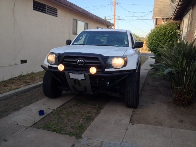

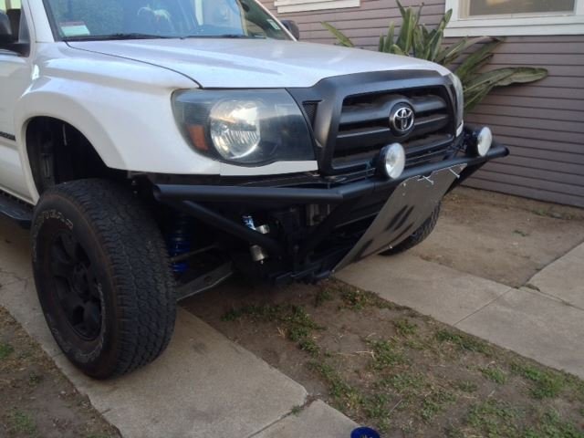

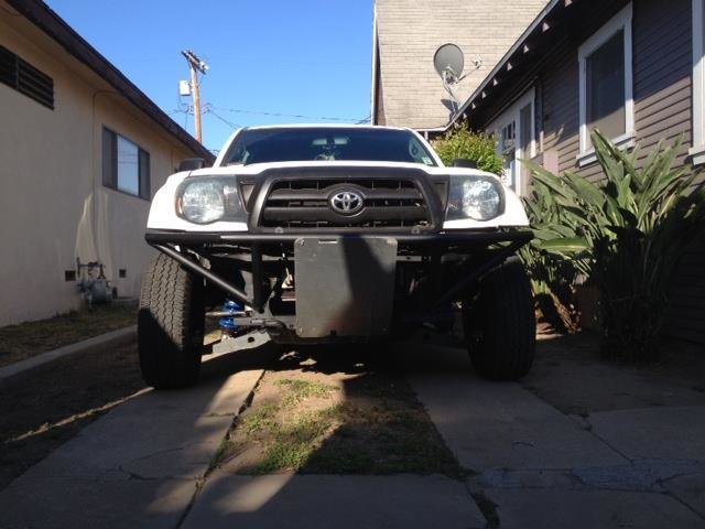

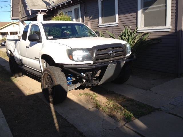

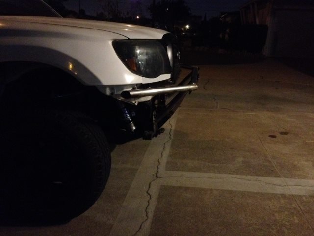

    Finished up the bumper for now.
    Added couple extra supports, fog light brackets and painted.
    10462702_1422876321330835_55164000606716_ed18df91ccf3a2cc75a9917cce415125d94f57db.jpg 10402676_1422876314664169_16098123386397_bd9879da067e7293deaeab7fbef49ef5e0034bd5.jpg
    Took the stock fog lights off the bumper and extended the stock fog light wiring to reach the new location. Not bad for free and they work lol.
    10433291_1422876374664163_65135896678144_cb965f662a9f832d30006516055259a49db32968.jpg 10440831_1422876344664166_14095791322830_448b75359a605e98aeb281187a9bf9bceada134d.jpg 10449957_1422876347997499_72697003240456_b84056426c6d7b5bbca054ff10d4898427a4f8d3.jpg

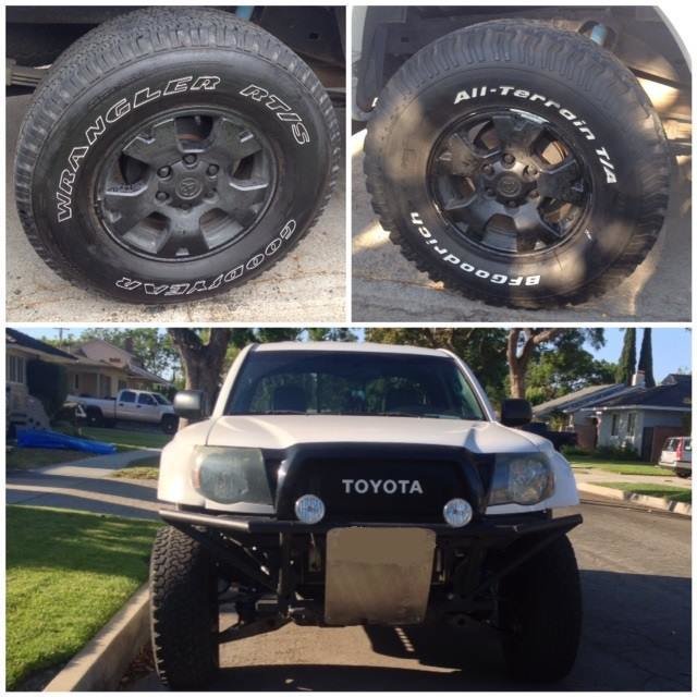

    TIRES 285/75r16
    I finally got some 285s!!!
    10524573_1441722766112857_13784064129967_8f338877ea64cde9dc613e0f8349a72ad7908ca0.jpg
    I found a guy on craigslist who bought some 285/75r16 BFGs A/T tires and they were rubbing everywhere. He said he was looking for a smaller tire and I emailed him my tires and we just met at a local tire shop and swapped tires even trade. We just payed our own fee have our tires swaped.
    Now for some wheels....

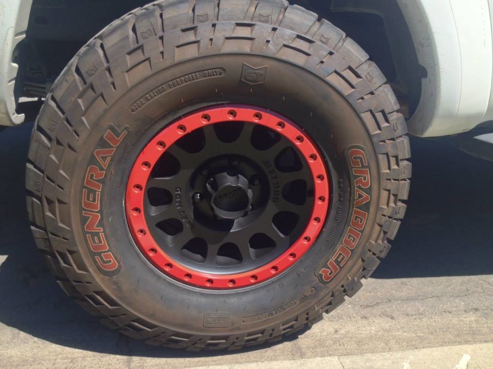

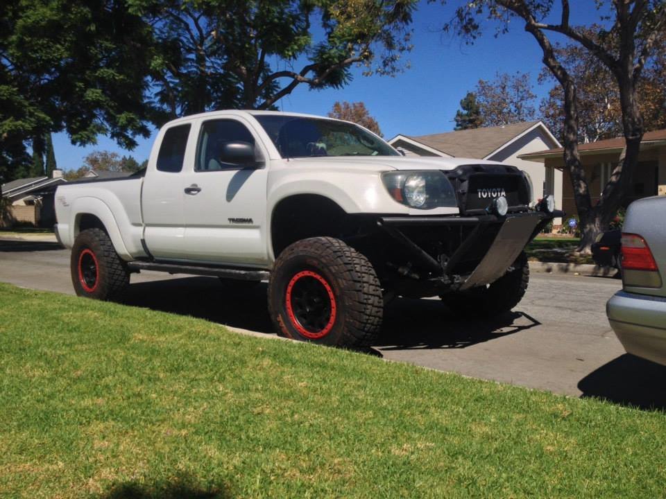

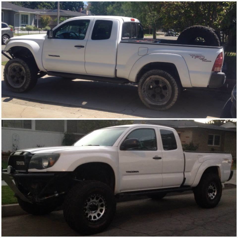

    Method Race Wheels NV 305 16" Matte Black Machined Face 6x5.5
    General Grabber Red Letters 285/75r16
    Right after I got the tires and wheels mounted and balanced
    10616077_1459069471044853_51690593759497_332d0acfed9c6d88f598c819727443b1bbca00d3.jpg
    The next morning.
    10646811_1459069497711517_18857232812975_a95c2482defd3a625f4ffaf7abd99fd6a9d65753.jpg
    Before and After
    10646969_1459069467711520_42370367923741_dfda5761286ed8f55914dce9a07e67c706b06456.jpg
    I took the TPMS out of the old wheels myself at home that was interesting...
    I put my truck on jackstands, took a tire off, got all the air out of it, unbolted the TPMS so it dropped into the tire, jacked my friends tundra up, dropped his Tundra's front tire onto my tire and popped the tires off the bead to get the TPMS out and put a normal valve stem in. After I got them all out aired them back up, the bead popped back on by it's self and drove to the tire shop.

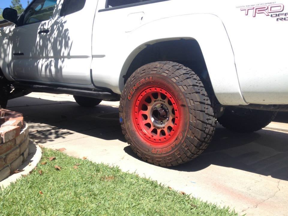

    Plasti Dipped my wheels 2 tone.
    3rd coat of red and 2 coats of Glossifier.
    10457796_1463842513900882_24952409406693_b481072d0e6a817a7ac523709a5ab8a454bbc191.jpg
    Painted the inside of the wheels black.
    Cleaned up the over spray.
    10441054_1463842553900878_21817615394711_25be92364a9c4332a396bf074e9bb7a297b72b8a.jpg
    Done.
    10606195_1463842557234211_15850464444529_f8d3784ea44c4e4a01721c1becba4e5b73d850d3.jpg
    10592966_1463842573900876_45990842293347_bc690c1c5476f8f4878abb2c0b23725abeba6345.jpg
    1521517_1463842593900874_835449741666522_6e71ca8aae3af17328c7d9677618dcec1612e4a9.jpg
    Still deciding what color to paint the bolts that go around the ring. I'm thinking gloss black.
    I got my grill cover too. Going to try to Color match it when I have some spare time.
