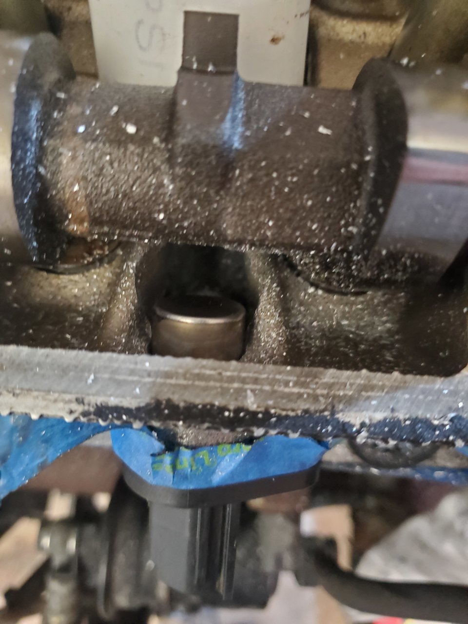

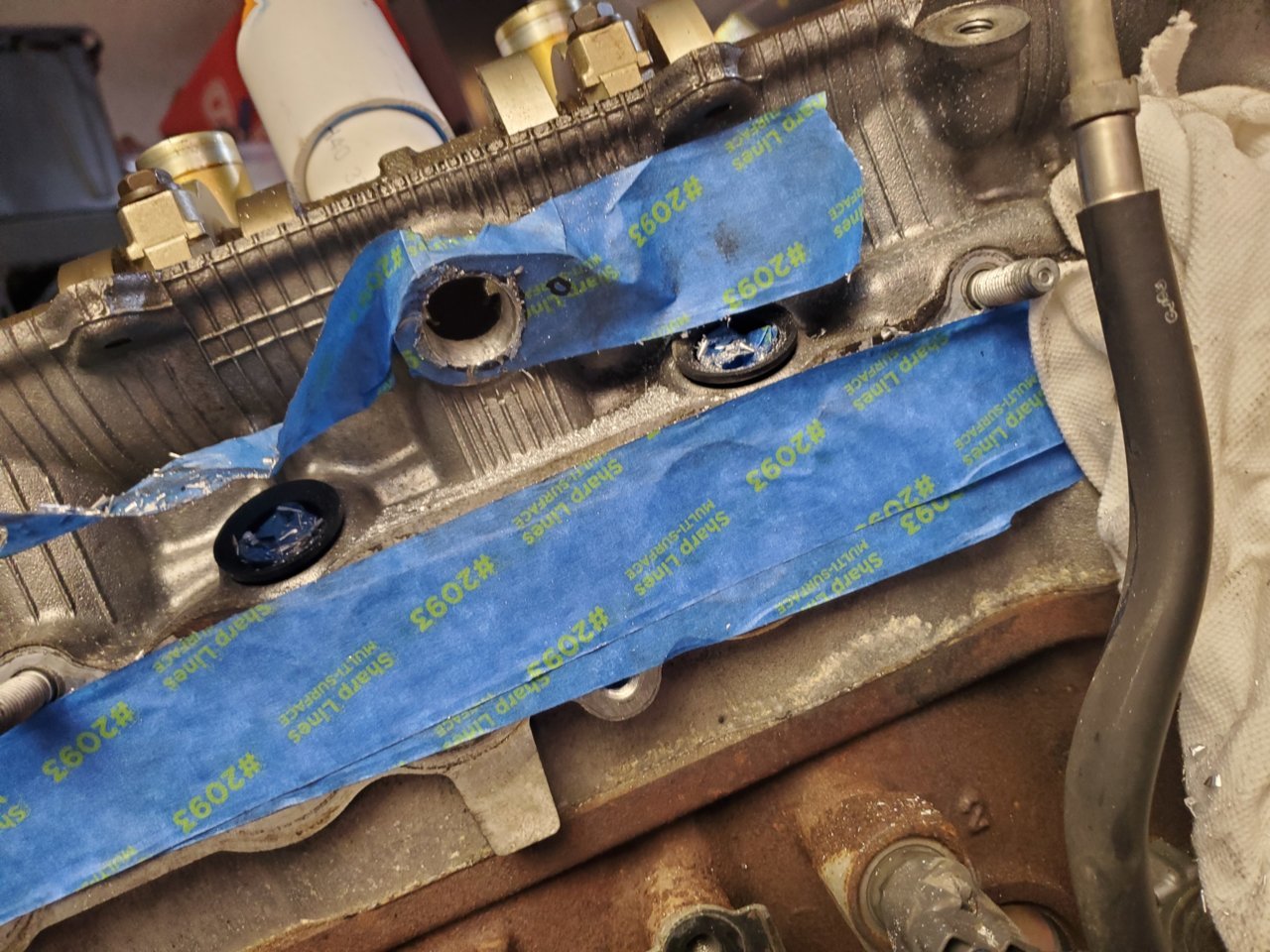

    Hey guys,
    So I decided to take a gamble and purchased a JDM 3rz Distributor type motor and covert it to Coil type.
    I was able to get the head drilled out in my garage, no special tools.
    I'm starting a new YouTube page, I'm focusing on building and fixing on a budget.

    I need to do exactly this. Is that hole for the cam sensor?

    Yes it's the one that I drilled into the Japanese 3rz motor I just got... takes about 3 hours a drill Dremel and some patience.
    If this is something you need todo right now I can talk you threw the steps and give you some raw unedited video ....
    It's going to be free on YouTube anyways . But that's 4 mouths out after we get back from taking this build to the sand dunes....
    If you can wait it will be worth it but I understand if it's a driver...

    You have to remove the valve cover, intake and injector rails... I did this on a engine stand, I recommend drilling it outside of the truck...
    Now in 1997 Toyota, made Distributor type and Coil type, you more then likely got a later engine.
    If im understanding you correctly you have a Coil type engine and you need a Distributor type?
    If that's the case the sensor can just be left unplugged.
    You have to time the engine to the Distributor, if you don't have one I have the old Distributor you can have.
    If this didn't answer your question can you send a photo.
