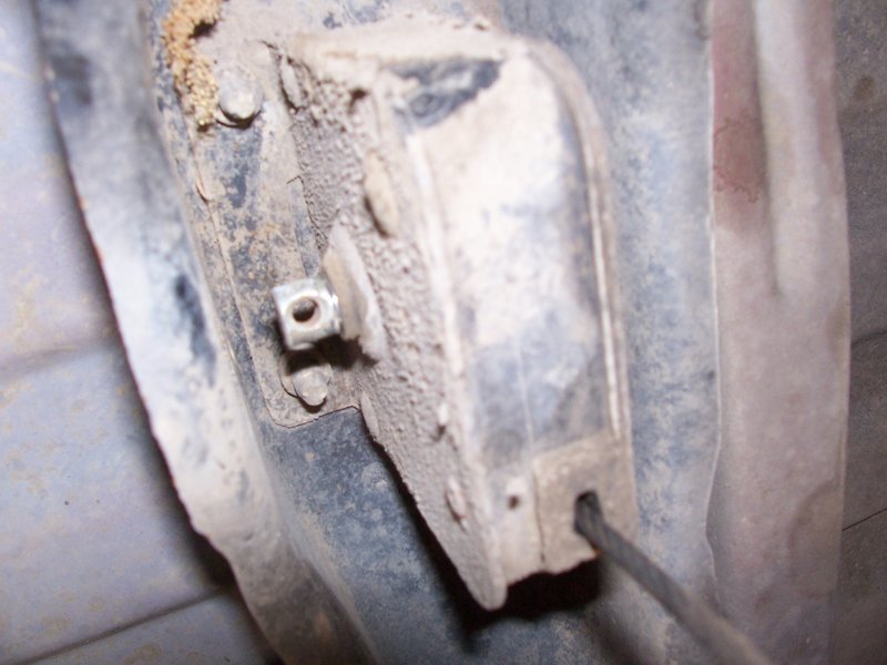

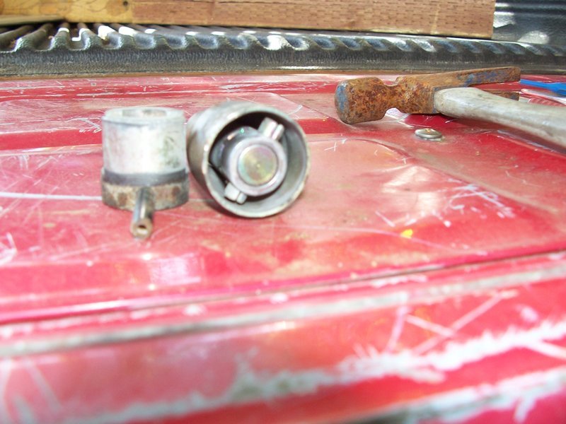

    100_1249 2.jpg 100_1253 2.jpg moving on to other aspects of the build. The spare tire "key" is missing, arn't they all... anyway I took a few pics of what is going on. I tapped the spring pin out and dropped the anti-theft mecahnism off the spare tire winch for clarity purposes. You can easily tap the anti-theft mecanism off while still mounted. When I was reasearchig this there just wasnt a clear enough explanation as to if there are any pitfalls in doing this. Like the saying, a picture is worth a thousand words.

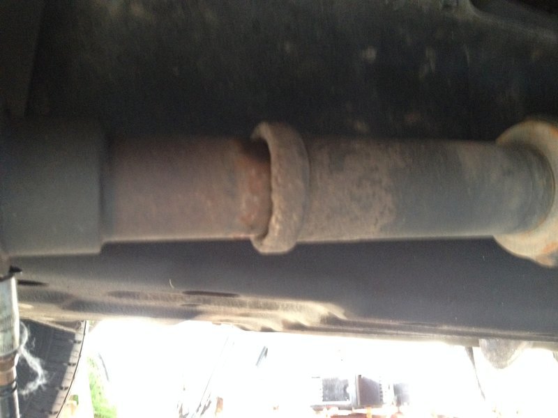

    Both front door handels were broken... Toyota want some $120+ per handle, eek. My aftermarket collison parts place was $17.50 each. I figured for under $40 I would try them... Sure they are aftermarket and you can feel the difference. I installed them and was not happy with how they felt/worked. I could tell that they wouldn't last. While driving her around I noticed a rattle in the DS door. I took the panel off and the rear glass guide rail was broken. The spot welds that hold the upper braket to the rail had pulled through. I figuered that I would take the dooe striker off and see why the handle opperated so hard. There was so much dirt/dust on the moving mechanisms it was binding the thing from working... quick cleaning with a chip brush and some 3 in 1 oil they work just like new. I will have to the the P/S now.
    While driving her I noticed a squeek from the rear leaf spring on the D/S. I will drop the springs and see if the pivots are dry/worn. I also noticed that when I brake and hold the pedal continuosily until she stops that when I take off there is a noticeable clunk from the drive train... I will drop the driveshft and see if there is any wear and if not bad lube the shaft/u-joints.

    as supected... nothing had been lubed in many many years...
    clunk gone.

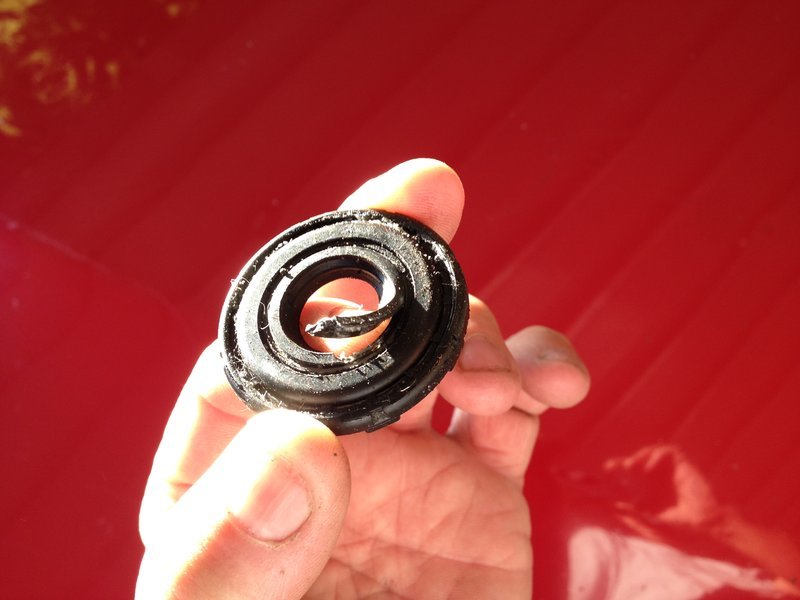

    Found something else wrong. The brake booster would not hold vacuum after the engine was turned off, the brake pedal rose instantly. I refired the engine and squeezed the vacuum line to the booster and the RPM's dropped by 75 rpm. Ok, there is a leak in the booster... eek Toyota wants $500+ for a booster. I purchse a rebuilt one from Oriellys for $180. I take the booster off, it is really easy and the amount of room when it is off is great. I know a guy here in the San Diego area that does nothing but brakes. I call him up and I take the booster(s) and master cylinder to his shop. He immediatly calls the seal in the picture bad. I look at the new booster and there is a seal there. I install the seal on the MC and we test the system. The booster still doesnt hold vacuum. Transfer the MC to the new booster and she is fixed. Steve, the owner at Bush Power Brakes in National City, tells me that it is obvious that someone replaced the MC and just stabbed it into the booster assembly and in doing so, tore the seal. Seen it many times before he says. Learn something new everyday...

    Yep that keeps the vacuum from leaking out between them.
