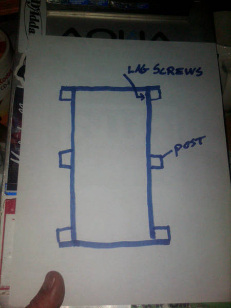

    Con heart redwood, pressure treated 4x4 or 4x6 posts, gopher wire and 3/8 lag screws

    all I have to say , is " not pressure treated " if it's gonna have vegetables in it

    The way I build them has the posts outside the planted area, yes you are right.

    Yes they leach into the soil, I build mine with all the posts outside the planted areas, I'll see if i can dig up some pics

    ACQ has arsenic and copper as it's main ingredients
    Use cedar or redwood posts

    This is the design I use, the posts are all outside the planted areas and set in quickcrete, I've gone 22-24 inches high using 2x10 or 2x12 con heart redwood, extremely tough, long lasting box

    Over time the sides tend to balloon out
