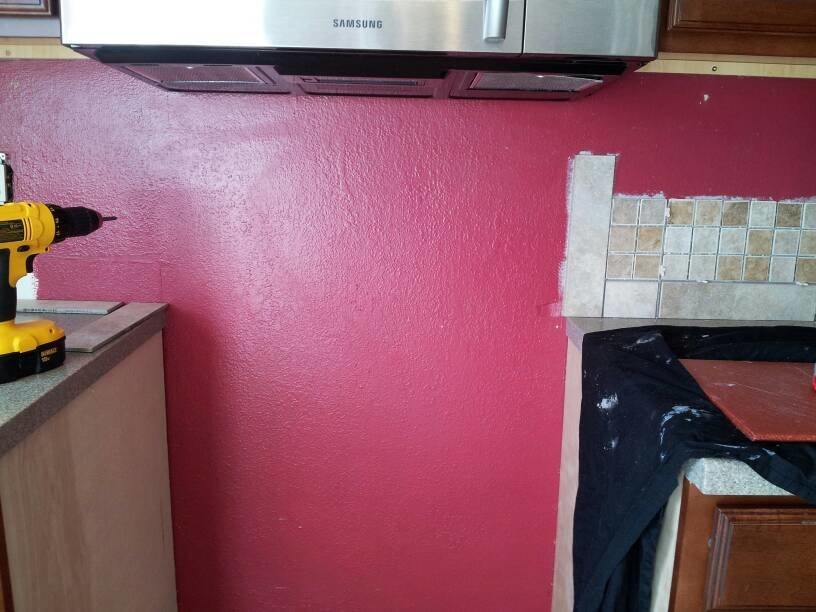

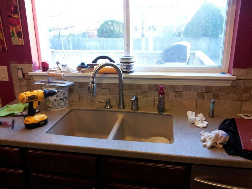

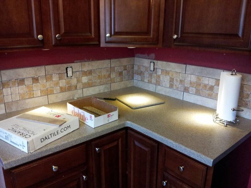

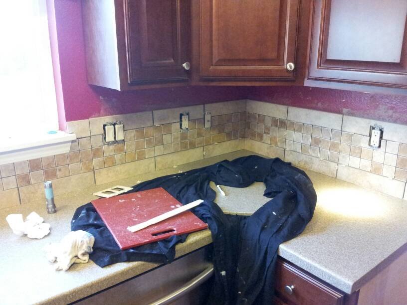

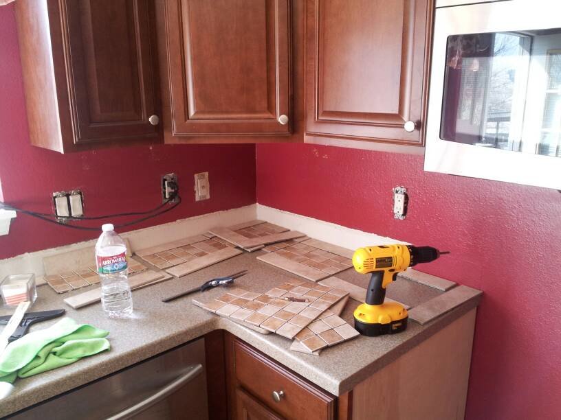

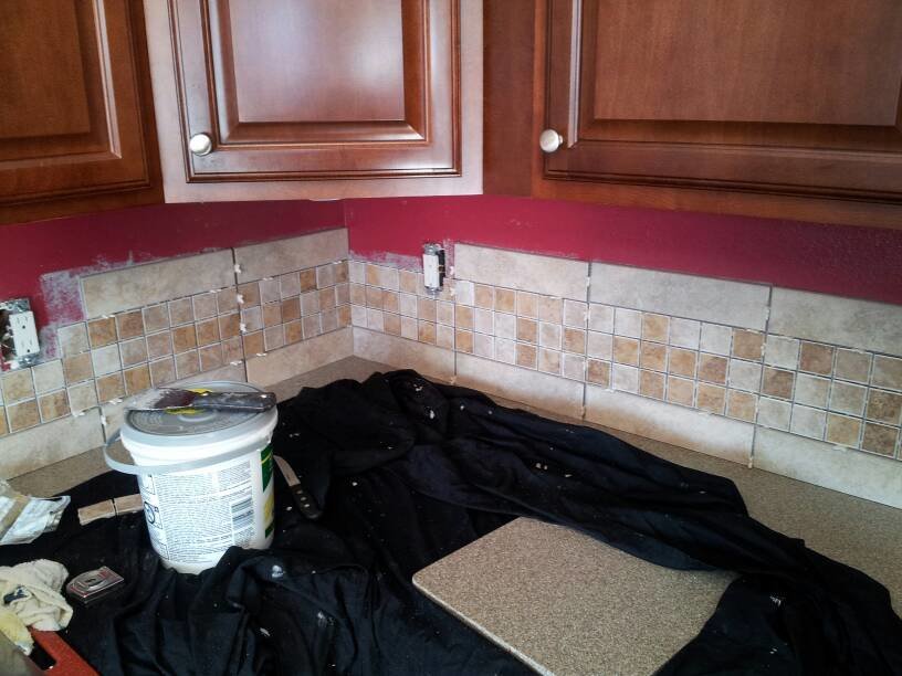

    Just need to finish grout tomorrow.

    Thank you. Took a while since our wet saw isn't that great at cutting the outlets part out

    Thank you both. It was A long day of this... Still bit more to do tomorrow on it, but it was a good time. If we went all the way to the cabinet, we would have had to trim every tile all the way around so we only went up a foot.

    Tomorrow doing the grout will be a lot of fun :rolleyes:. Thankfully it's a 3 day weekend so I can knock it out.

    Remember to mix it up in small batches, :anonymous: makes it a lot easier. I messed that part up and had to move FAST

    I'll admit I bought pre-mixed... May be a bit more expensive, but it will go a bit faster than trying to constantly mix it up.

    looks good... hope you have some tile bits kicking around.
    the screws for the cover plates will bottom out on the tile

    Already test fit them all out and they all work :D. Plus, the covers that go on have really shallow screws and then a cover to seem like there is no screw in it. The only one I don't like is the cover for the cable. Cable is so tight in the wall that it was a pain to put the tile behind it.
