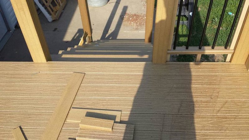

    That's a different way to do the outside corner..

    Is the railings over the deck or in line with the edge of the deck? Hard to tell from the pic

    looks like the outside of the railing is flush to the deck

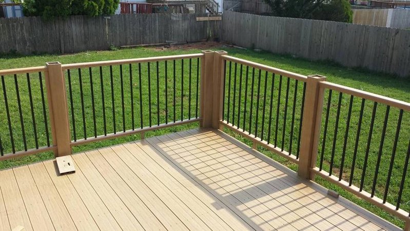

    What's US code for openings in a deck railing ?
    Canadian code is 4" sphere

    We're down to 3 7/8" now. 4" openings will not pass inspection

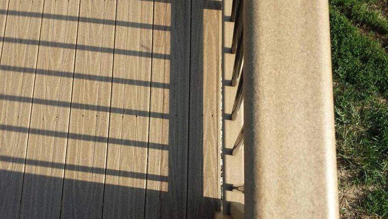

    In line with edge. That was the way the deck was built with a 4x4 on both sides of the stringers. Odd, I know. Going to make it a pain to put the caps on.

    If I did that I would fail inspection.... What's the spacing from the deck to the bottom of the lower railing?

    3". There is a brace you can't see in the railing actually making the gap less. Rail height is 36". spindles are 4" center to center.

    For us, inline railings (like yours) have to be over the decking. To do it the way your deck is we would have to do a cantilevered railing system (pickets extended down and fastened to the rim joists).
