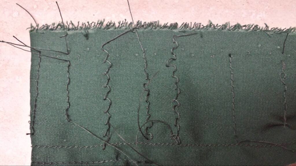

    So Lisa and Susan, I know I have seen you talk about some baby blankets or something a while back, do you know much about trouble shooting sewing machines? We have rewound several bobbins, triple checked that everything is threaded right several times and have been toying with the thread tension to no avail...
    This is the bottom (bobbin) side of the material.
    We keep getting this squiggly stitching although intermittently. This is happening both on the old 1960's machine and the brand spanking new one we bought a few days ago. It will sew great for a while and then it will start doing this and so on...
    I'm debating tightening the bobbin screw since it kind of looks like the bobbin thread is all loose, although maybe it is too high and the thread is getting stretched and then it loosens up like that after the machine passes over. We've played with the upper tension dial a bunch. Sometimes it fixes it sometimes it doesn't...

    when my machine starts that it's usually because it's dirty or I have a stray thread stuck somewhere. Clean the machine, YouTube has some instructional videos if you're not sure.
    Dull needles can cause it too. And have you tried adjusting the tension WHILE YOURE SEWING, not just while it's stationary? Use a scrap of the same fabric and sew and adjust at the same time, maintaining the same speed. Try about an inch, adjust, inch, adjust...do that twice, once increasing the tension and once decreasing. Then look at the results and see if some areas look better, sew/adjust back to that tension setting.

    Thanks. We've tore both machines apart and cleaned them out finding nothing in them. We'll try adjusting the tension on the fly on the new machine and see what comes of it. We've done it on the old one without any luck.
