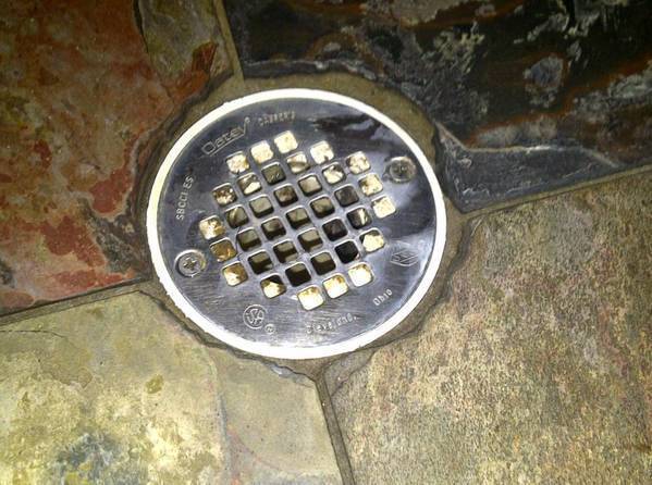

    It would be way easier if he was closer cause we could just fix it.

    That looks like a floor drain to me , as I said , I've never seen a shower drain where you could still see the rough-in pipe .
    Does the shower drain slowly or stink from the drain ?

    Looks like you can unscrew the finished drain cap.
    If you remove that and plug the drain , you could fill the pan with water and you would know if it is bypassing the drain .

    I'm going to say its not right
    ^^ That should be the basic assembly in there.

    Exactly , the two part drains sandwich the EPDM layer into the drain so any water that gets through the grout will still wick into the drain .

    It is a shower drain...Its an Oatey 2 part slab drain

    Says it meant to be used for slab applications where a membrane isn't required

    that is the drain assembly (or similar to) the membrane should wrap over the top of the largest piece there, and then the next piece up clamps the membrane down and tile floor and subfloor should line up to the top, smallest part of the drain.

    who knows man... you never know what do it yourselfers will do

    sounds fucked to me... never heard of not having some sort of protection .

    As I said , I've never seen one like that , but there it is .
    Good find .
    All of our DWV piping out here is ABS , not PVC , maybe that is the difference .
    In any case , I still think you should remove the finish piece , plug the drain and fill the pan , then you can see if the pan holds water .
