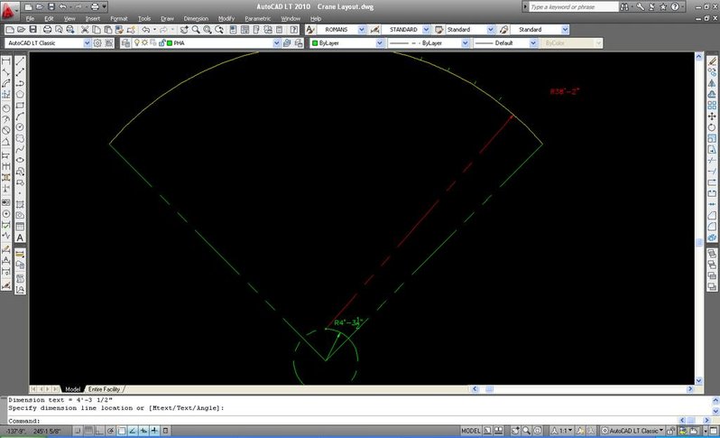

    I need walls with an outside radius of 38'2" and the arc length of the wall needs to be broken into 4'0" segments...and I have to work around doors and windows too.

    BURG, make sure that you're doing A1 != B1 != C1 != D1 != E1 or whatever...cant have a number 2x in the same row if you're doing lotto numbers.

    Wall thickness is what?

    I drew a 38'2"R x 4.5" thick wall segmented into 60 pieces.

    I have to fit a total arc length curved wall of 109.13* in between two walls that come together at a 90* angle (yellow parts) the intersection of these two walls and the center point of my curved wall is not hte same. I only have a total of 105.86* of arc with my current center point - a difference of 3.27* and or roughly 2' at the exterior face of the wall (blue part, interior of wall in pink). I'm hoping that its just the center point that is off.:mad:

    What's the actual arc length supposed to be? Or do you have any other known dimensions? You can't possibly be working off degrees only. There'd be infinite possibilities.

    4' - 3.5" off the corner of the wall at 45°

    No length, only angles and a grid system
