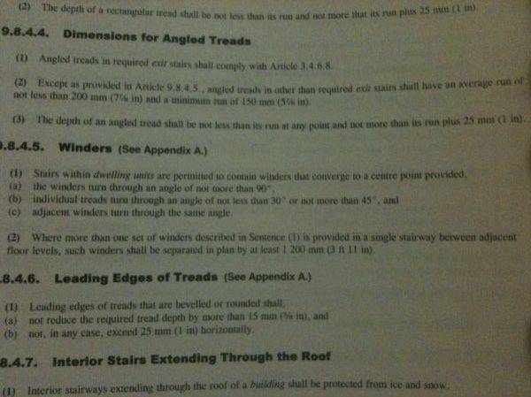

    Did the oz post why me stairs aren't legal in bc?

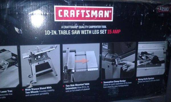

    Cant wait to see what she can do... Krap, i bought an 80 tooth freud blade for my new saw. Better work good:cool:

    nope, I believe it's because you're supposed to have a landing when the stairs make a 90* turn. I remember hearing something aboot that at work a while ago, codes must have changed since your house was built.

    it will cut like a hot knife through butter. Is it rip or cross cut or a combo?

    Ive never seen a house without a landing with a 90* turn or railings...idk???

    From my code book

    worked in a 20 year old house where the stairs go 5 steps, 3 angled steps turning 90*, then another 4 or 5 steps. if you hug the left side going down there is aboot a 30" drop, which is why that's not to code anymore.

    Looks like your good to go to me

    I thought so. Never heard that one about having a landing in a 90* winding set of stairs
