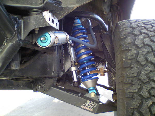

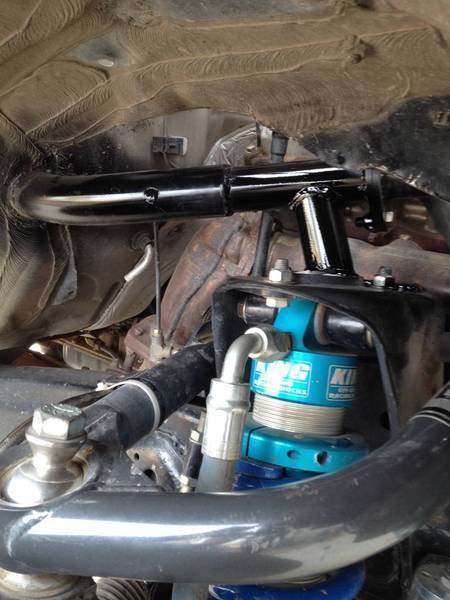

    Camburg Long Travel
    King 2.5 x 8" shocks with a compressed length of 14 3/8"
    King 2.5 x 8" bypass shocks
    Fox 2.0 x 2.5" bumps
    TC spindle gussets
    Glassworks front fenders
    13.5" travel

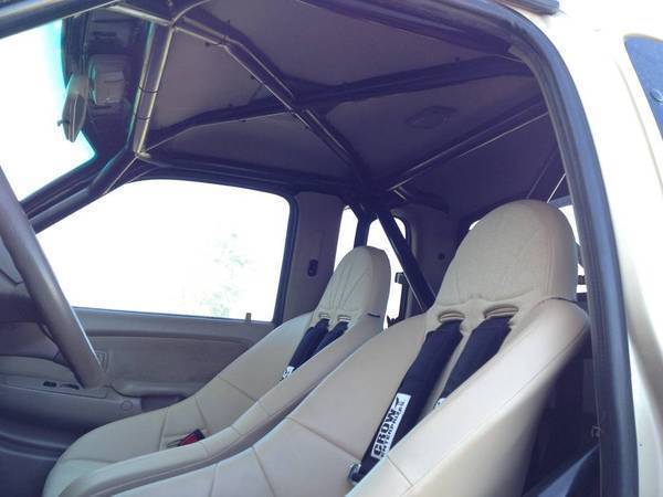

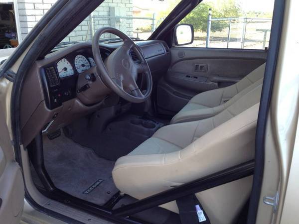

    Twisted Stitch Pro seats
    Crow 5 point harnesses

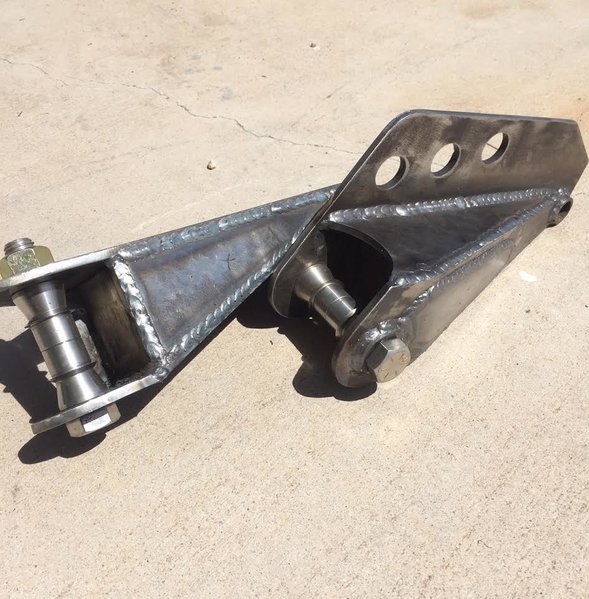

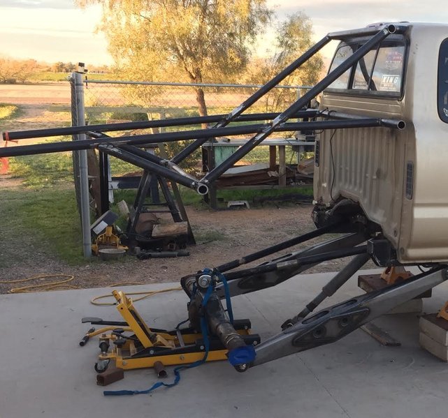

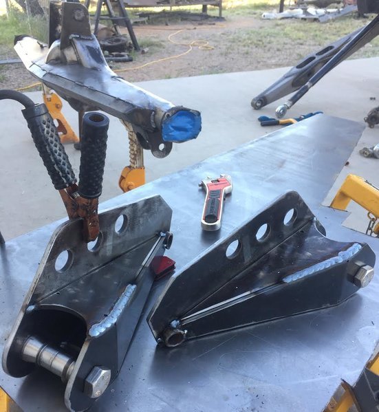

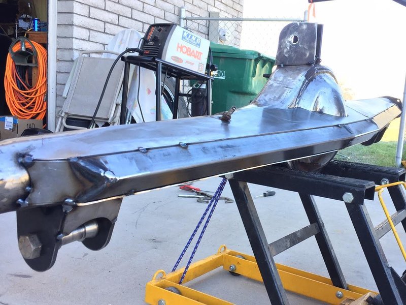

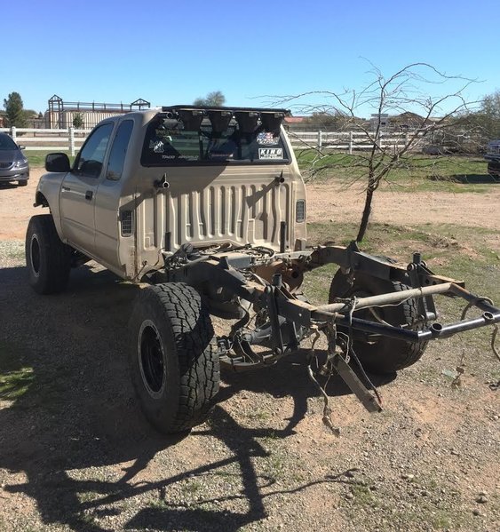

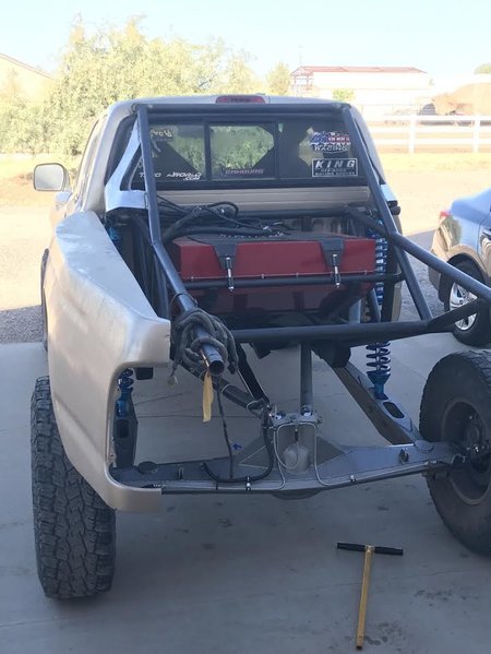

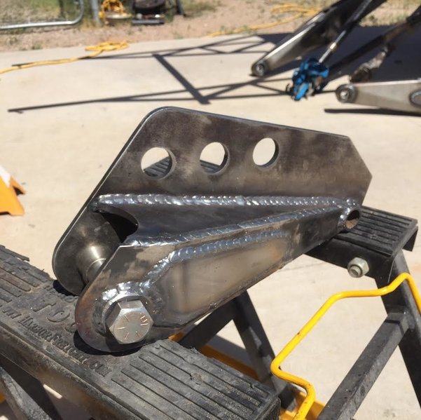

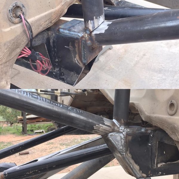

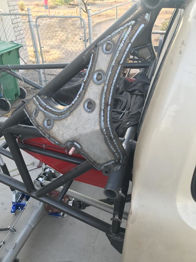

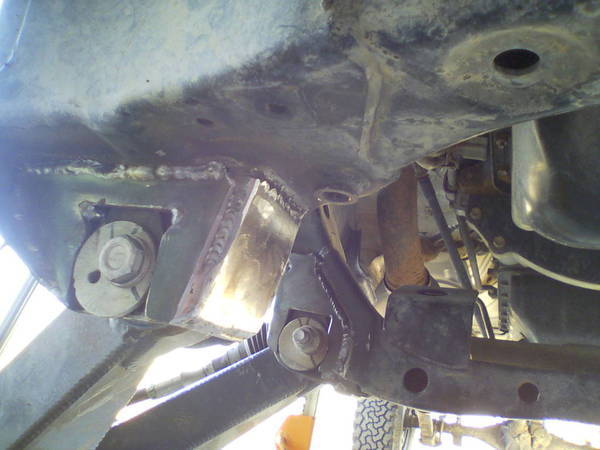

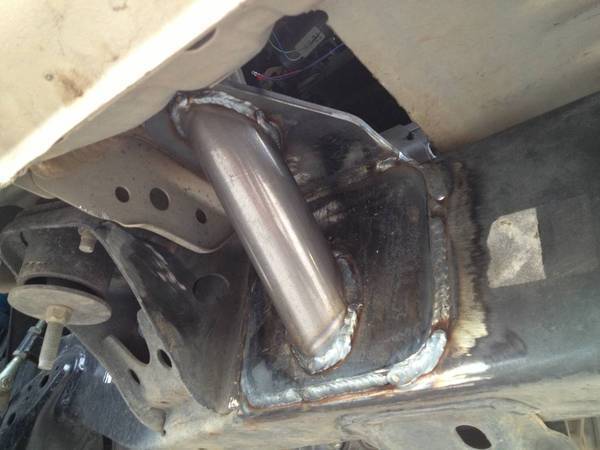

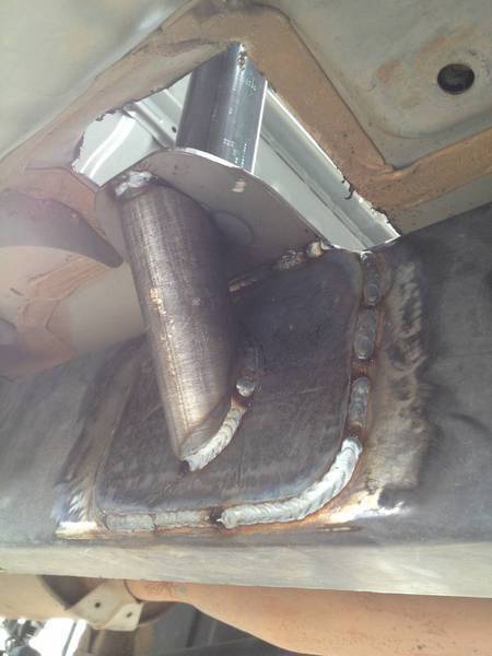

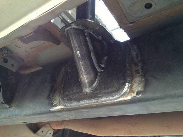

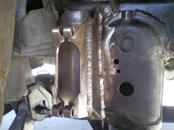

    My fab parts

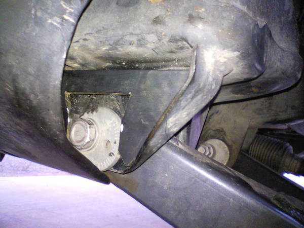

    UCA gussets
    Alignment cam/LCA gussets

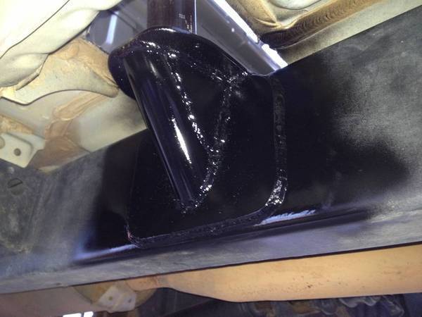

    Outer rear frame plates
    Inner rear frame box plates

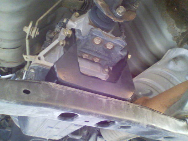

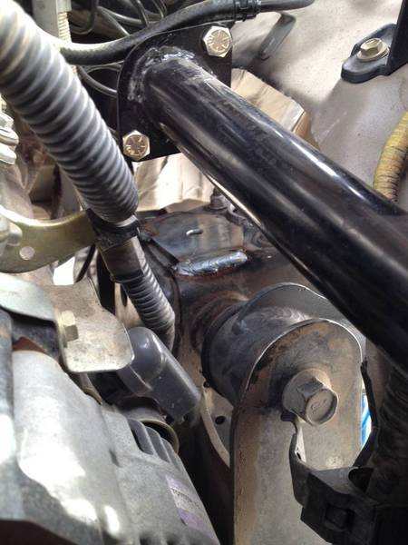

    Motor mount perch gussets
    Solid transmission mount
    Rear shackles
    Front spring hangers
    Lower rear shock mounts

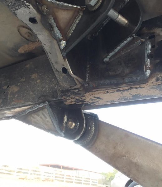

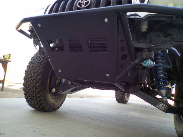

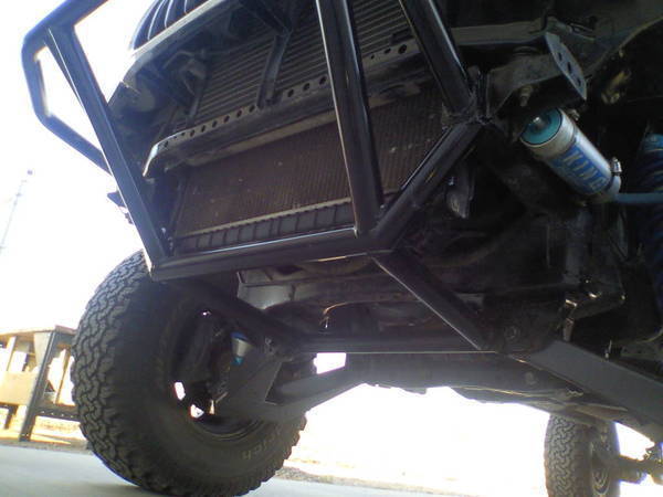

    Front bumper/skid plates

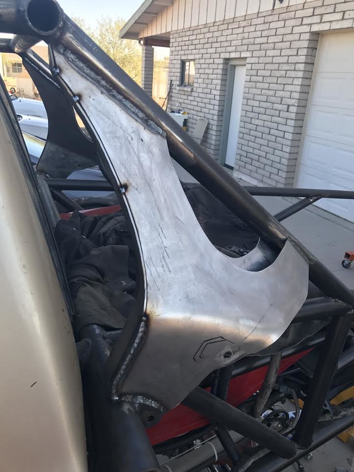

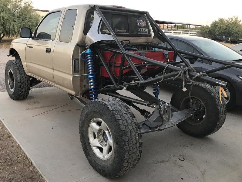

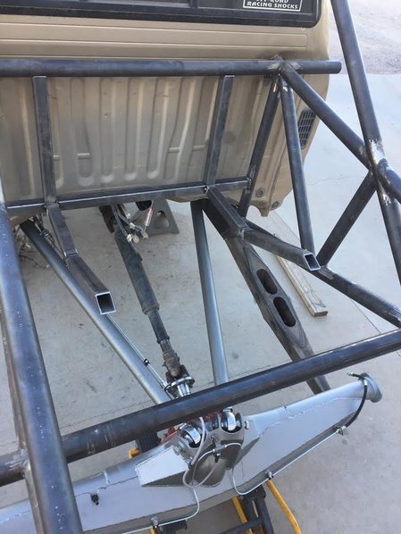

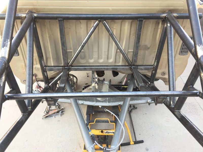

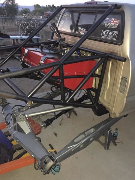

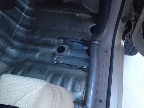

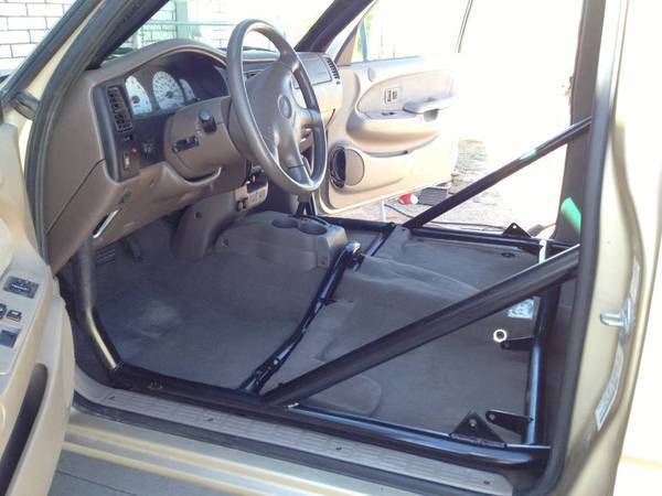

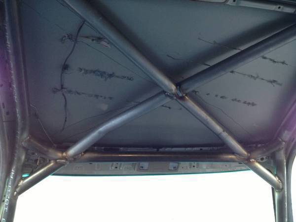

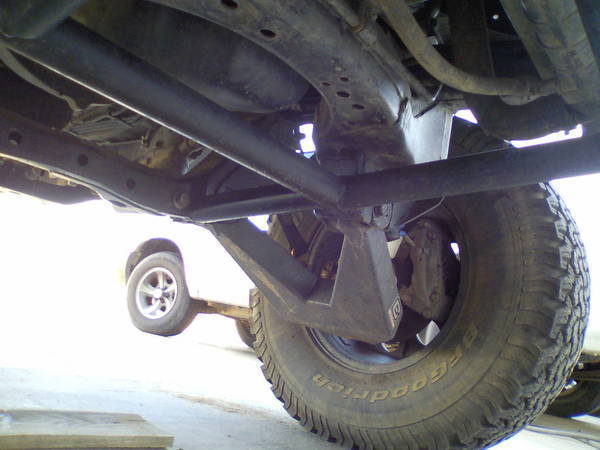

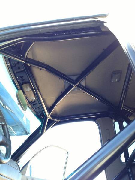

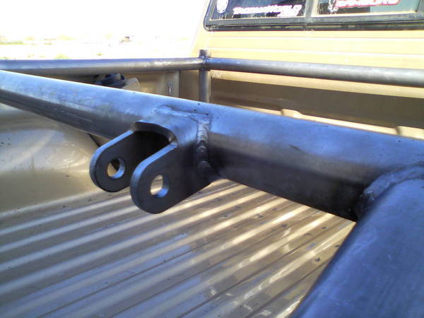

    Full roll cage, engine cage, bed cage, tied front to rear 1.75" DOM

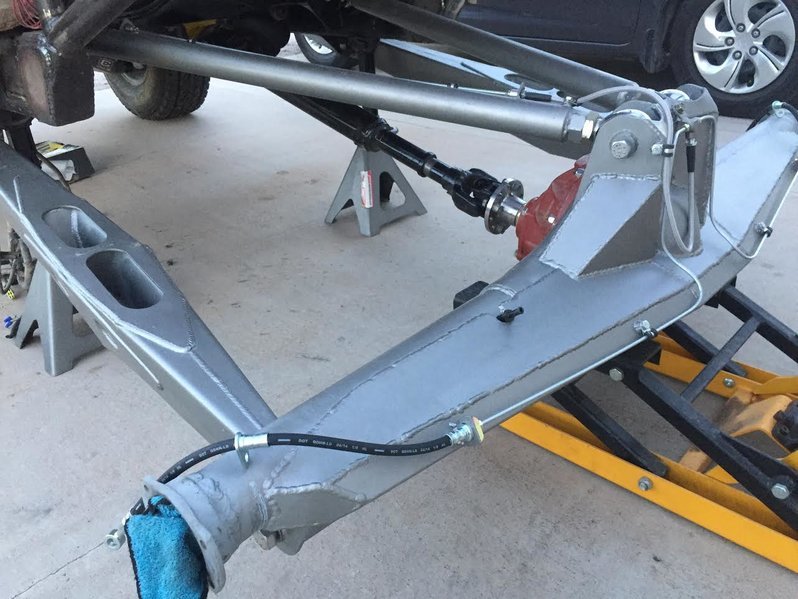

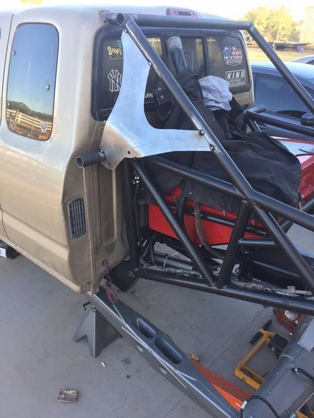

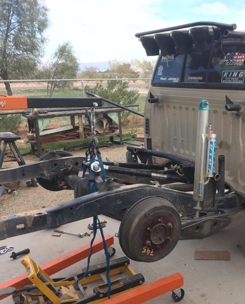

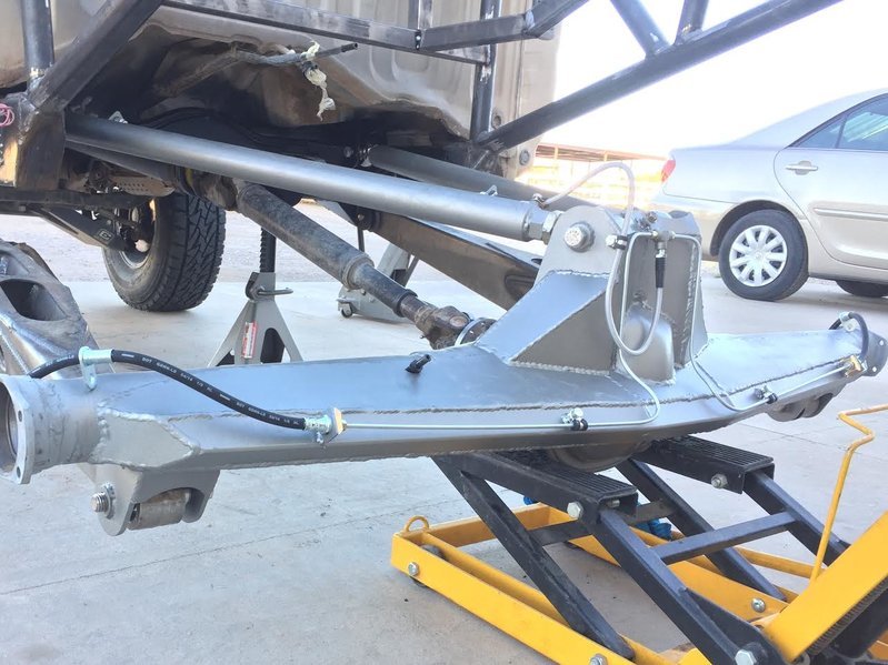

    Back half - removed frame behind cab and fully fabricated 4 link rear
    From day one

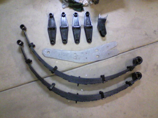

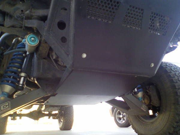

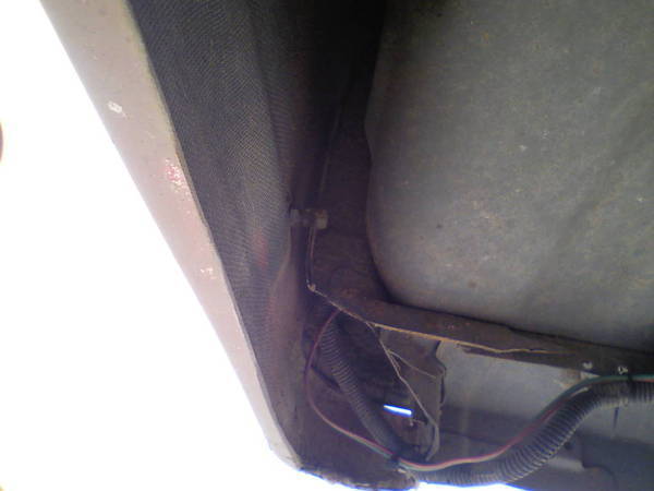

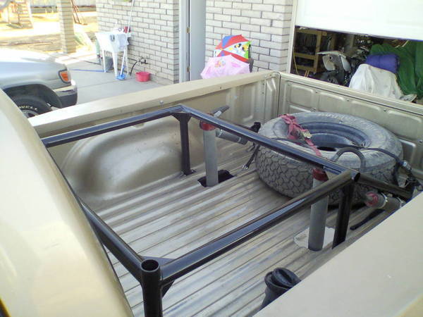

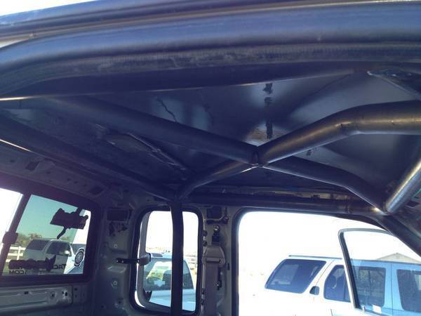

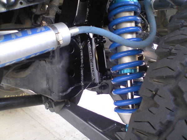

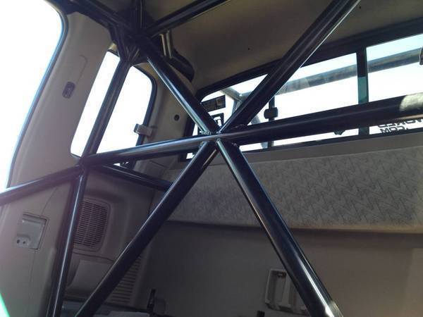

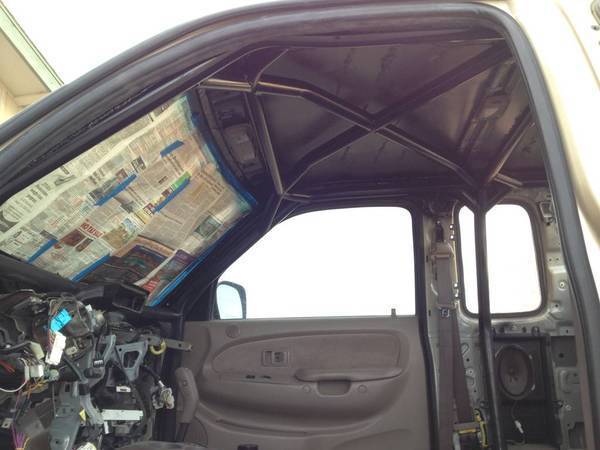

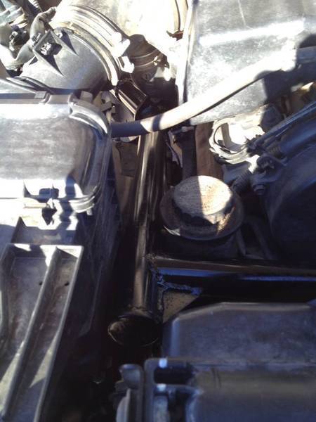

    [​IMG][​IMG][​IMG]
    [​IMG][​IMG][​IMG]
    [​IMG][​IMG]

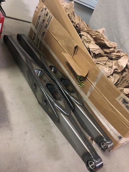

    Four link

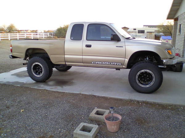

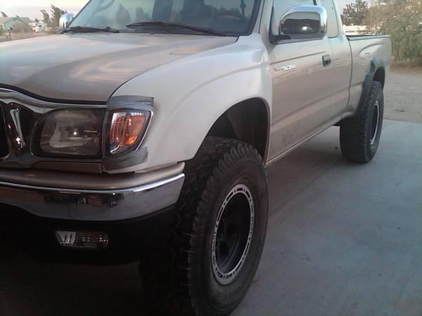

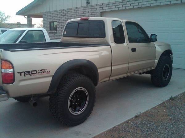

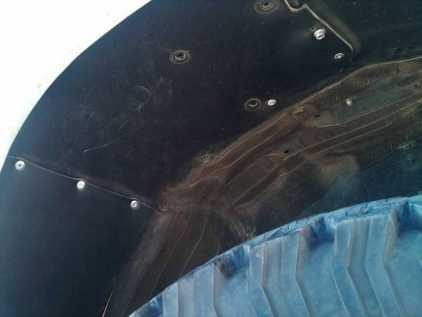

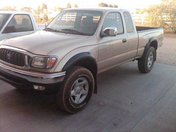

    First weekend I blew out a shock lol. Need long travel ASAP! Lol

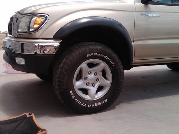

    I added new wheels/tires and front fiberglass

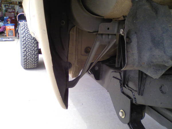

    Oh yeah I also had to make an inner fender out of all my old mudflaps to keep sand out of my air intake when I went to Glamis

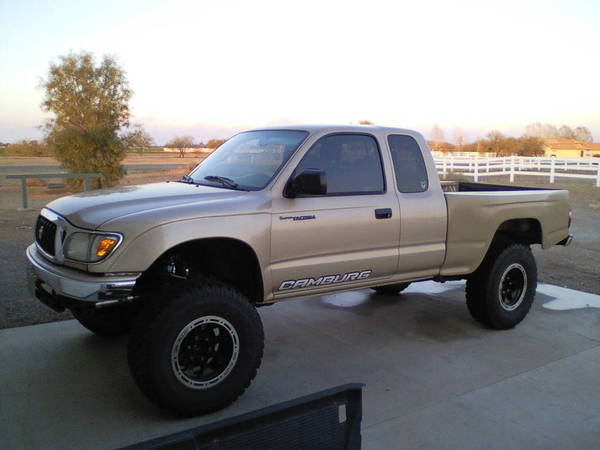

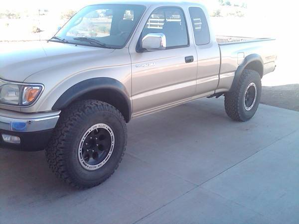

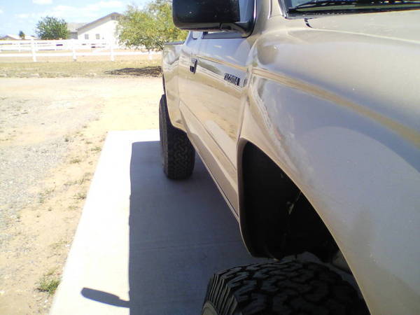

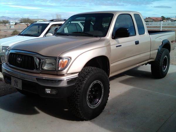

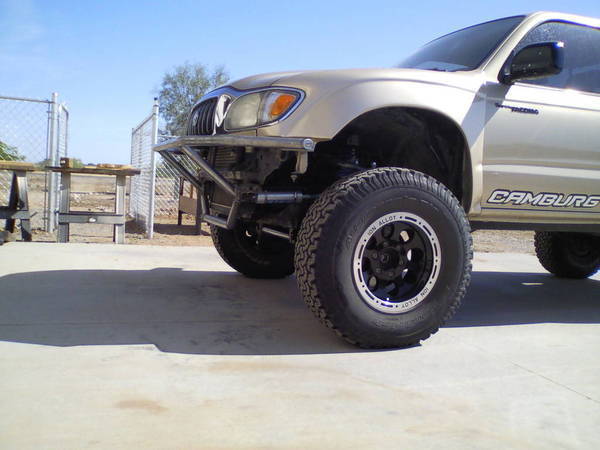

    Painted my front fenders (free from a buddy and painted in my back yard!) and blacked out badges and mirrors. More photos added

    Looks good, what back space are those rims?
  8. Dec 20, 2010 at 12:43 PM
    Cr250jumper
    Cr250jumper [OP] Señor member
    Dec 2, 2010
    #47033
    11,968
    The moon
    50 shades of tan©
    Tacoma with some stuff melted to it
    They are about 4". They are the ION alloy 174's. The webcite says they have -5mm of offset so pretty much in the center of the wheels

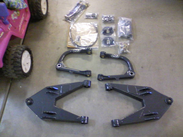

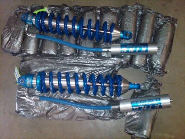

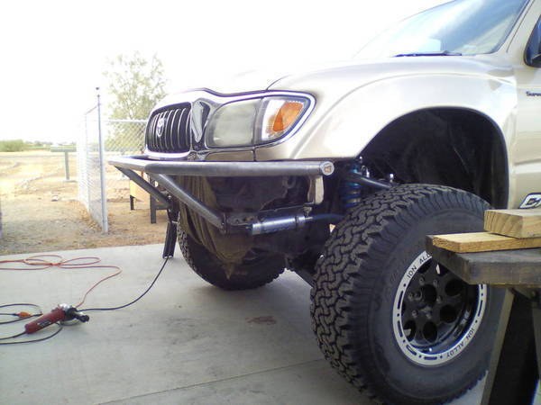

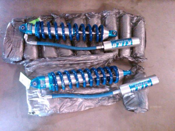

    I got my Kings today. I should be getting the Camburg LT in about 2 weeks :)

    Ordered my kit yesterday. Should be here in a week or two :D

    they have 2 different kits for your truck, which one did you go with?

    Its just the long travel one. Not the full race kit

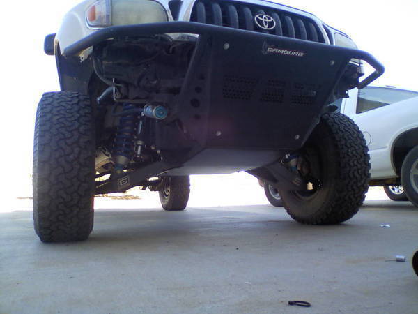

    The day for install is finally here :D

    for my intake i use panty hose to put over it for the dunes and when i go in the desert.... i think im going to do the mudflap mod like you haha.... very smart!
