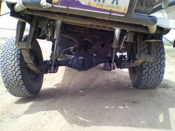

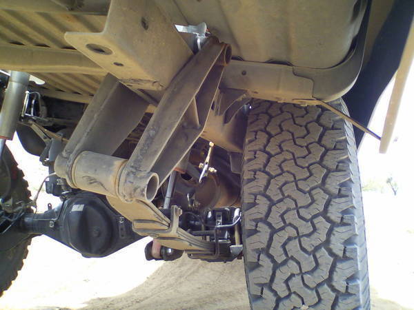

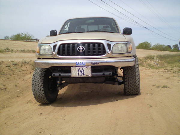

    Flexing in a little ditch by my house

    Right on :thumbsup:
    Looks like the shackle might be rubbing the frame a tad when flexed out :notsure:

    Yeah they are on both sides, the tire is too. I need some wheel spacers. The upper hangers are the bushing kit from Ruff Stuff and they are kinda soft. But they were only $16 each, they have a zirk, and they dont squeak lol

    Oh, can you gusset/strengthen them in some way?
    That's always a plus :cool:

    Just a random thought, but my tire was 1/16" from the frame so that wasnt keeping it from flexing more. But if I did have a wheel spacer, and it moves the wheel out, wouldnt it have a little more leverage and flex a little more?

    The hanger is .250 wall so its not moving. Its the rubber inside thats letting the bolt sleeve twist sideways in the tube. Ill def get harder (delrin?) ones when I switch them out, but I only want hard ones on the shackle hanger, not in the spring

    It shouldn't flex any more (very slight if it does), but the distance/wheel travel will increase (in the flexing respect) slightly from the longer distance due to the wheel spacer, if that makes sense :notsure:
